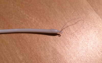

Re: E3D Release New Version 6 of HotEnd.
Posted: Wed Jul 02, 2014 3:26 am
by artexmg
Well, as I mentioned in a previous post, I had being troubled switching filaments using E3D V6, as, for some reason, the filament bulges more than with V5. Then it is very difficult (if not impossible) to make it goes trough the little hole in the EZ-Extruder.
You can see that I got something similar to what Jesse got.
This is not good! :-)

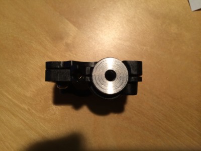

So, I decided to bore the EZ-Extruder (I remember mhackney mentioned this in other post) to make allow the bowden tube go through all the way up to the hobbed drive roller. See the pics
Bore increased to ~ 4.3mm diameter

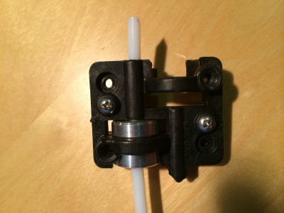

Bowden tube goes through (using the 3mm "channel")
Tip shaped accordingly
So far, it is working great :-)

How do you keep the bowden tube in the bored out EZ without the PTC piece that holds it up there? Do you use a pass through PTC fitting to keep it in the EZ?

The pictures I posted are not complete, tonight (I am at work at this moment) I will post the final process. But yes, I passed through PTC.
Posted: Thu Aug 21, 2014 9:12 pm
by mhackney
I actually made a new bowden adapter (the aluminum part) that is bored through and tapped so I could use the PTC that came with the E3D hot end. That PTC is specially made to pass the bowden tube straight through.
