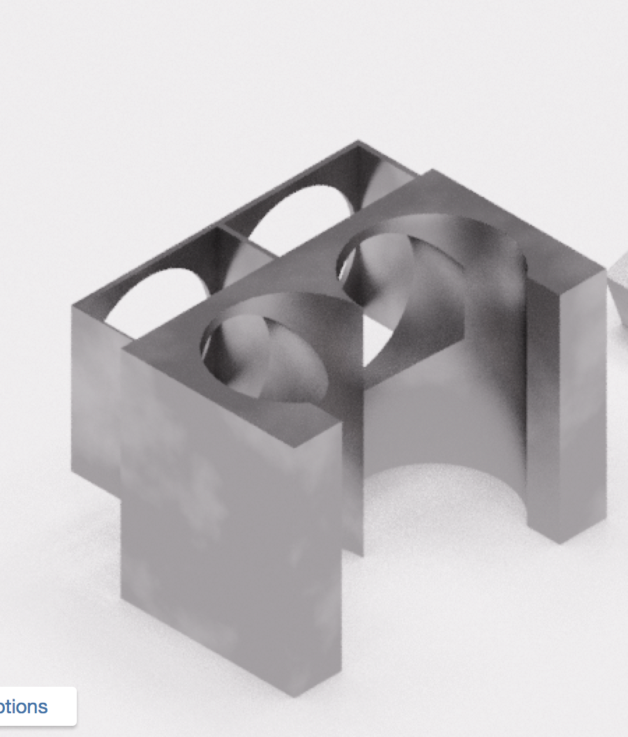

atoff wrote:Thanks. :) I was thinking about going with a printed fan shroud, that would give a me a way to also attach a layer fan, as I'd be able to design the layer fan into the sides of the shroud, but still thinking about it. I keep changing the design, but the one I have now seems like it's going to work best for making small adjustments. Also, the left side of the lower part is going to be filled in, that indent / degrade is unnecessary and will just make it more difficult to print, it was just done during the initial sketching.
You mean something like my design? :-)
I liked the idea of not using screws to fix the fans.
I started working on this, but the found lorenolepi (http://www.thingiverse.com/thing:219945) and dpmacri (http://www.thingiverse.com/thing:217662), Bubbasnow (http://www.thingiverse.com/thing:278076) versions, so I stopped right there :-)
The shrouds are for small, 5mmx5mm fan, so the total volume was smaller than with stock fans.
Just disregard the rendering in (I think) was aluminum.

Interesting, interesting... so from what I can tell it splits the airflow rather than dedicate a fan for the layers? The only problem I see is that you wouldn't be able to disable it for ABS or similar filaments. I had a different design in mind that would basically attach a blower fan to the side.
I'm nearly done with this thing... the only problem, and I guess it's not really a "problem," is that I have to increase the thickness of that top section in order to fit captive nuts. Otherwise, it's going to have huge overhangs that would be difficult to print. So, just need to do that and make some holes for the screws.
The one nozzle is going to be height adjustable, 1mm up, and a couple of mm's down. 1mm is plenty I think.

atoff wrote:Interesting, interesting... so from what I can tell it splits the airflow rather than dedicate a fan for the layers? The only problem I see is that you wouldn't be able to disable it for ABS or similar filaments. I had a different design in mind that would basically attach a blower fan to the side.
[img]http://i.imgur.com/gea8hAh.jpg[/img]
Well, actually both fans are for the heatsinks only. The intention is to slide the fans into the "sleeves".
For the layers I am designing (some day I will finish it :-) ) a squirrel cage blower attached not to the end effector, but to the top of the printer; then, conduct the airflow trhough a tube and distribute it at the nozzle level. In a way, mimicking the idea of a Bowen extruder by separating the device in two parts, reducing mass. Something similar to what is in the picture.
No my original idea, though.
I guess that, stretching the idea further, it would be possible to have only one squirrel fan and a mechanism to divert the airflow to heatsink and layers, and the option to block the flow to the layer, for ABS. I need vacations to start designing ! :-)

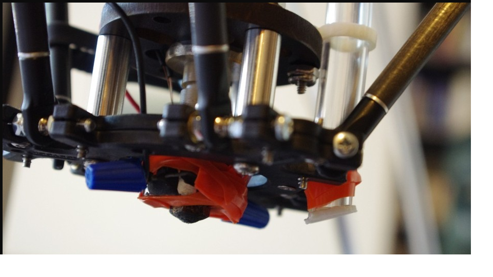

Still working on this... yesterday I printed out the 3 pieces in ABS, and they all fit. I haven't tried mounting it yet, as I'm trying to print everything I can before I do so. I also just modeled out a fan shroud, I want to build a layer fan into it... but I'm wondering, is it a bit much? It looks huge. These are based on the fans that came with the E3D's. I could go with one fan, but I don't know if one fan would be sufficient when ramping up temps for something like PC.
[img]http://i.imgur.com/dyFBhE7.jpg[/img]
[img]http://i.imgur.com/m7Ry0dB.jpg[/img]

The parts are pretty much finished, I've already printed them out, I just haven't been able to test mount it, since I've needed to print a few more things for it. I'm running the wiring tomorrow, so hopefully I'll be able to test it all in the next couple of days.
