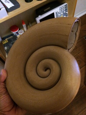

Well, I had been busy with other projects, but, I made room to stain this baby ... it is getting there!
Tomorrow, after all is dry, probably will need a second coat, then, electronics ... cannot wait to listen the speakers!

By the way, I switched the stain product.
I used Minwax Pre-stain (after sanding) and MinWax Wood Finish. All oil based.
It worked great, just took like 2 days to dry, as the plastic does not absorb like real wood, plus, I am among those who thing that, if a little thing of something is good, then a humongous amount is better, so I poured stain like rain in the forest :-)
