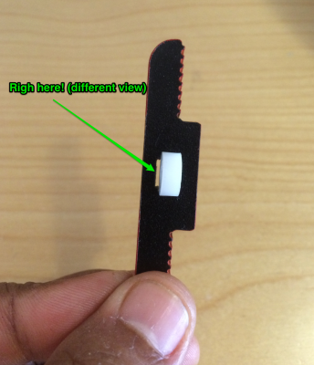

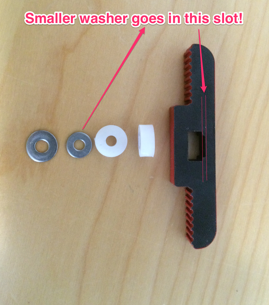

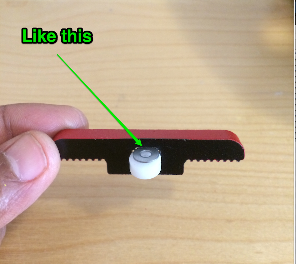

It took me a while to realize that there is a small washer and a bigger one. You have to use the smaller otherwise, the piece will not fit together (duh!), look
This is where the small washer should be

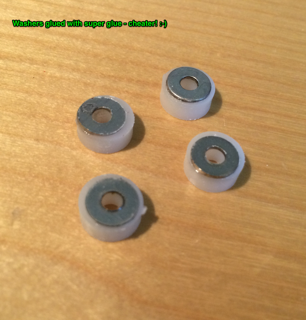

I just super glued the washer for 'easiness'
super glue is the key

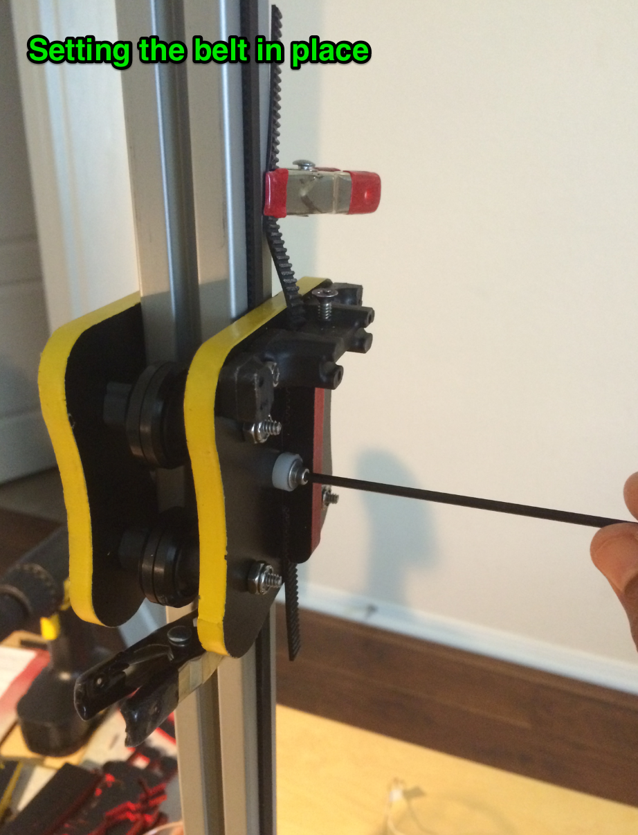

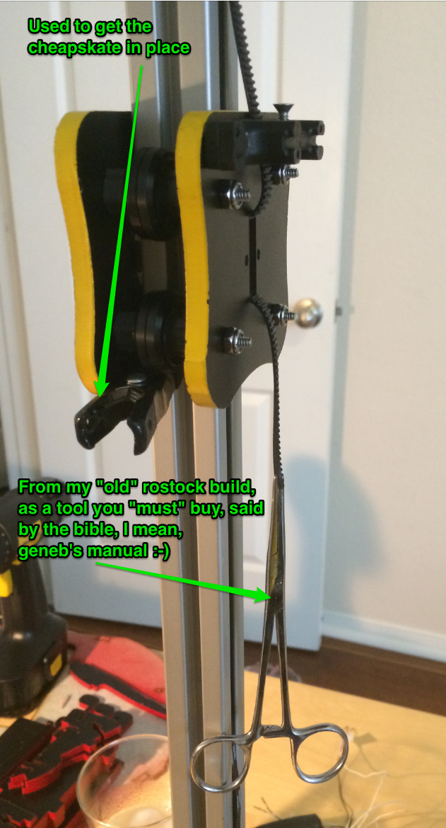

Then, I put set the belts. I used pliers to get the cheapskates leveled and the belt fixed
Being creative :-)
Being creative :-)
With belts in place
With belts in place

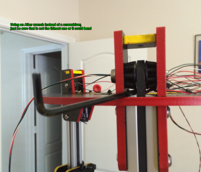

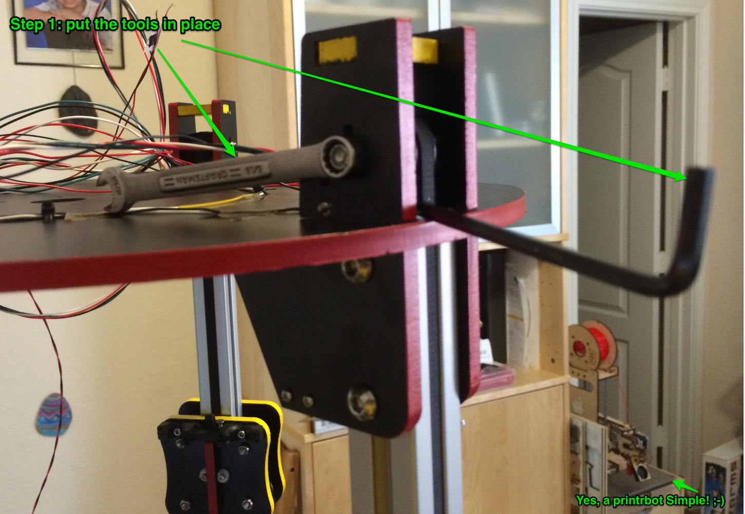

In this episode, tightening the belts.

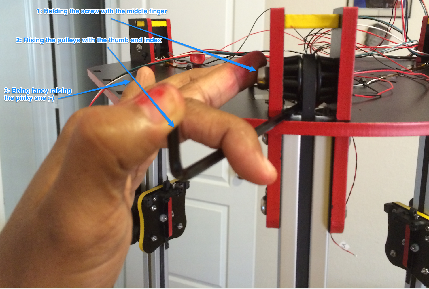

Hey Geneb, I have my own routine for "tuning" the belts without using my mouth at all and feeling awkward :-) Look!
Set the lever
Set the lever
then
place the wrench
place the wrench
Now, with a single hand you can hold everything together ... the form is very important, your hand should looks very fancy or it might not work! (hahaha)
Once you got the pulley in the place you want, you can use your other hand to tight the screw. Sorry there is not picture, but I used my hand to tighten the screw.
Done!
Next step, the extruder (cool end), with a mod ... stay tuned!

The "smaller" washer is a #4 flat washer - just like I specified at the top of Chapter 11. :)

geneb wrote:The "smaller" washer is a #4 flat washer - just like I specified at the top of Chapter 11. :)
I only recon Small, Medium and Large! :-)
Maybe XL?
hahahahaha ... yup, you right.
