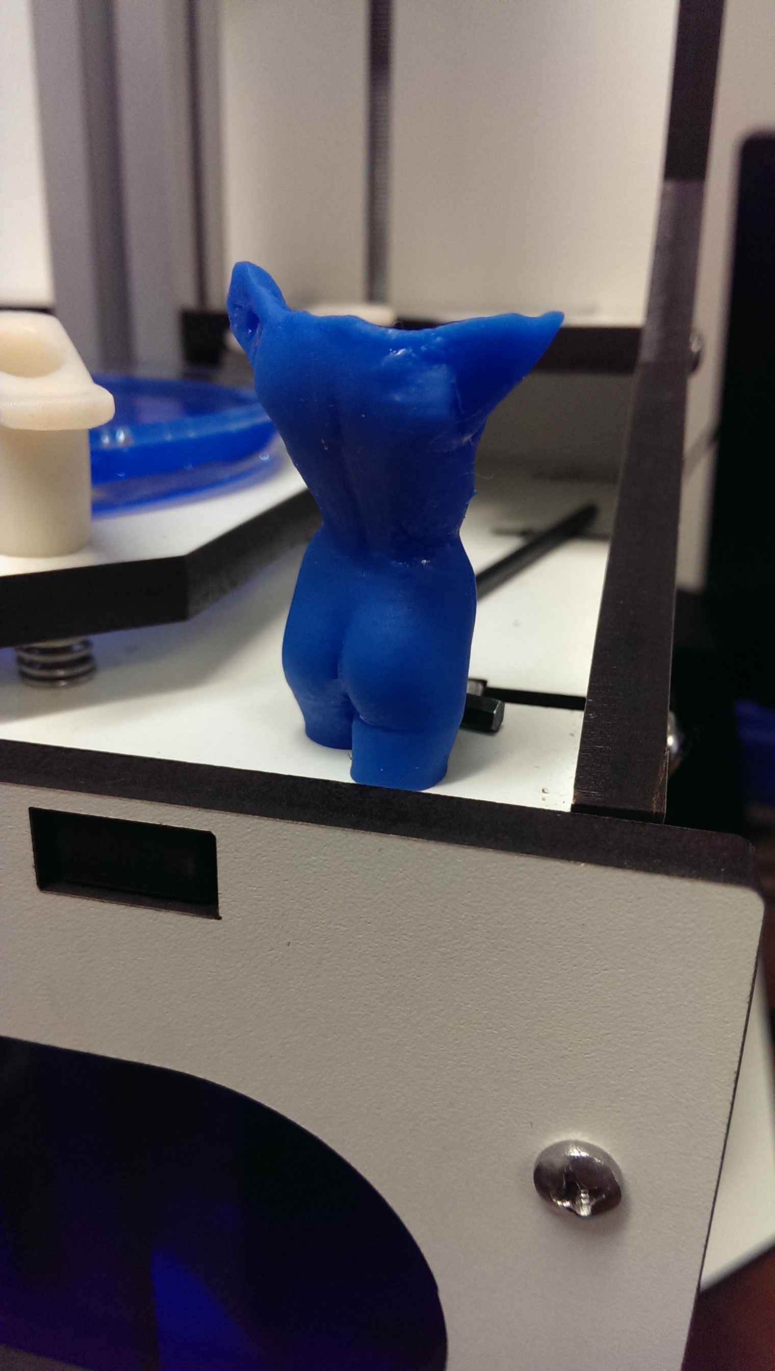

First couple prints of the day off the second prototype, almost ready to go!

Have one request and two questions:
1) Please post more pics of printed parts.
2) when? how much?
still waiting for my Rostock Max (stucking in customs, and that drives me crazy!), but I guess my next project (and money) goes to seemecnc as well
