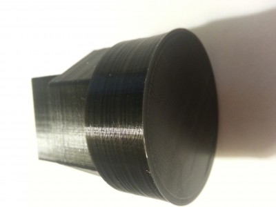

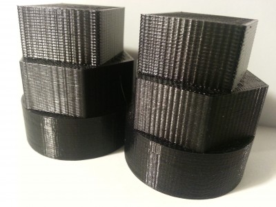

Was there something wrong with the original steppers and smoothieboard? Or did you just want to use better ones?
Re: Rostock Max Smoothieboard Tutorial
Posted: Fri Sep 04, 2015 10:52 pm
by KAS
There is some weird vertical banding going on with multiple 3d printers. Few of us were trying different things trying to see if we could figure it out. I changed to 400/rev steppers and smaller pulleys to gain higher resolution. The upgrade to Smoothie, was just something else to try.
I went from this
to this (this was on the Rambo, The Smoothieboard didn't provide any noticeable benefit)
Posted: Sun Sep 06, 2015 2:22 am
by Fiddler2070
KAS wrote:There is some weird vertical banding going on with multiple 3d printers. Few of us were trying different things trying to see if we could figure it out. I changed to 400/rev steppers and smaller pulleys to gain higher resolution. The upgrade to Smoothie, was just something else to try.
I went from this
Wow. Those are some nice prints. What were your slice settings? nozzle? Hotend type? layer size (0.1)?
Posted: Sun Sep 06, 2015 2:26 pm
by KAS
I went from this
Absolutely no idea, I think those are printed at .20 layers but temp is dependent on the filament. I know it was PLA.
This was the thread and also included that test model, few pages into the thread.
http://forum.seemecnc.com/viewtopic.php ... ing#p61694
