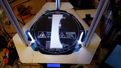

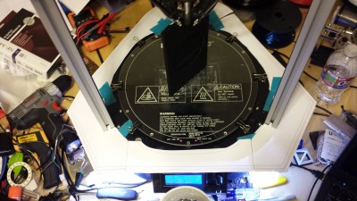

Well it was a really long night of CAD work.. But I knocked out a few things and among them was the lower part of my full build area enclosure. I just have to print the beta prototypes later today and get the final fittings worked out. Will have Arduino controlled full temp and humidity controls.
A pattern fit of the new full build area enclosure. temp and humidity controls soon to come.
Sorry for the mess in the shot. I am still setting up the printer how I want to and printing off parts. This shot has the side ventilation panel that just finished as I was fitting the enclosure pattern to double check everything.

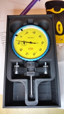

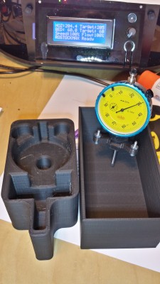

OK a few updates...
I threw together a nice new home for my new best friend in CAD the other night.
Box and insert for calibration dial.
All nice and happy in a safe new home. That old cardboard box HAD to go.

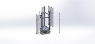

Progress has been made on the enclosure. Render is not complete but the deisgn is almost finished. Will be printing the lower platform pieces this weekend.
More to come soon!

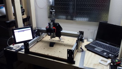

This is what has been keeping my away so much. New CNC mill arrived at last!
Hey Guys,
Sorry i have been away so much of late. A few days ago the CNC mill arrived and I have been working like mad to build a new work station for it, shoot a ton of photo shoots for work and get the CNC mill put together. The Rostock has been printing doing the very thing I bought it for, printing things for the CNC. I've been keep the Rostock busy with all sorts of items for the CNC mill set up. I've printed a TON of drag chain and Misc parts for limit switches and such. I have the CNC finished up by this weekend for the Geek Gathering here in Houston. I will be away a bit more while I finish this up.
On a good note though... All this printing has really made me understand even more about using my printer and how I need to change a few things on the enclosure. I even solved a nagging issue I had the other day while at the store picking up CNC supplies. I've found the way to join the sections of the enclosure which I like and can be easily done by others. I just got in a few new rolls of black PLA today so I can get back to printing the BETA pieces and run the last few tests before I print the whole thing.
Catch everyone in a few days.
