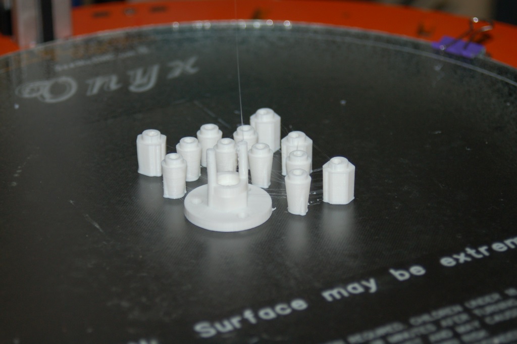

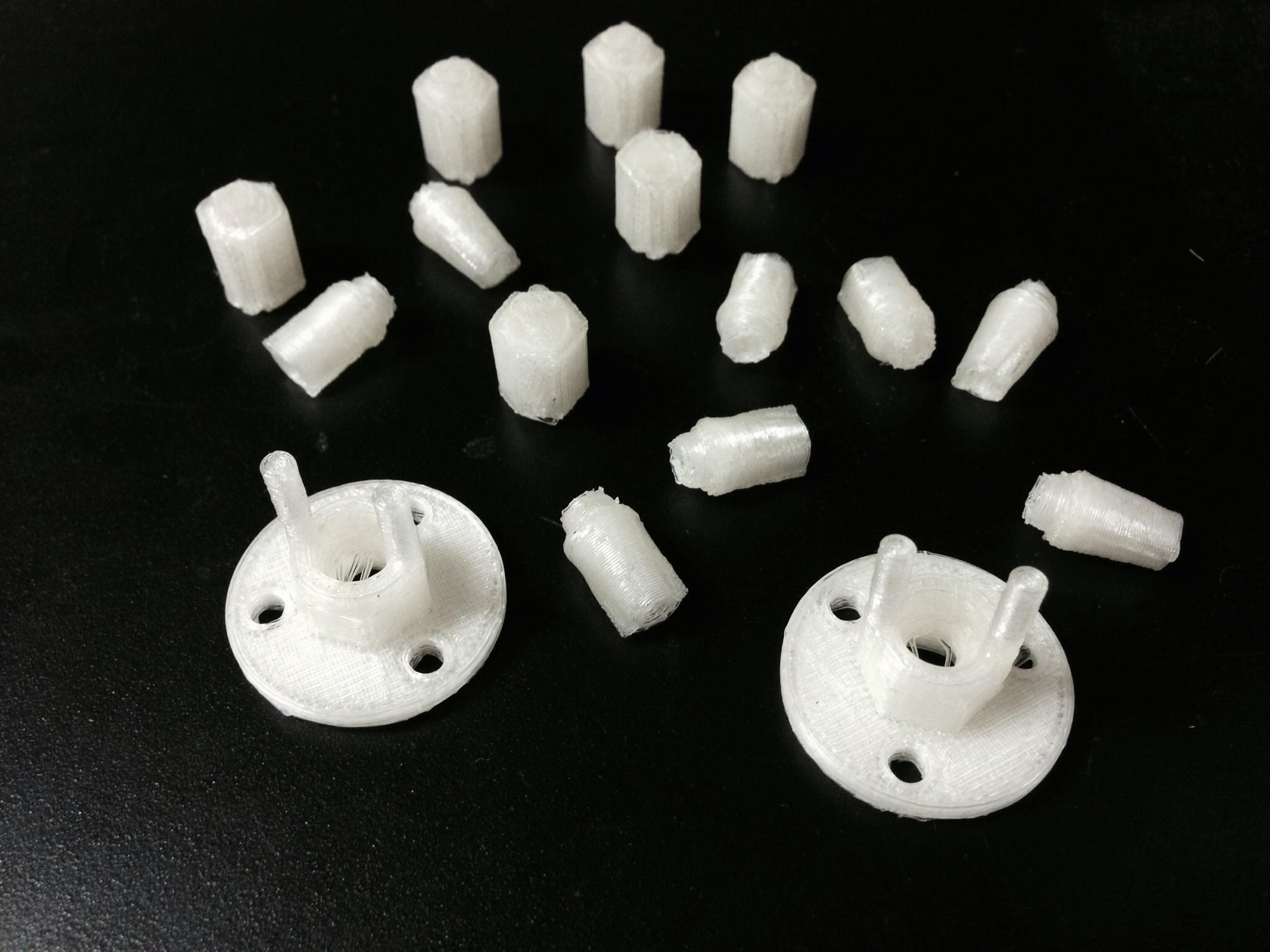

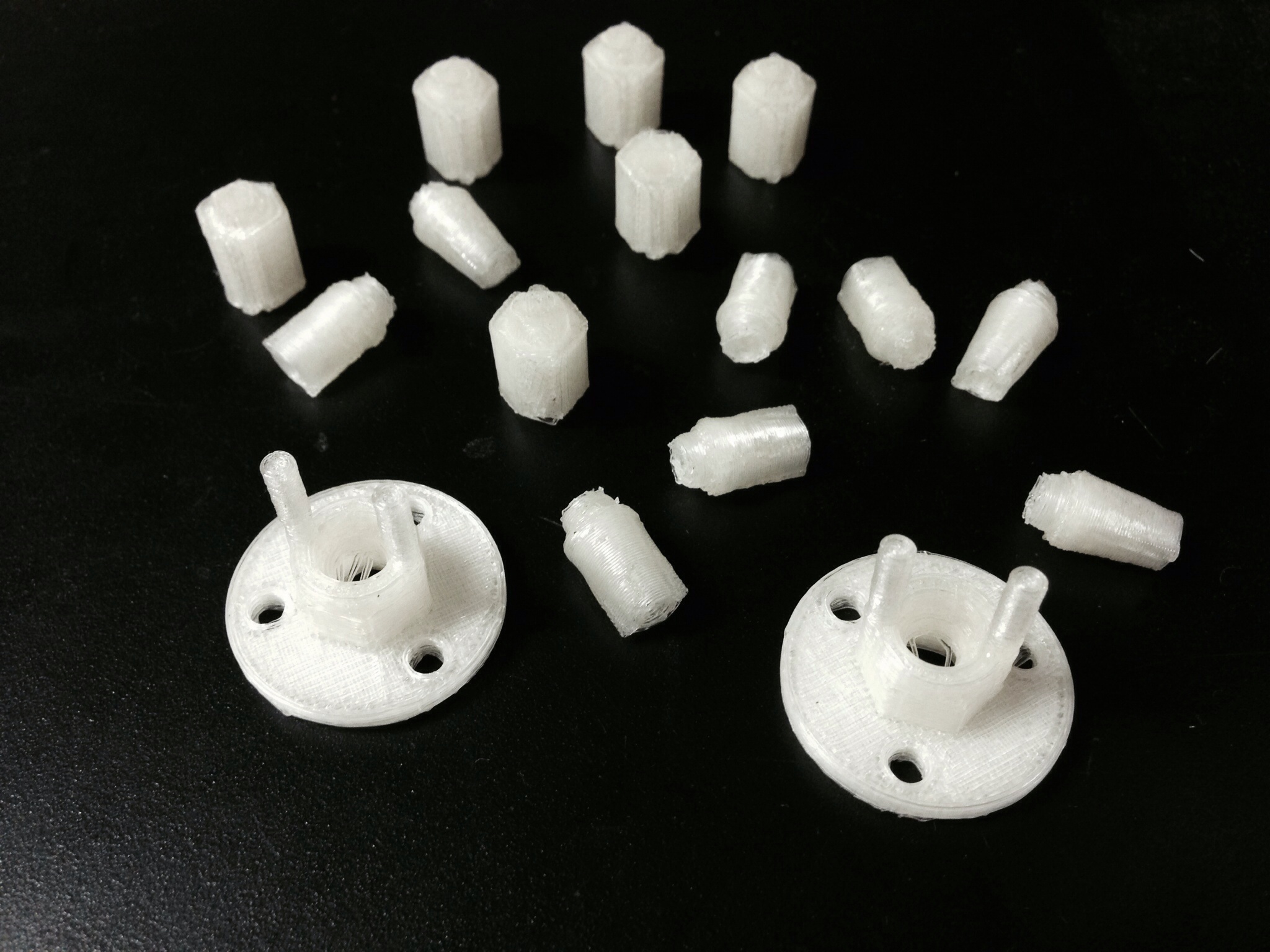

Ready to go!
Re: BETA testers discussion
Hot off Orange Menace:
We all seem to be printing them in white!

I printed mine in blue! (of course)
Guanu
White is what I had loaded. :)
Yeah, me too.

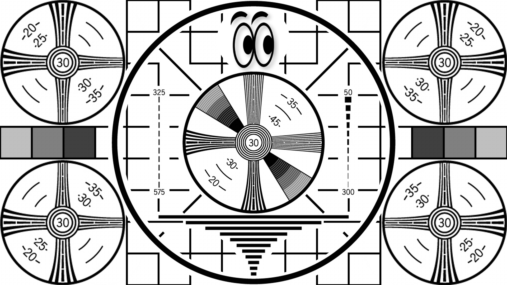

Not a bad idea. One thing you will want to incorporate into your calibrations is different line weights. As a rule: you'll want a circle, vertical members, horizontal members, a nice 45deg member, different line weights, a solid filled shape, and an outlined shape.
sgraber
Posts: 40
Joined: Sat Mar 22, 2014 5:40 pm
Post by sgraber »
Here's a test image for you (attached).
Originally from http://fungi.yuggoth.org/testpattern/te ... d-1080.png and background information about the graphic: http://en.wikipedia.org/wiki/Indian-head_test_pattern and how it's used for optimizing displays: http://en.wikipedia.org/wiki/Indian-hea ... abeled.png

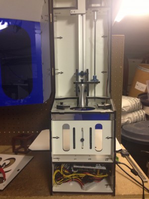

Is there any sort of attachment for the projector or is it just sitting there? Wheres the manual Gene?? LOL
Lost pla castings? see me
Printing my 3 risers. David, it looks like the feet of the projector fit into recess in the riser. The bottom of the riser has a boss that fits into holes in the melamine base. These are printed upside down!
