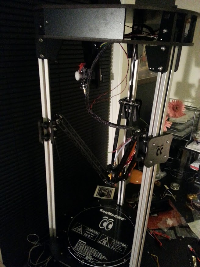

I was able to get the cheapskates adjusted, belts on, and top section together. It's down to the wiring and RAMBo. I'll post pics later. I would have got all that done this weekend, but we were building a post and beam greenhouse during the sun-lite hours instead.

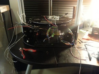

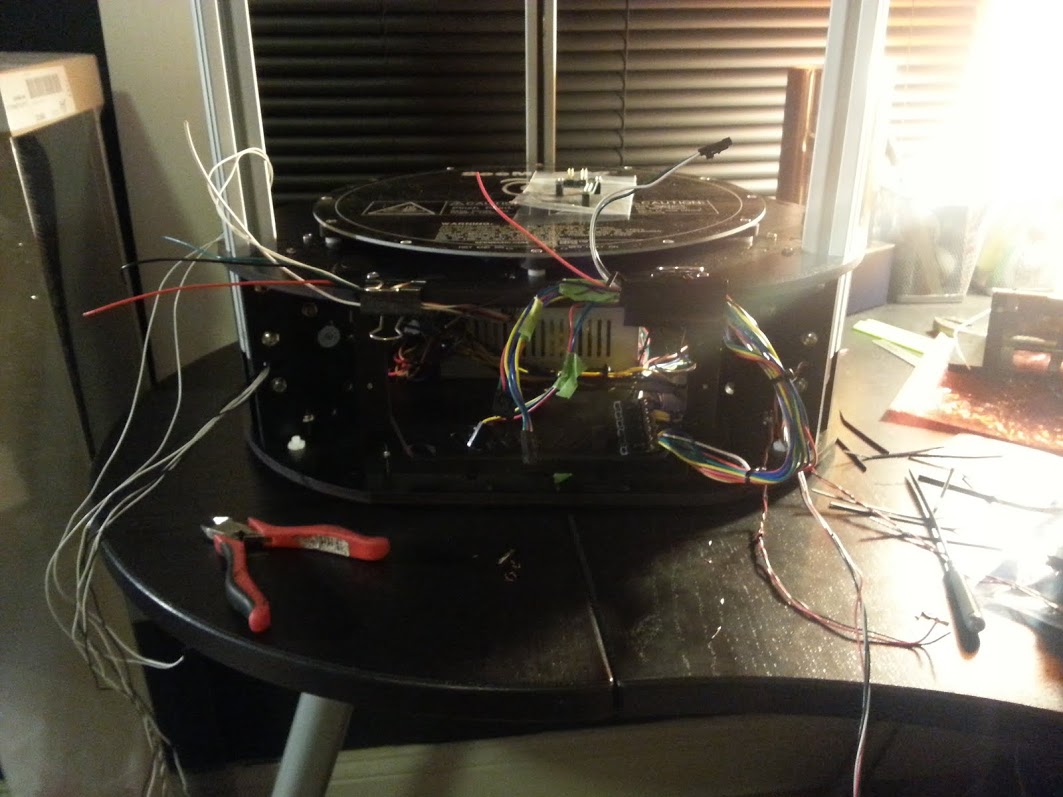

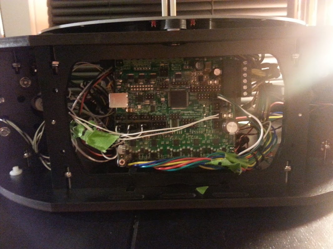

OK, so I've gotten back the build. Working on cleaning up wires and getting the RAMBo board mounted. I upgraded to the travelphotog suggested and it is a sweet fan. Nice high quality fan that will defiantly keep the RAMBo cool and noise level down. The fan kit comes with lots of extra connectors and one is a two wire reducer with wire leads, so dont cut off the corrector on the fan.

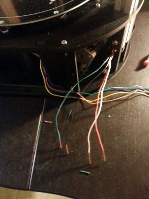

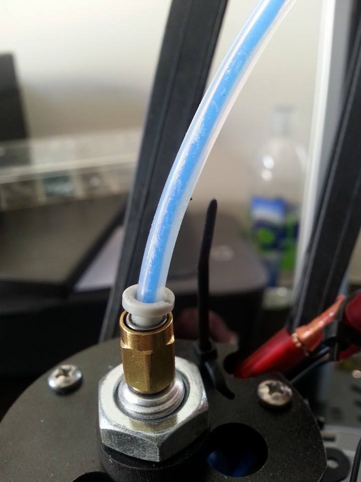

Hot end wires accessory wires and bowden tube installed. The instructions said to route the hot end wires down the down the flexible sleeve, and I did and got the heat sink on, only to find out later that the accessory wires for the fan needed to be down the sleeve also. So I routed it with bowden tube. With all the jumping around and waiting for replacement parts, I going to have to rewire this thing later. I feel like I have not been able to flow through the project and follow the instructions as intended.

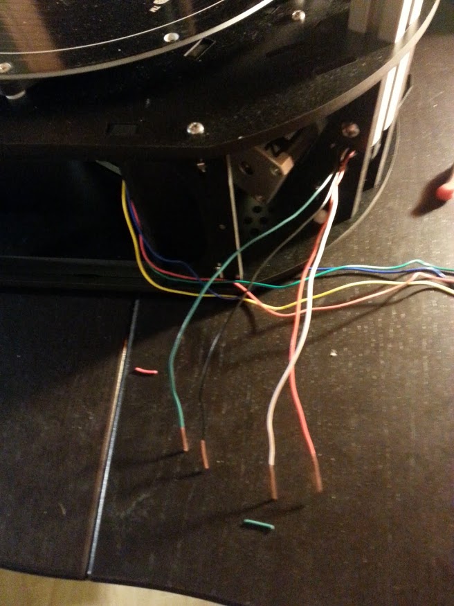

Went to route the 18 gage wires for the hot end coming down the Z axis and found they are to short. I had cut 17 inches off needed for the Hot Bed and I do not have extra slack coming from the hot end that will allow the wires to come out the front of the base to wire the RAMBo. Going to have to go to the store to get some extra wire to solder on and extend them. All other wires have plenty of length.

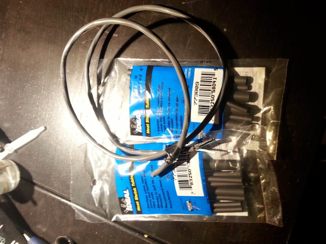

Picked up the extra length of wire I need to extend the hot end wires to the RAMBo. It only took 40 minutes for the guys at spools to find the spool of wire I needed on rack.

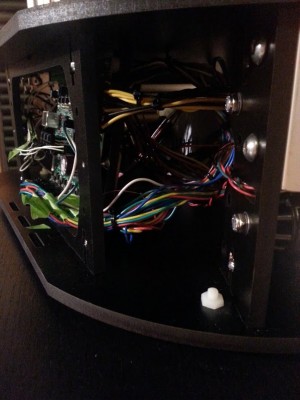

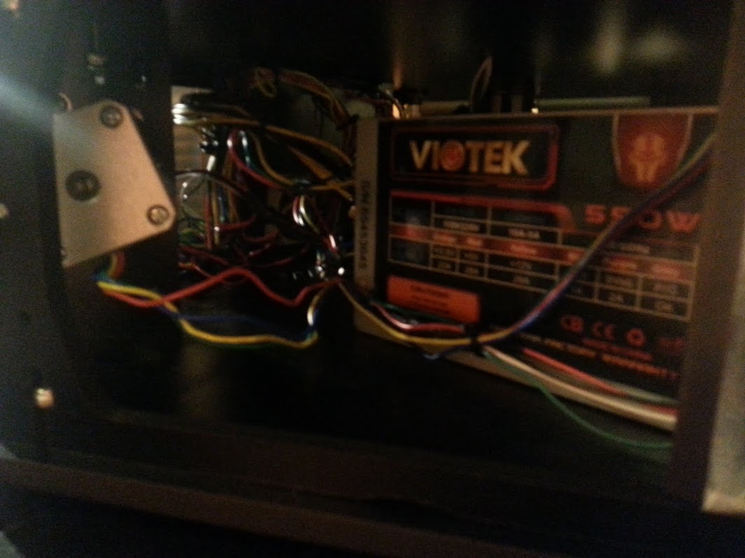

Used some clips to hold wires up and out of the way as I prepped other and cleaned up the rats nest inside. Now it just looks like a tidy rats nest.
I think the RAMBo could be set back inside a little more to avoid pinching wires when installing the display. Adding some sticky pad wire tie locations would really help tidy up the wiring also. I just need to find mine.

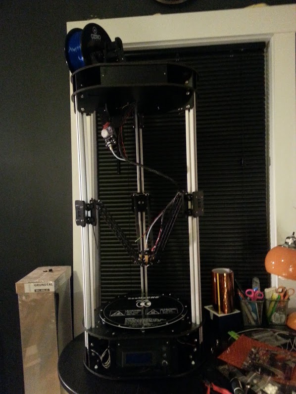

Then after adding the display, odds and ends, nut and bolt check, it's looking pretty complete. I'll have to wait til next week to plug it in and turn it one for the first. Have some other projects to back to first. Feeling better about it, as long as the smoke doesn't come out the first I plug it in.

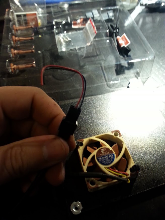

PEEK fan is not turning on. I think I got a dud, especially since I had to push start it yesterday a couple times. How long can you run PLA/ABS before damaging the PEEK insulator?

Couple of things to check. On the peek fan.. Make sure it printed out right and did not shrink to much.. Try a file around where the fan blades turn. It sounds like to mee that your blades might be stuck a bit.. Try hooking up the layer fan and run a fast test to about 60C on the head. Fan should turn on at 50C or sooner. if the layer fan turns on but the PEEK does not, then you have a dude PEEK fan. IF the layer fan also come on late then it might be worth rechecking your firmware fan settings to double check that.

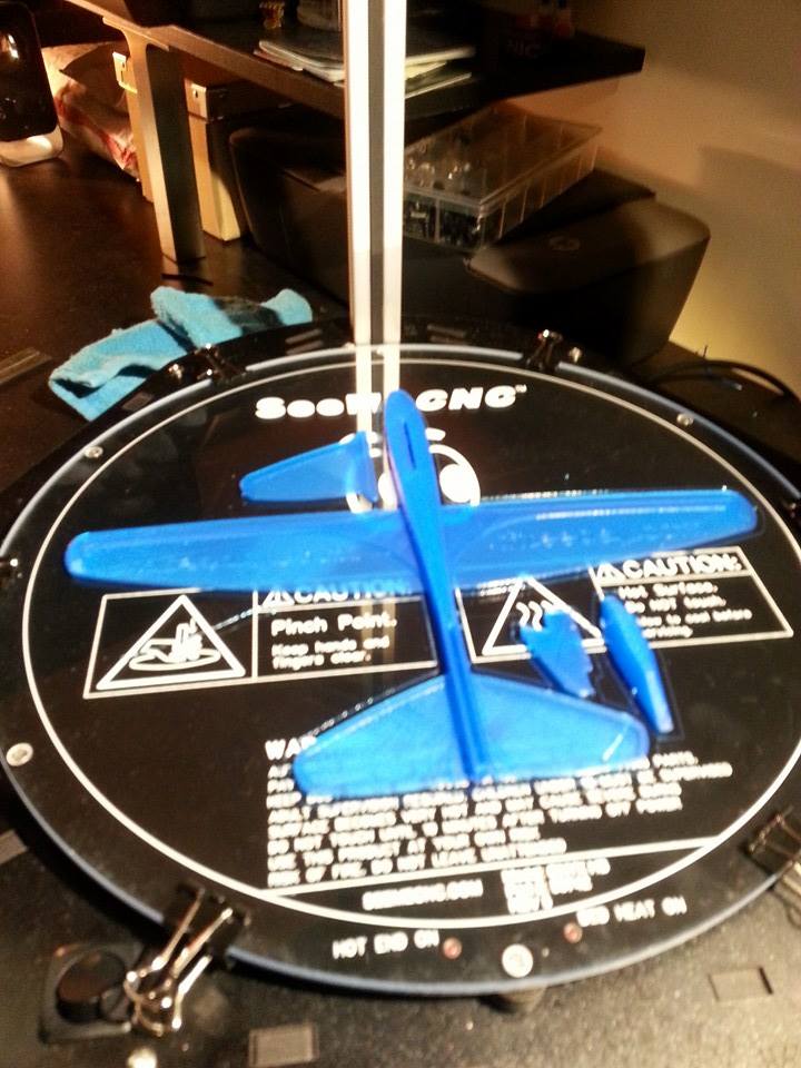

I'm running the printer now. Calibration is a B-word, but once it's right it's good to go. The bowden tube and wires got between the Y-axis home switch and screw, took me a while to find that.
I have to say, all the trouble I had to go through, has paid off. Although, it could have been simpler if the kit was right from the gitgo. I've heard stories of people with other types of printers that can't even get a 10mm test cube. Put I'm also guessing that most good open source printers are getting good hardware and software from the start. All the big bugs have been worked out and now people can build printers and get stuff to print on the first try. In a few years, it will be even easier.

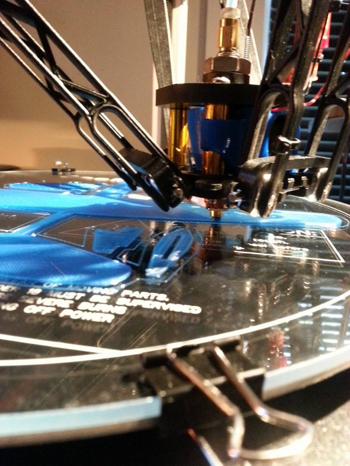

Had a problem after about 12 hours of printing. The nozzle decided to plunge into the part. I was running off the computer and Repetier froze up or something. I'm now printing off the SD card and everything else to be good. Time will tell thou. The instructions should probably be fixed to have start off with printing off the SD card, since it's seems to such a problem with others also. Bad pic, but look around the nozzle and you'll see the puddle of plastic if formed.

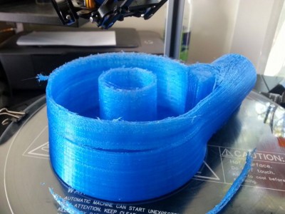

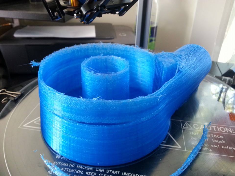

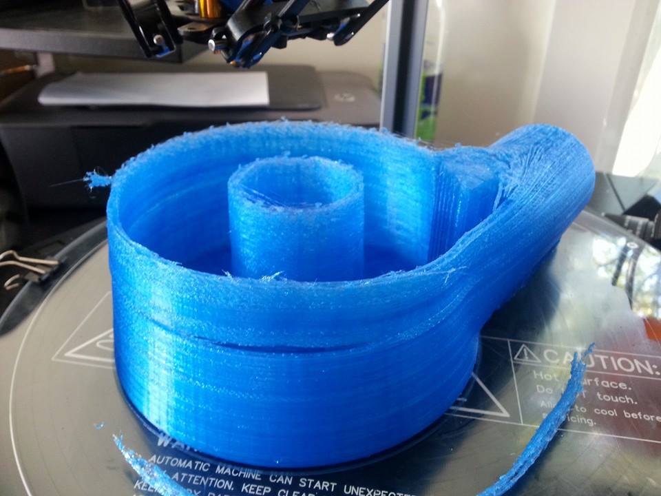

So after running a large print for a cyclone filter over the weekend, I came home to find this. Looks like my PEEK fan failed and the PLA heated up and clogged the hotend and bowden tube. Seems like it's a good time to swap out the hotend and platform to the E3D v6 I've been working on. Not the best timing, as I have a few other projects going on, and I wont get to this till mid-October.
Good time to go over other items on the printer also, like this one. Calibrating my E-steps will be one thing.

That peek fan is really annoying and loud. It's louder than the steppers. I am definitely going to replace it because it is screaming like a jet engine and making me crazy. I have a nice quiet machine with dampers and the fan is making more noise than anything else. I'm afraid of exactly what happened to you, that it will fail and my print will look like a melted sculpture.
