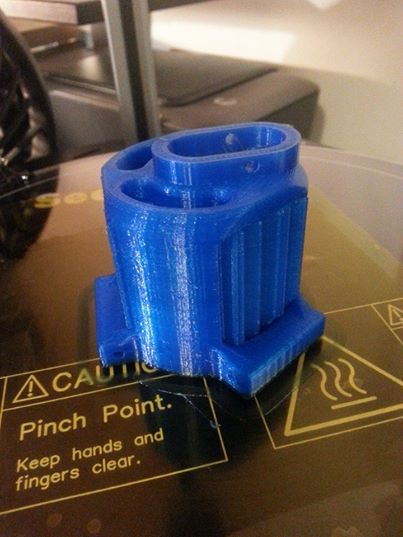

Made my own version of the Monolithic Platform for the E3Dv6. I need work on fit and finish and get it assembled. I made the holes under sized and going to ream them out to fit the pins. I'll go over the details later once it's complete. I printed this one in PLA, since that's what I had in the machine. I have plans to print the next one in ABS and with a mounting location for a 40mm layer fan, using this one that I just made. Used Simplify3D for the slicing, love that program so far, and the support material came right out with no issues. All clean breaks.

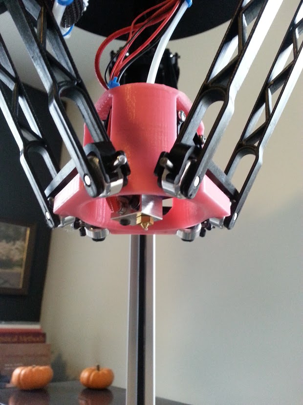

Back to business, after receiving my e3d yesterday and looking at my mounting options, I wasted no time in printing this. Layer set at .3, sliced with cura, line support everywhere. Let me say It works flawlessly first time out, everything fit perfect and assembled like a dream!!!! As far as the no layer fan issue, well i dont really consider it an issue b/c the parts I make (mostly centrifugal pumps amongst other various goodies) that aren't just for aesthetics but actually have to WORK, and PLA isn't nearly strong enough nor does hold up to any sort of warm temperature. I'm actually really looking forward to start playing with nylon to try and make my parts even stronger..... but that's a whole other post.

Just got my Monolithic Platform with E3D v6 together and working. Worked right really well right out of the gate, super excited. Printed a test piece to make sure that everything worked right and now back onto a customer job. The thermistor on the stock hotend fell out and snapped a wire. There was lots of smoke, luckily I was there when it happened. That silicone does not hold very well in a straight hole.
With the new setup, I gained about 11mm more height and can print just over 400mm now.
Couple of issues with having the new platform close to the bed. One, it's hardier to see right where the nozzle is printing. Second, watch out for the arms hitting the binder clips when getting close to the perimeter. Going to to have to work on both those issues.

I had the same problems. I ended up making my mount 10mm smaller in order to have the nozzle stick out more. Takes you back to the same 390ish build height you had before, but my arms don't come anywhere near the table now(I found out they would rub the table/previous layer(s) on bigger prints), plus as an added bonus I can see the nozzle a lot better. Can post an updated .stl or .step file if you guys want.

Yea, I have one arm is just hitting the piece on a long reach. The print is 30 hours for a customer and I was worried about it. It's over half way done and I just letting it go. I'm going to file the need of the arms and see if that solves the issues for the next print. I have no time to make another platform as I have jobs due and running out of time.
I'm happy I got the new hotend on also. I'm going to be displaying the printing at a Meetup on Wednesday.
The next platform design I'll probably raise up just 2mm, that will be plenty of clearance. I'm going to post my STL files here also once I get the bugs worked out.

Seems like fixing the support problem is alot more work than just reaming out the holes with a drill. it's fairly easy. I always found most holes in my prints are able to guide the bit rather well so no need for any crazy accurate approach.
BONE
Posts: 288
Re: Monolithic Platform for E3Dv6 Hot End
Post by BONE »
SEBRET wrote:Seems like fixing the support problem is alot more work than just reaming out the holes with a drill. it's fairly easy. I always found most holes in my prints are able to guide the bit rather well so no need for any crazy accurate approach.
I dont print support in the 3mm pin holes for the pivot rod. I printed them under size at about 2.8 I think and then drill them out to 3mm. I find that the drill follows the holes pretty well also. The pins I have actually measure 3.15mm and it makes for a tight fit. The Trick Laser arms I'm getting uses a threaded rod, so I'm going to print the holes next time to the root diameter of the M3 thread and thread it in.
I'll post a file of my design soon. I'm going to try and put as much of a draft angle as I can on the walls, so hopefully it will reduce the need for the current support. Might work on it tonight
