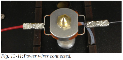

Soldering the
see Fig. 13-11
Is there a problem if I solder this instead of crimping? I hope not. I soldered it....

Yes there is.
It heats up a lot. And the solder re melts and dribbles out on to the print.
And if it relies on the solder to keep an electrical connection it can go bad.

even more awesome is when the solder melts and the heater wire comes loose and shorts out against one of the other wires, which (depending on the random luck) will blow up:
a) A fuse on the RAMB0
b) The Thermistor
c) The RAMB0
c) Any combination of the above.
Don't solder those connections!

Please do not power up the printer again until you get the chance to fix those hotend connections.GPriv wrote:see Fig. 13-11
The hotend is one of the connections you cannot use solder on and if you do, you have a 100% chance
of the connections failing when the solder melts and you risk your rambo card and other components plus having
the possibility of starting a fire. Unsolder the connections and twist together the resistor wires and secure them
by using a crimp tube as is indicated in the instructions. Don't think we don't know what we are talking about
and solder will work, it will not work and I pray that you fix it before you turn that printer on again.

Having done this several years ago on my first printer, as many have mentioned solder won't last, it doesn't exactly melt per-se it evaporates and eventually the connection fails. When that happens as others have mentioned the best case scenario is your print fails, the worst is you end up with a hotend wire shorted against a thermistor wire and you destroy the RAMBO board.

Question: Why is it okay to solder the thermistor leads? (I assume because these don't carry the heat/power as do the leads to the hot end...)

The thermistor leads are very long and thin and so they don't conduct much heat all the way to the solder joints. The solder joints connect them to a comparatively heavy gauge wire (compared to the thermistor lead), which acts as a heat-sink for any heat that comes from the thermistor lead. It wicks away the heat so the solder joint never gets very hot.
The hot-end resistors are connected to thick leads which carry a lot of heat to the joints, and they are doubled up on each end, so you have a lot of heat transferred from the heating elements (resistors) to the solder joints through those thick leads.
