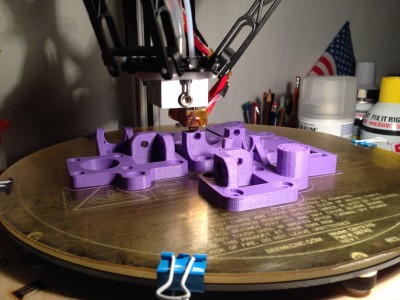

I got the PEI and it seems pretty great. I don't have the tape to attach it yet, but I attached it to my build plate with binder clips for a quick test. I had ABS in my machine and I got it up to 95C, normal print temp for me. The PEI was pretty warped at this temp, but I was able to lay down a skirt before I cancelled the job. I had to peel the skirt off it stuck so well, as in it was like I was peeling off tape. Big improvement over gluestick, where it just barely stuck enough to keep the skirt down. Cant wait until Thursday for the tape to come in to attach it. Been following the PEI test thread by MHackeny, pretty cool stuff.

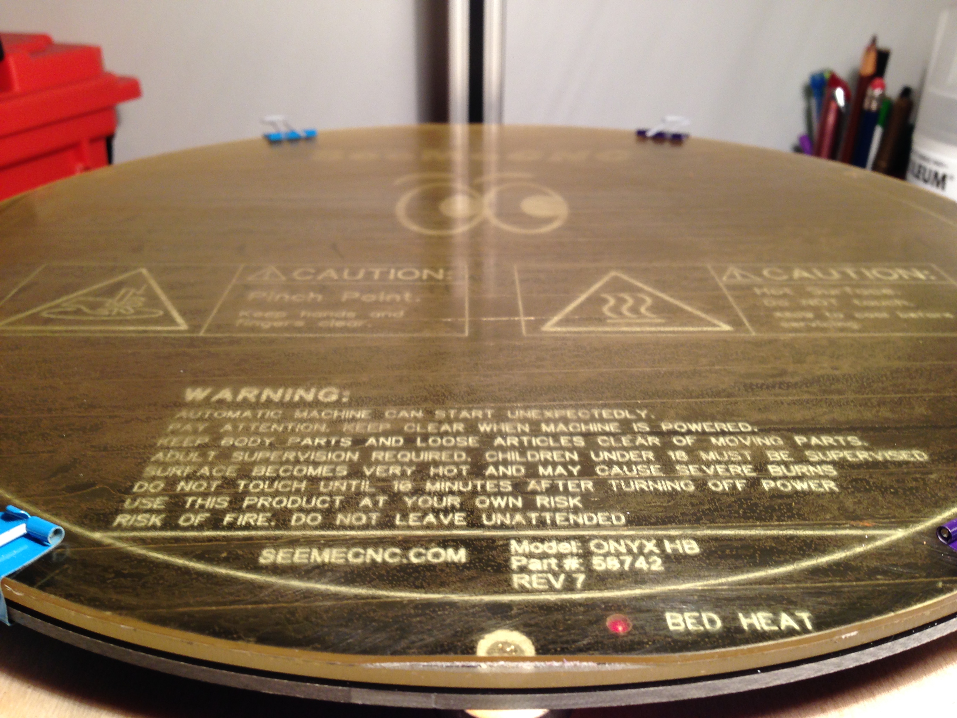

I have the PEI attached and its been working great. I have about 24 hours of printing on it, 4 prints with varying degrees of full build plate.
