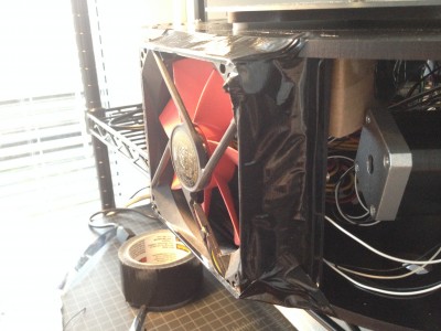

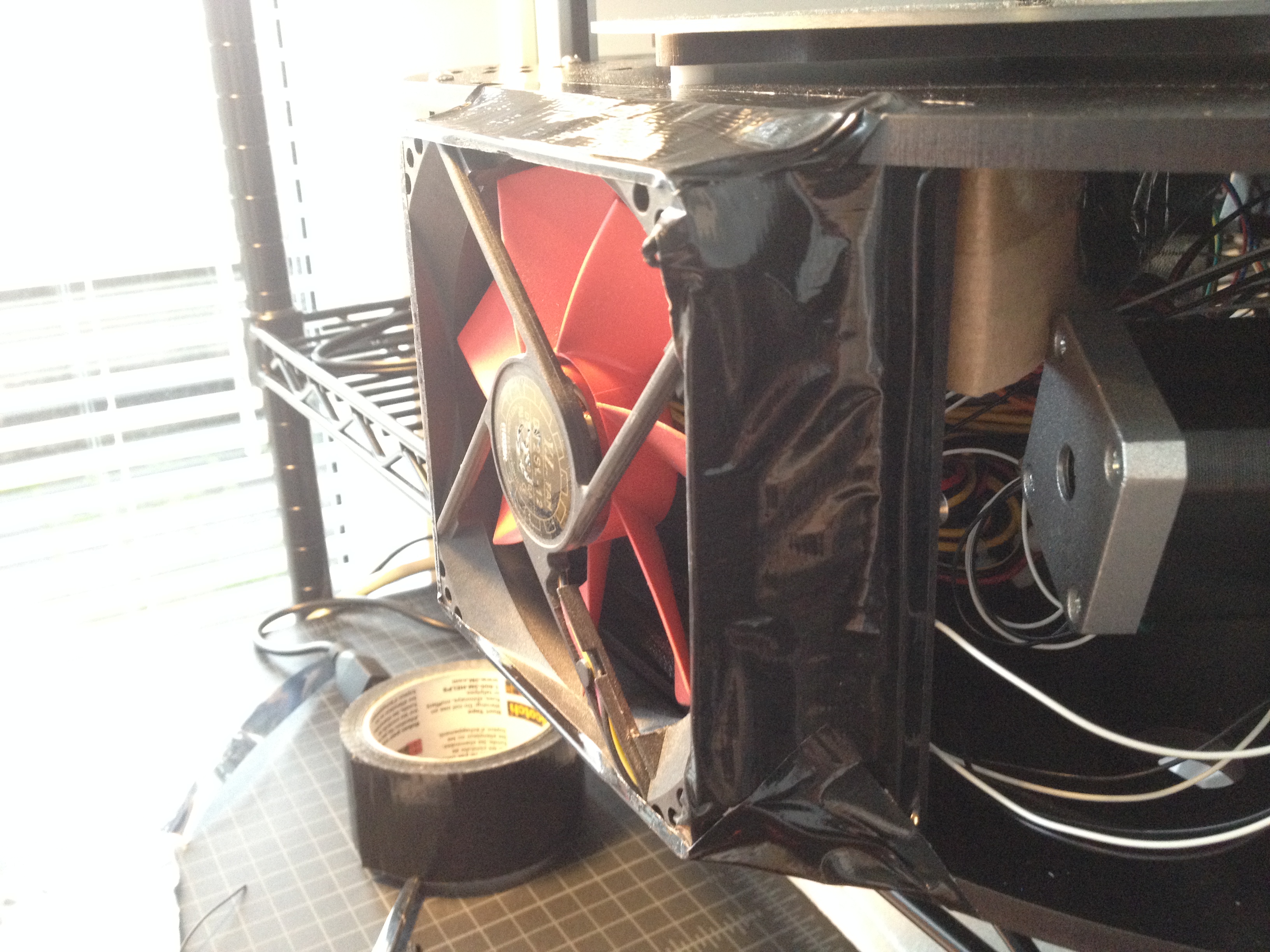

I just flipped the fan inside the PSU. It will blow fresh air from the back into the case. I'll make a duct out of duct tape (OMG I'm using it for its intended purpose!!) and cardboard that guides the air to the back side outlet fans I'm adding.

As I said earlier, the PSU can't be flipped around. I suspect the guys at SeeMeCNC cut the hole in the bottom intending on mounting the PSU "correctly," but the clearance wasn't enough... or not? They should definitely mirror the Z axis, to allow the PSU flip.
I had to flip the fan around instead. This will draw air through the back (and through the smaller vents near the Rambo) and out the top into the underside case.
Progress...
Progress...
Here's the duct tape duct...

On my setup, I will have the 120mm .18A PSU fan bringing air in from the back of the case and the small slits on the rambo side, and then exhausting it out the top into the underside. I have separated the underside chamber into two at the top with the duct tape duct (actually, it's only a shroud. Do they make shroud tape?). The two 120mm .3A fans in place of the back panels will exhaust air from the PSU and from the variable-speed 80mm .4A fan blowing on the rambo (which is bringing in fresh air from the bottom vents).
This should be adequate, no? I figure the two 120mm exhaust fans will be good enough combined with the pressure forcing air out. I hope the duct is enough to guide the PSU air out and not into the Rambo side of the chamber.

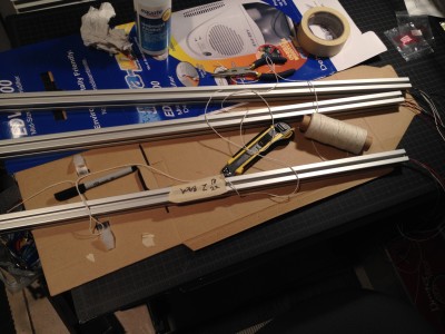

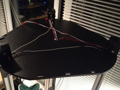

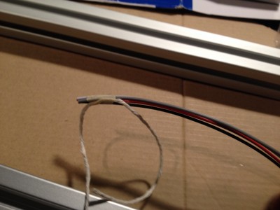

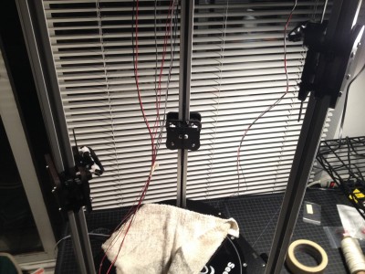

A lot of people complain about the difficulty of fishing the wires through the towers. The trick is to use string. Guide the string down the empty tube with gravity doing the work.
Do this.
Do this.
You have to be keep the tape application very sparse to keep the profile small. They will pull through very easily, though. You must do all the wires at once. So, for the end stops, stagger the pins a bit so they don't all bunch up and become too big.

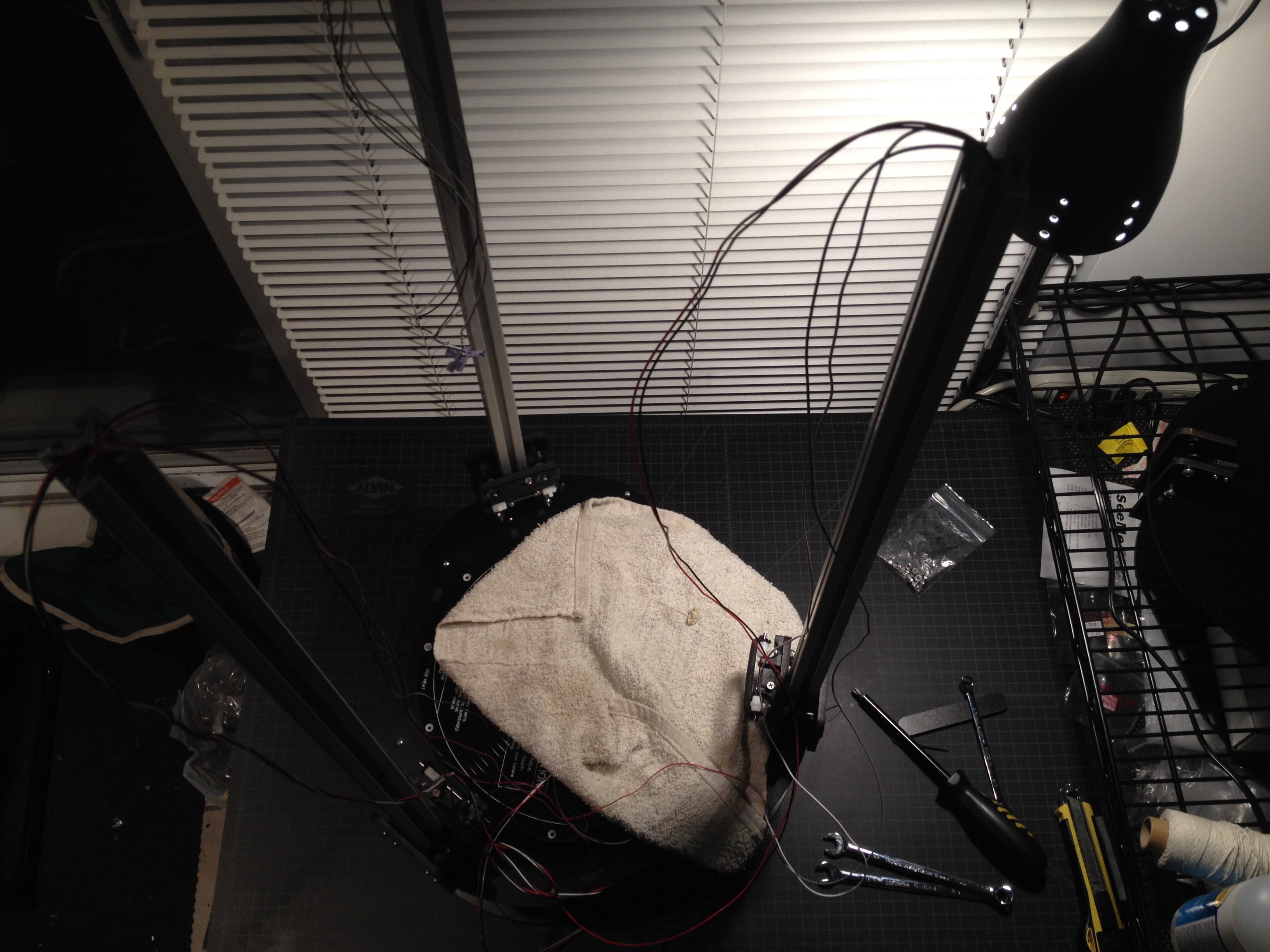

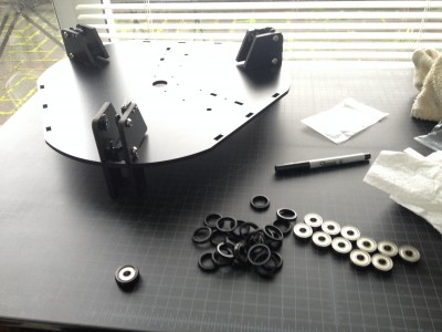

I found a scrap piece of melamine that helped in seating the bearing covers. Even a thick towel didn't prevent the ridges from hurting like a M'F'ER.
Ahhh much better!

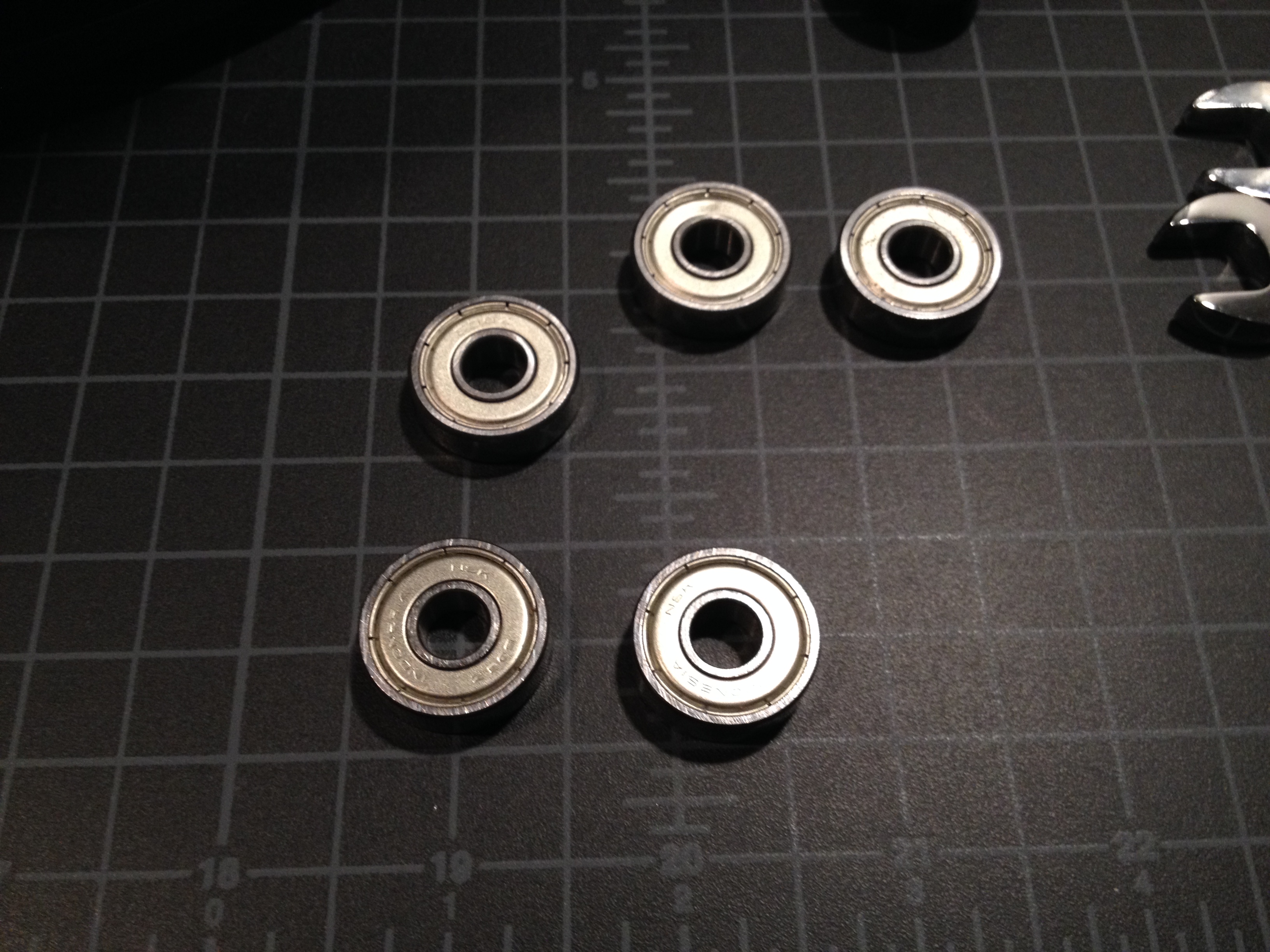

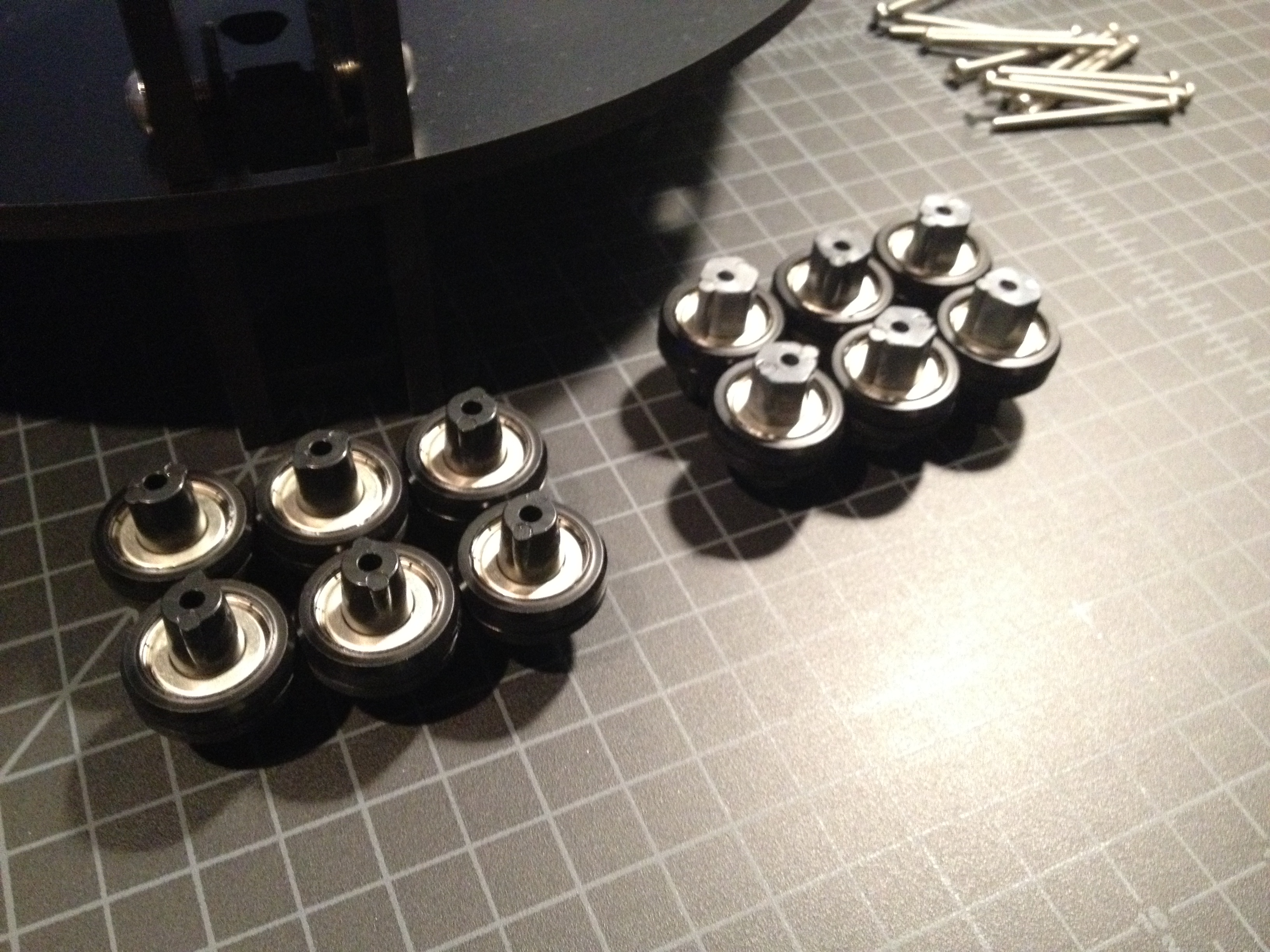

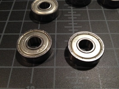

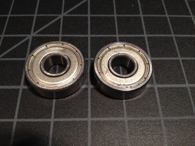

If you look closely, you'll notice a couple bad bearings. (I have a habit of checking every single part)
Ay caramba!
Ay caramba!
One had a slightly collapsed cover, and the other was obviously contaminated with some kinda solvent/chemical. Both felt a little rough when spun. I might have still used them as the tensioner pulleys had I not had a couple spare 608ZZ laying around.
NSK, no less.

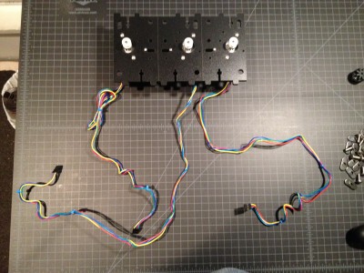

Some wiring.
Some wiring.

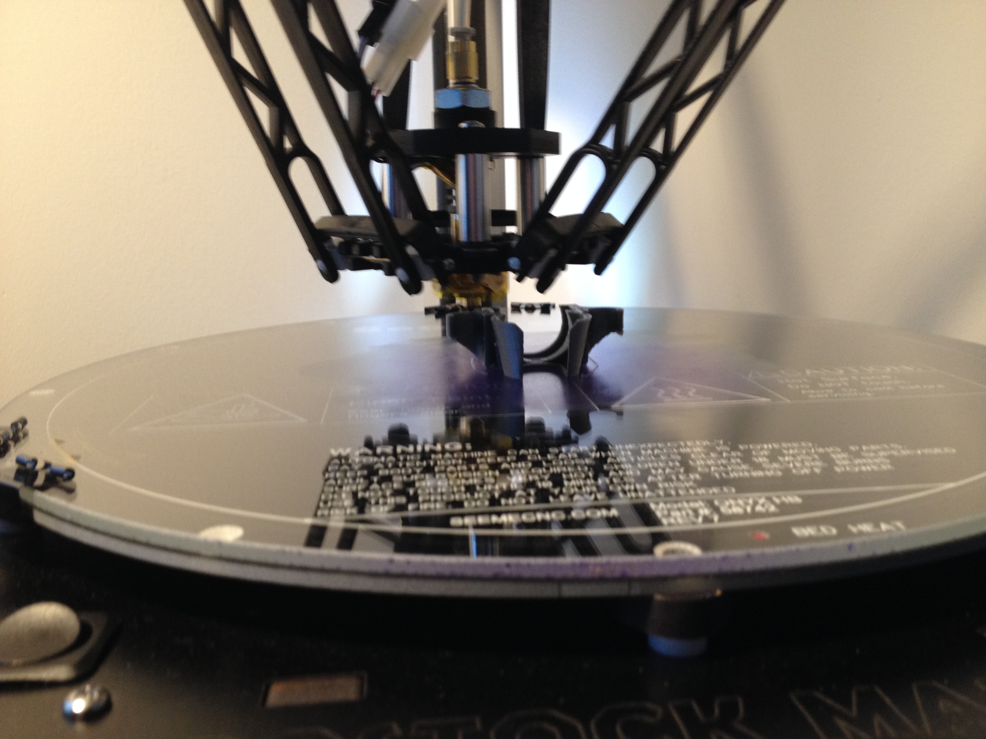

Because the Kapton tape adds thickness, it has the potential to cause the glass bed to warp.
So I added three points, one under each tower, where there is two layers of tape applied. This should allow the bed to be clamped in a defined plane without forced warping. I later clamped the bed as close to the three points as possible.

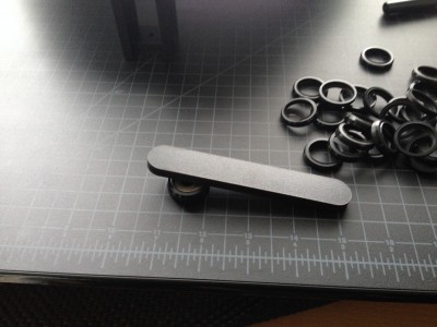

And those skates were easily the worst part of the build.... Those damn plastic rings are little spawns of satan I swear. I literally had to stand on one of them to get it on.

You added more kapton tape in three locations around the Onyx bed to prevent doming of the build surface.
Why not just remove the tape from the center? It was placed there to prevent RTV silicone from oozing through the hole during thermistor installation. I removed the tape from the top of the Onyx bed once the silicone cured.

That's actually what I'm going to recommend be done. I don't think the vias are exposed any longer so the reason to have them covered is no longer relevant.

I thought the vias weren't exposed, but wasn't sure so I figured I'd cover them anyway. I tried peeling the tape off the center hole, and it began pulling the RTV away, so I put it back in place.
Even if I were to remove all the tape covering the vias and the center hole, I still want the plane to be defined by three points. Any more and it can be constrained in a warped plane. Thus, the three double-thick parts with tape.
