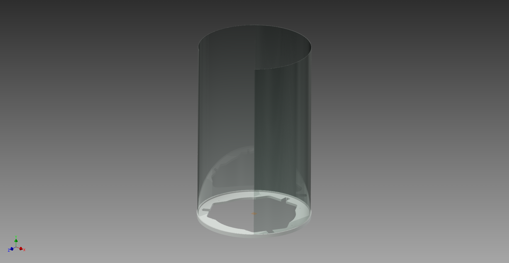

So this a took a bit longer than expected, but i have the base done, I havent gotten around to splitting it into different parts!
But i did come up with a really interesting way of making doors. It uses two sheets of plexi that overlap in the back and then there will be handles in the front to close or open it.
Hopefully that makes sense, use the picture below for a reference.
The only issue I see now is that it uses a good amount more of plastic. Ups the print time significantly Id imagine. But the top shouldnt be too difficult. Hopefully I can get it done before I start studying for finals!

Yess!! I LOVE that design - I can't wait to see how it might turn out in reality!
I didn't quite understand the door idea. Were you thinking of something like french doors where you're got two panels and they open in the middle? Or something like a sliding door, where once it's open it's overlapping with one of the sides of the enclosure? That's an interesting idea....

Herrminator117 wrote:So this a took a bit longer than expected, but i have the base done, I havent gotten around to splitting it into different parts!
Sliding plexiglass doors. Cool! Will probably be pretty hard to make work right without some kind of form for the plexi though.
