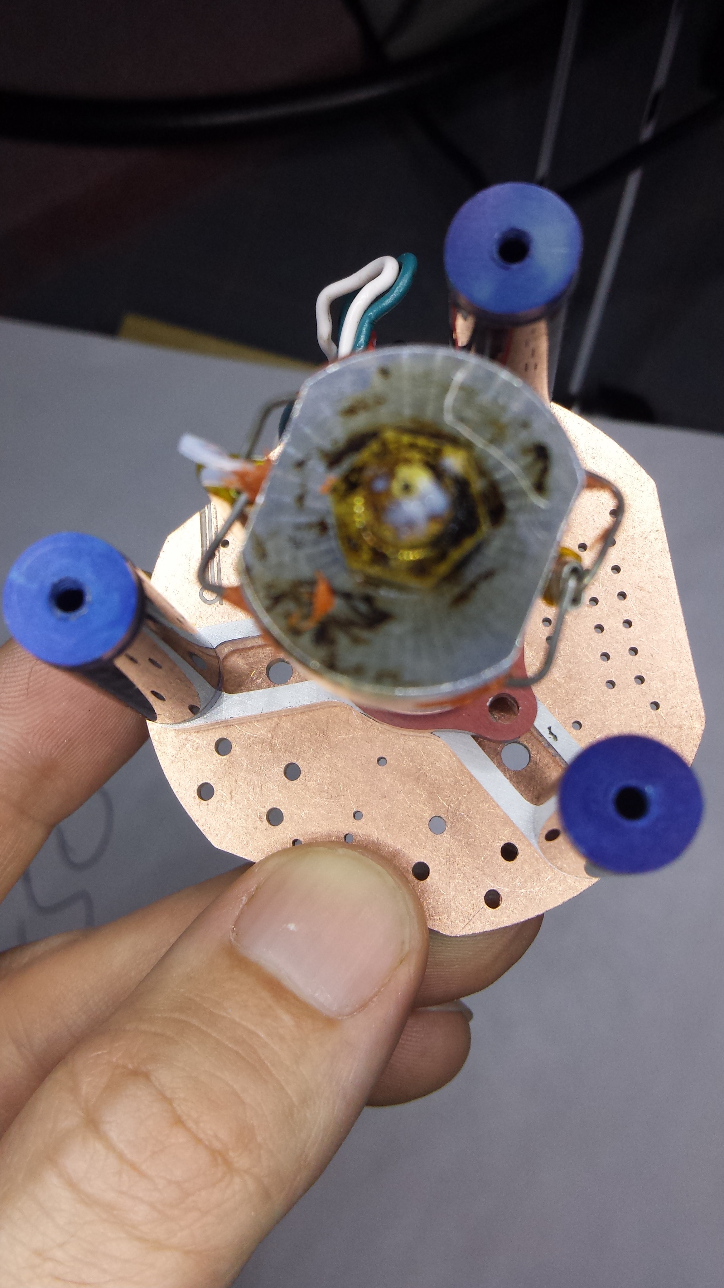

Here is what I am talking about above,
With standard SeeMe hotend
[img]http://www.themakerhive.com/FTP/jassper/hep_stock.jpg[/img]
And with a groove mount
[img]http://www.themakerhive.com/FTP/jassper/hep_groove.jpg[/img]
Also after looking closer to the board, the short stand off on the top side isn't needed as there is nothing protruding from the board in those areas

OK so if the "top" side can be flat and the "bottom" side is where we need to mill a recess then we are 100% good to go. If you PM me a STL or STEP file I should be able to mill one out and get it sent up your way. in Yellow of course!

The only reason now that it would need to be recessed is for the aforementioned reason that the inner 3 holes on the board are not electrically isolated. but I can easily use a piece of insulation.
Here is the STL but you might want to verify measurements and hole spacing as I drew this really quick. Everything seems to line up. Also it looks like the E3 has a larger body than the Hotends I have so not sure it will work with those, maybe you can check that.

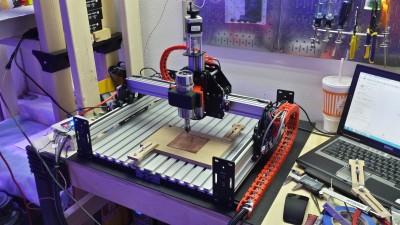

This is early on when I first got my mill.. Right now I am running the 400W DC spindle but I am soon going to be switching out to a 400W DC brushless spindle for higher torque at lower RPMs.

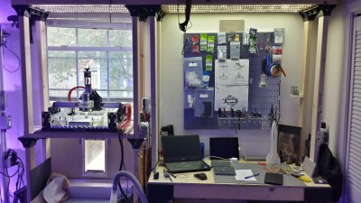

This is my little work area. This is by far the best work bench and storage system I have found and is 100% custom and I love it. You buy the black plastic parts that hold it all together and the rest is up to you. I love this system. BTW the strange glow off to the left is from custom coral farm reef LEDs. I grow and sell saltwater corals in a book shelf type system just off camera to the left. The lights are 10K Kelvin so look super odd to the camera phone.

For hardware I have the following on the mill. 400W DC spindle with speed controller, Full metal t-slot bed, Upgraded Z axis rod and bearings ( this is also a super good upgrade and worth the cost). I run a TINYg controller for the controller but might be switching to MACH3 shortly so I can use SOLIDcam as I can not find a post processor for the TINYg for SOLIDcam. Right now I use SOLIDWORKS and HSMXPRESS which is a great pairing. I would go to HSMWORKS if I had an extra $7500 for the 3D milling package. I like to barter at times and was able to trade shooting some ad stuff for a local oil valve company for one of their legal copies of SOLIDCAM. Upgrading to a MACH3 or MACH4 system will allow me to take full use of that. I run the mill though CHILIPeppr right now with the TINYg. Over all it is a great combo, though from time to time it has a controller fart and dumps a job here and there (GRRR)
This is my next mill I think https://www.finelineautomation.com/prod ... cnc-router I am limited by the small work area of the Shapeoko. I need the large space for some on going projects. I have good contacts in the music world and custom amps and guitar parts are in high demand, but my Shapeoko limits the size of the projects I can do and has cost me a few jobs already sadly.

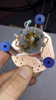

OK so I got a board shape for the YJ last night and threw some 2.33mm CEM PCB on the mill and cut one out. So looking at this I am really wondering how you fit the E3d V6 into this guy. From what I see the center mount is 11mm for the SEEMECNC mount. Which fits pretty much spot on on my test board I made. But as it is a 11mm hole, the 16mm E3d V6 is not wanting to fit without making the hole larger. So I would love to see how you managed to fit it on there. Is it just as simple as cutting the hole larger for the E3D?
I know it is not an issue with the Yellowjacket. It was made for the 11mm sized coolers. I am just wondering how folks are getting it on there. only way I see is cutting on the board. Since you seem to have gotten up and going on a V6 I thought I would ask you.

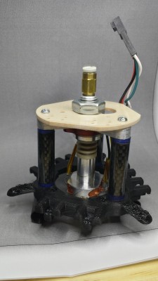

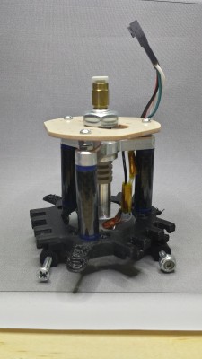

OK guys... I have been working on this tonight but it is time to hit the sack for a bit. I have to do photographer interviews tomorrow for a bit in the AM which is my least favorite part of my job. I have been looking at this and I think I have the answer to pretty much all the issues we have found so far including the worry of shorting something out with the 3 central screws. I have not mocked it up on the E3d yet but I should have that done tomorrow.. Here is a mock up of the stock SEEMECNC head.
SEEMECNC stock head and Yellowjacket mock up.
Pretty much the Yellowjacket sits right on top of the SEEMECNC stock mount I made yesterday. None of the holes in question are touching anything that can short them, they line up with the weight reduction slots I already had so are not in danger of being shorted out.
The holes we were concerned about are now safe from harm of being shorted.
The stock nut holds the head nice and tight with just a thin spacer (2MM ish) on the bottom side. This mock up is on 36mm spacers but I can of course supply stock length carbon fiber spaces on the final design.
Ok that is it for me tonight. 3:30 is my bedtime today guys. Looking forward to everyone's thoughts tomorrow and pretty much it works almost the same for the E3d V6 with no mods to the Yellowjacket board from what I am seeing right now.

To mount a JHead to the YJ mount, you do have to dremel the C shaped hole into a U. There's just a sliver on each side that has to be removed. Looks like you got it.
I think the shorting problem is because of solder pads on bottom that don't have a via or through hole.

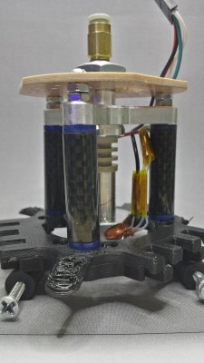

OK now I see those guys. I only had the mock up I made which of course does not have any of that stuff on the bottom.
But my understanding is that two of the three central screws closest to the hotend are also not isolated? So if we screw those two into a metal mount they will short out yes? If that is the case then I would go using the E3d mount pretty much how I had it, then put a small spacer between the YJ and the Mount to account for the screws holding the E3D down. This will not have the need of using the 3 srews that can short in a metal mount and also not have the need to widen and risk damage to the YJ to allow the larger E3d 16mm mount width needed.
The same seems to hold true for the stock hotend and even fixes the spacer issue on the head mount.
Since only the bottom 3 screws are removed from the effector plate to change a head, this system would allow the stock SEEMECNC head, Jhead, E3D V6 and E3D Volcano (with V6 cooler) to be used without any mods or cutting to the YJ. Changing heads is simply a matter of three screws to bolt on the "head unit" which which would be an aluminum mount to hold the print head steady, three carbon fiber spacers, then the YJ with the stand off spacers. But this whole unit is one item and just bolts right on. So anyone running any of these three style heads can use just the aluminum mount or if they choose to buy a YJ they just screw it on top and have the best features in one unit. Being modular allows someone to say maybe buy aluminum mounts for what ever head they have right now, then add a YJ at any point later. Or anyone who owns a YJ right now can add the aluminum mount without too much hassle, just three screws and three small YJ stand off spacers and the carbon fiber spacers..
How does this sound/look to you guys?
It will be simple to mill the needed spacers between the YJ and the mount so I think we might have a winner here.

Check with Glenn on the exact dimensions and layout/schematic of the board since he knows it best, but if you're using the outside 3 holes and raising the board off of the mount I think it solves the problem. Also is more universal and lets you hack it later without modifying the mount itself.
I did something similar to this when I first added my YJ connector, but I attached the connector board to the clamp with the inner 3 holes instead.
[img]http://i.imgur.com/aKHSndG.png[/img]
I wish there was a way to incorporate the quick disconnect functionality without covering up the beautiful aluminum and CF structure of the mount...

That's correct travelphotog. Jim you have an older version of the board, those pads are no longer there, but the 3 j-mount holes are actually through-hole solder pads so there is exposure both on top and bottom plus a via.
And if cutting this out of Carbonfiber works out, then no worries at all. And like I said earlier, I can change the board before next order to isolate those holes.
Thats not raising the nozzle too high is it?

We can shrink the size of the carbon fiber spacers with ease. We can work out the needed heights for the three main heads, SEEME, E3d and E3d Volcano. there seems to be MANY Jheads out there of a few sizes so we might need to maybe look at the most popular and size the carbon fiber spacers based on them. But adjusting the spacer height for the main heads is easy on my end. Just so I am clear, the three main mount, outer most large screw holes in the YJ are not attached to any traces right? it is only those inner three we had to worry about?
Posted: Wed Jan 07, 2015 12:41 pm
by travelphotog
EDIT... The mount is now what holds the heads, so spacing the YJ up a bit does not mess with the hot end spacing at all. On the stock SEEME the YJ is what mounting nut screws down to, but the bottom of the hotend is held in place by the aluminum mount so does not get effected height wise by the YJ being spaced up a bit.

Right. However there is a small solder jumper pad next to them is someone wanted to connect them and transfer power down to the effector plate. But those pads should be clear.
Posted: Wed Jan 07, 2015 1:27 pm
by travelphotog
It is on the top of the board yes? If so then I think we are OK. I was thinking to use 4-40 screws which would have smaller heads (but they still just hold the YJ OK) so if this pad is on the top then we should clear it OK with a smaller head screw. I can mill a tiny lip on the spacer under the YJ to center them up on the YJ mount holes and make sure the 4-40 screws are centered even though it is a small screw size.

If the pads are not used why not remove the pad instead of milling things around it?
Sharp razor blade and cut right through the pad of copper and lift it off.
Posted: Wed Jan 07, 2015 2:12 pm
by Jassper
travelphotog wrote:It is on the top of the board yes? If so then I think we are OK. I was thinking to use 4-40 screws which would have smaller heads (but they still just hold the YJ OK) so if this pad is on the top then we should clear it OK with a smaller head screw. I can mill a tiny lip on the spacer under the YJ to center them up on the YJ mount holes and make sure the 4-40 screws are centered even though it is a small screw size.
One is on top, and one is on the bottom, so as long as one or the other isn't touching you will be fine.
As long as the screw head isn't larger than 8mm it should be fine.

One of my main goals in working with Jassper in relation to the Yellowjacket is to not change his product in order for my mount to work with his product. It is easier for me to adjust my toolpaths and mill something to fit his great product than it is for him to make adjustments to the Yellowjacket. I would like for the two items to work together as some have asked and I am striving to do this so that no mods need to be made to the Yellowjacket so anyone past or present can use my mount with his board and enjoy a great printing experience with more than one style of head if they choose. The Yellowjacket does a great job of cleaning up the print head visual and that is something I like very much.

OK that works good. the standard 4-40 head is 4.75mm across. On the mock up I cut out last night that seems to cover the screw hole just fine so we are good there. I will mill the body of the spacer to about 7.5mm OD and then mill a small raised insert to center it in the YJ screw hole and then bore a 4-40 clearance hole for the mounting screw. I think we are looking good here. The 7.5MM OD size will insure we clear the lower pad contact also with a tiny bit to spare. I should have something mocked up in CAD shortly. If I can I will mill a test set of spacers later today. I have to cut out a guitar pick guard first though today. Once I throw that on the mil I will jump in CAD and see what I can get worked up.
