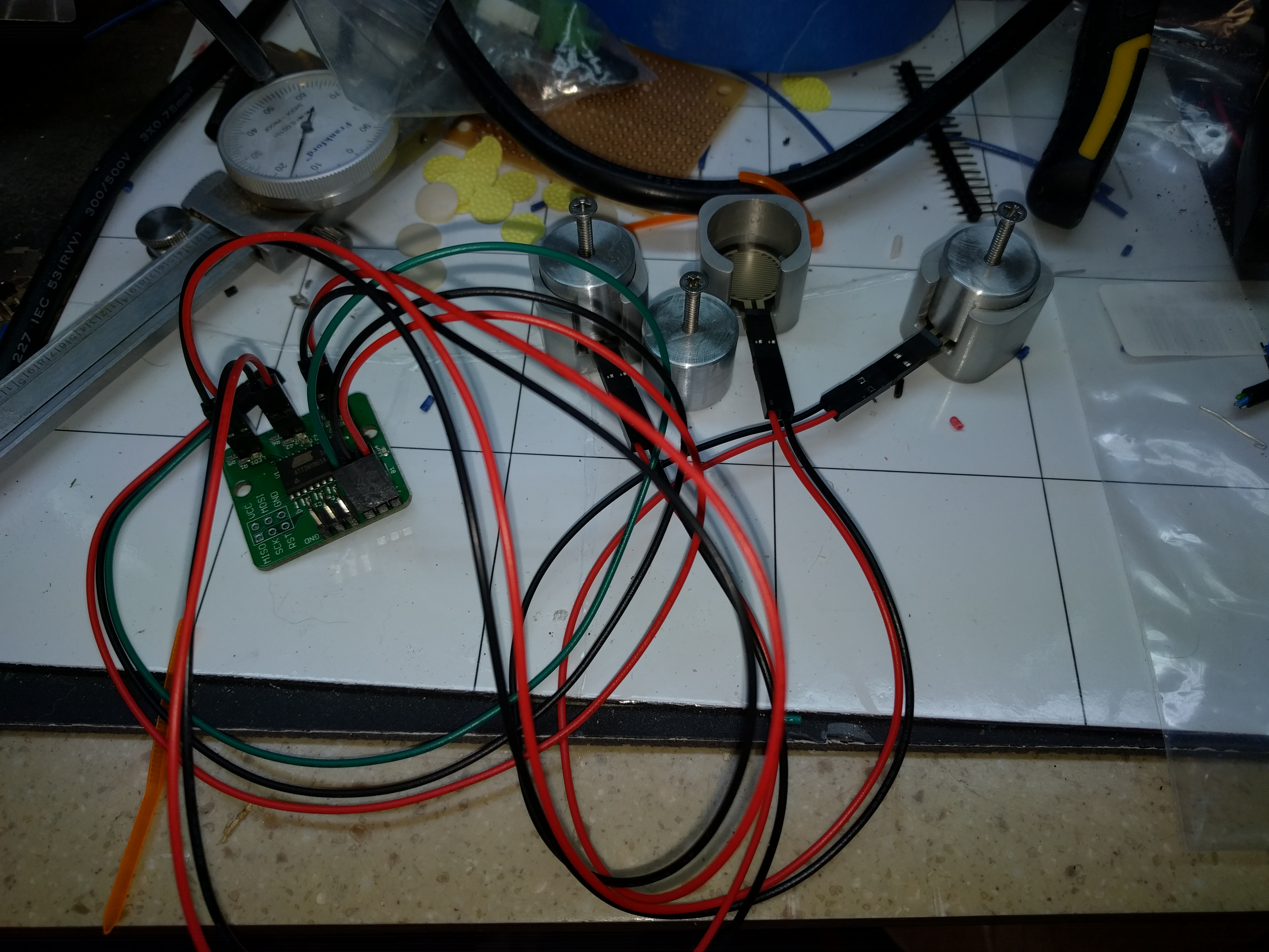

I got this kit http://www.ultibots.com/fsr-kit/
Seems to have everything you need to turn 3 FSRs into an endstop.
When I got to work today my friend had my fsr mounts. I'll post pictures after offspring goes to bed

Here is the promised picture of my fsr mounts, I'll spend a little time soon getting everything finished and I hope to be printing this weekend, I'll add more pictures add I get then taken

I am redesigning my mounts based on lots of experience (mine and others). Even my mounts where I attempted to not over constrain too much, are a bit over constrained. This is a killer for FSRs as they have to be able to move freely without binding. Full round pistons in round cylinders on all 3 points is way over constrained. A single piston/cylinder on one corner, a simple "peg in slot" at another to eliminate rotation around the first corner and a simple no -constraint pad is all that's needed.

since my mounts are aluminium I put a little gun oil on them to help keep them from binding, it seems to work pretty good, no matter where i touch it triggers with only minimal pressure, but I am worried about binding, especially on the one near my beta tower, it is tighter than the others and does not allways move freely. i have not run a calibration test on it yet.

mhackney wrote:I am redesigning my mounts based on lots of experience (mine and others). Even my mounts where I attempted to not over constrain too much, are a bit over constrained. This is a killer for FSRs as they have to be able to move freely without binding. Full round pistons in round cylinders on all 3 points is way over constrained. A single piston/cylinder on one corner, a simple "peg in slot" at another to eliminate rotation around the first corner and a simple no -constraint pad is all that's needed.
Interested to see what you come up with. I'm just about ready to pull the trigger and add an FSR kit, but they'd be in imperfectly-printed mounts of some kind. I wonder how the design can be adjusted to tolerate variation/error in printing and keep itself aligned properly?
