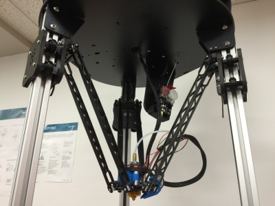

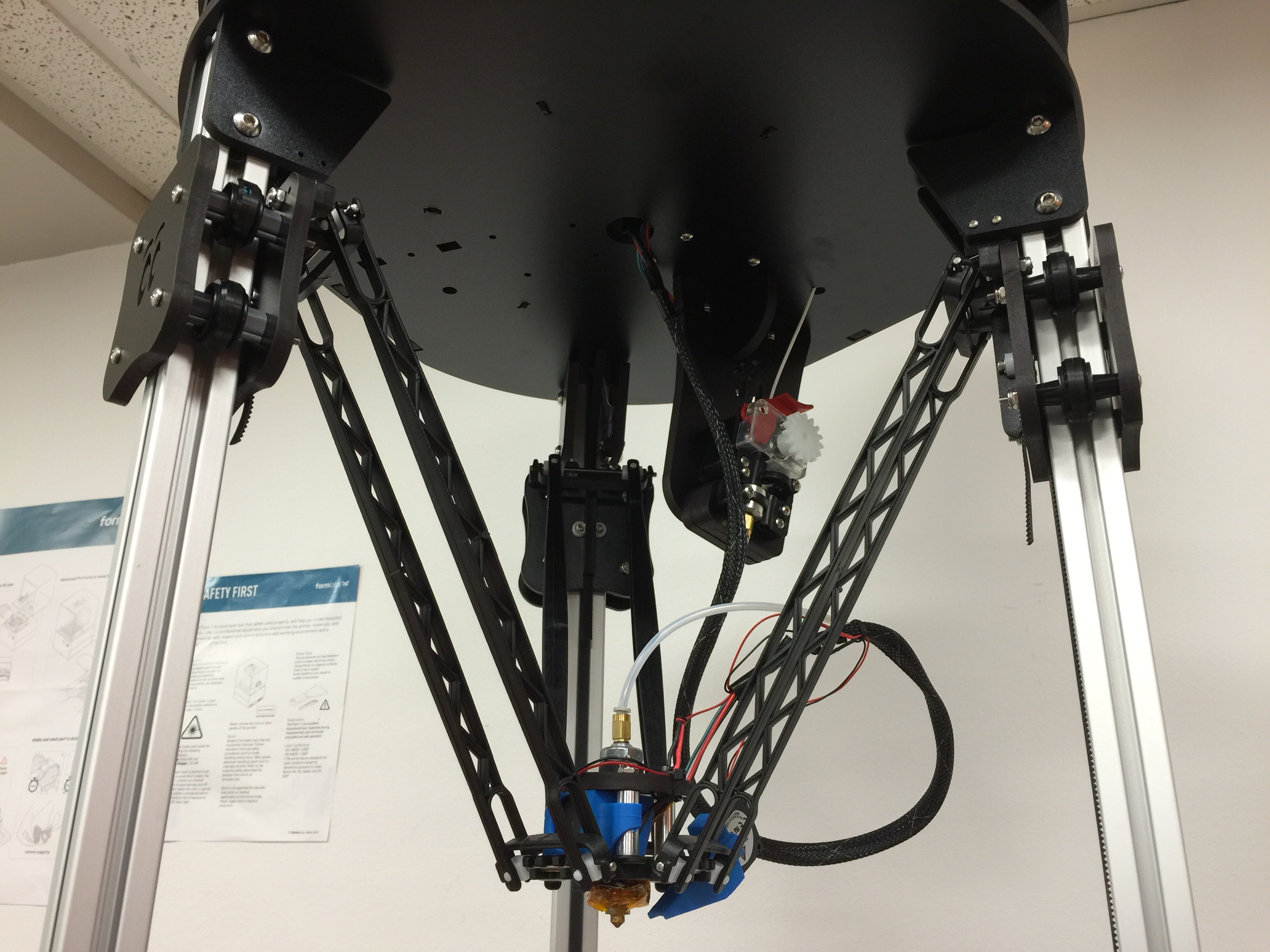

There is something very wrong. You measured the distance from the top plate to the end stop yesterday. Those values were all very close. I would expect the 3 screws to be adjusted to very similar lengths. Can you step back and take a photo of all 3 switches sort of looking up from below with the the carriage bolts just touching them?
This angle but with the carriages moved up:
[img]http://mhackney.zenfolio.com/img/s7/v15 ... 6889-4.jpg[/img]
And a similar one looking down at the base.

Mhackney- are these good?
Re: Strange behavior after recalibration
Yes, which one is Z in the top photo?
noahcoleman
Posts: 17
Joined: Wed Aug 05, 2015 5:57 pm
Post by noahcoleman »
the one in the middle of the picture, just to the left of the ezstruder

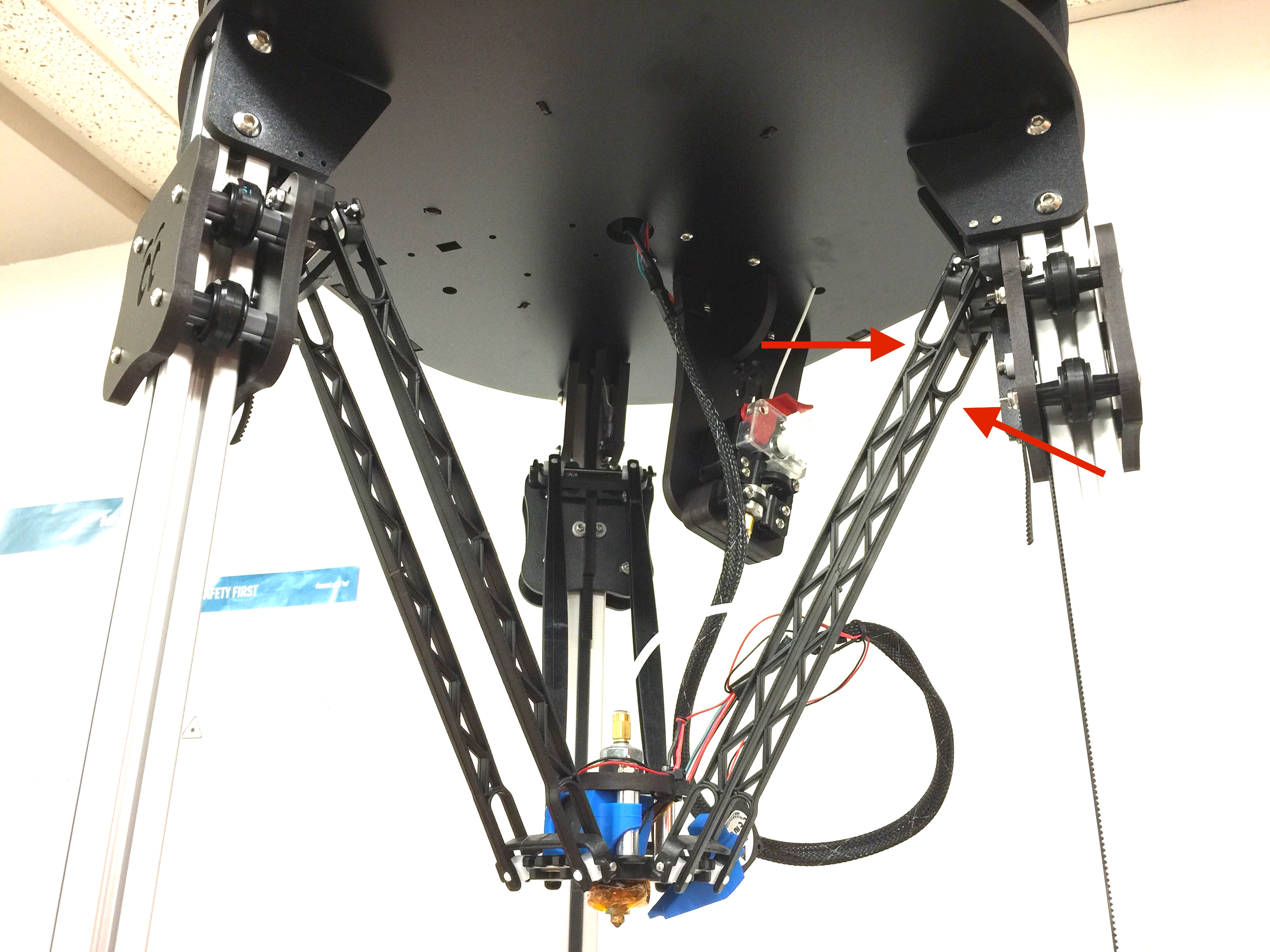

Just an observation, do the arm ends have a measurable offset from center or does it matter if they are miss-matched when installed? Looks like a little hump on one side and flat on the other. ( in the pictures above)

I see what you are saying CAS, I marked it in red arrows:
I never had these arms but I don't think that little difference would matter that much. I would think you would want them all oriented the same though.

I will also switch those arms around now. Now that I've seen it, I can't unsee it. :)

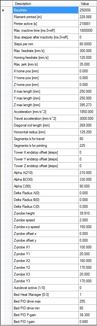

I noticed that on the first layer the machine had trouble printing the perimeter lines at the extremes of the X-axis. I guess I should have stopped it, but I wanted to see how it would go, since the model didn't need to be perfect anyway. As soon as I can get back to the machine, I'll put up my EEPROM settings. Maybe there is something I'm not seeing.

Here's my EEPROM settings.
