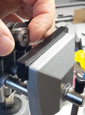

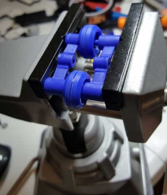

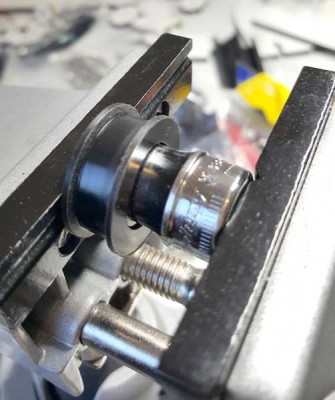

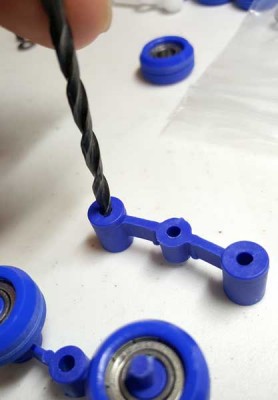

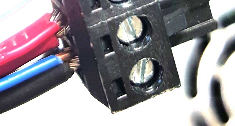

Re: [02Dec15 - Rostock MAX v2, 4th Edition Manual
Thanks for the great guide, it was easy to understand and follow.
I have a couple of comments though, and I don't think these has been mentioned yet.
1. 12 Gage wire needs some more consideration. It seems that 12Ga is the max capacity, and sticking another 18Ga multistrand wire may not be very desirable. Perhaps, a solidcore 18Ga (smaller diameter than multistrand) could be used, or (a better solution) additional 18Ga wires could run from power supply to the RAMBo connector. 2. Pages 52-54. Fan screws 1.75" are just a little too long, and so are the screws for the power switch.
3. Page 56. I would not recommend using the back of a screwdriver to press bearings! Those backs are rounded to fit a hand and will press on the center ring of the bearing. A simple plastic adapter should be supplied for this task (ideally), but a suitable socket will work. A small wise with plastic lips is very handy. Lips are parallel and will press the bearing straight in. 4. Page 89. The sleeves I had in my kit did not have a lip as shown on the picture. So, it was a little confusing.
5. Pages 91-93. Assembling the rollers is so much easier if you chamfer the the holes first. A little twirl of a drill bit without any pressure is enough. Using a small wise also made the assembly a breeze. Again, the key here is that wise make assembly parallel.
6. This could be a matter of preference, but a silicon tape (cold shrink) could be used instead of wax string for wiring.
7. I've seen some debates here regarding Onyx wires being only 18Ga. I have not got to it yet, but my max bed temp is 85C, so eventually I will have to try upgrading the wires (the cheap solution first).
8. It would be so nice if little wire labels were supplied with the kit, I do not have a good handwriting
Thanks, I hope that somebody could use my ideas.
