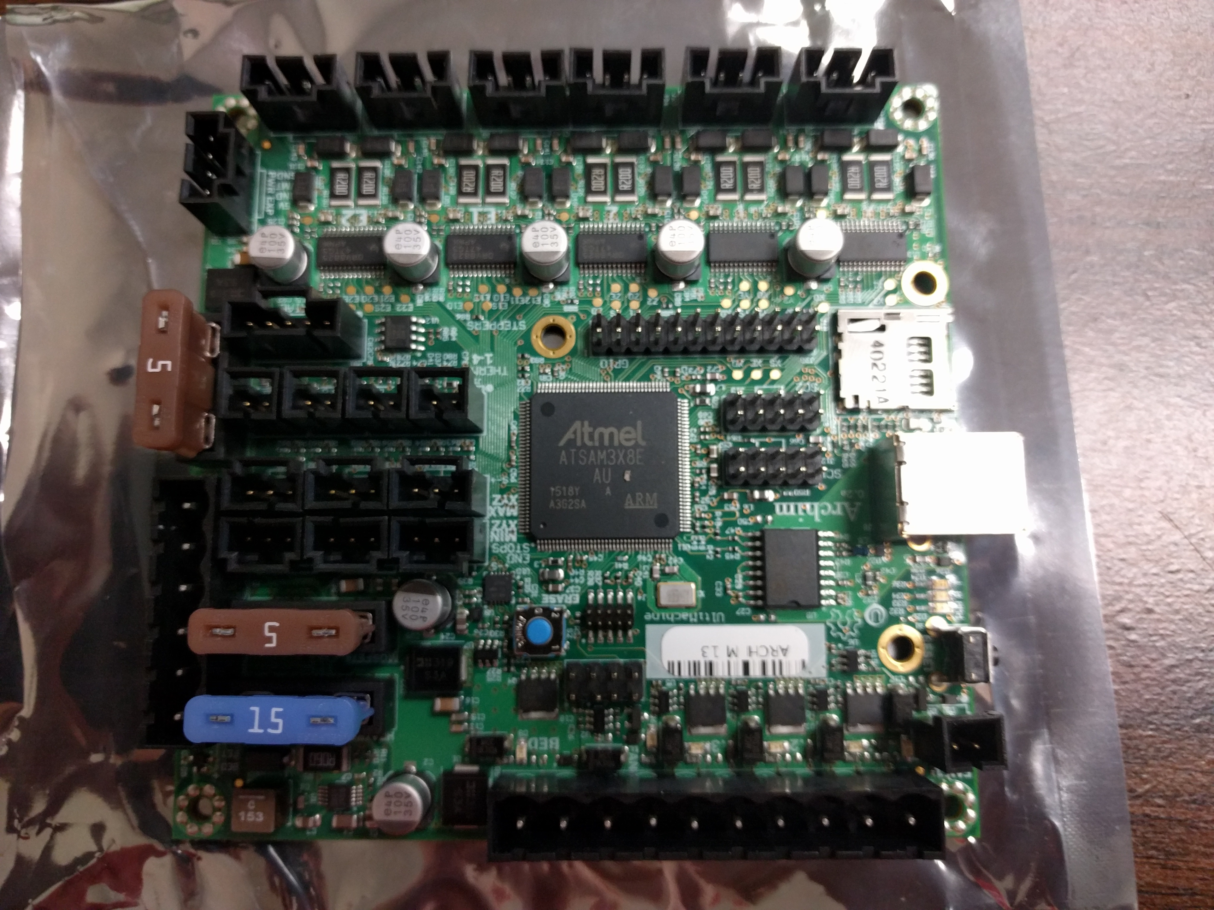

Ultimachine does have this guy in the wings...
So perhaps there IS a board change in the works with SeeMe...
Just to make it easy...
No, you can't have it. No, I haven't gotten it up and printing yet. No, I don't know when it's coming out or how much it will be.
But I can let you know as soon as I know
Re: web based Delta printer least-squares calibration calcul
A very handsome ARM board, looks like it could make a nice upgrade.cope413 wrote:Ultimachine does have this guy in the wings...
