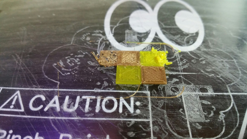

Posted: Fri Mar 11, 2016 4:53 am
by 626Pilot
Just got done installing my Chimera. I'd like to switch to the Kraken soon, but I'm not going to bother unless and until I figure out this mess:
Has anyone EVER got a 2-color print out of a Chimera, or a 2+ color print out of a Kraken, that didn't look like unmitigated trash? I said it before, so apologies for repeating myself, but I have NEVER seen a photo of a 2+ color Kraken print that didn't look like it belonged in the sewer. I'm starting to wonder whether anyone has ever been able to print something decent-looking with one of these, other than only using one nozzle at a time.
