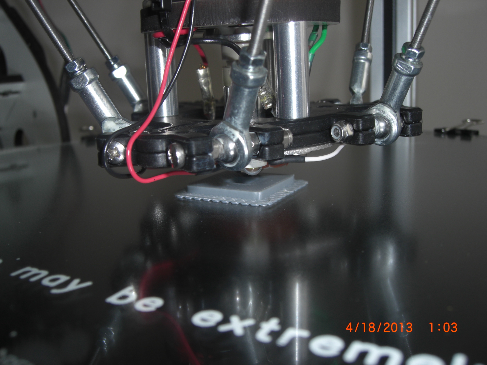

protyping the new china made arms
Posted: Tue Apr 16, 2013 5:46 pm
by cambo3d
can't wait to try these out, so far I see no play in the ball ends and best of all no sanding required. http://forum.seemecnc.com/viewtopic.php ... =260#p9878
i'm using 3mm x30mm Length screws and 3mm lock nuts to attach them onto the rostock platform

How come you ordered from China instead of going with the trick laser arms? Do you have more pictures of the print or the finished product?
Re: Another rostock max build
Posted: Wed Apr 17, 2013 3:10 pm
by cambo3d
aerouta wrote:How come you ordered from China instead of going with the trick laser arms? Do you have more pictures of the print or the finished product?
I had both sets coming to try but so far these china made version is working great, the print is still cookin, will post another update when done.
update: probably my best cal cube so far. still need to do some more tweaking to my flow rate. to the get the towers in between the windows to line up a lil better. Is that what what I need to adjust to fix that?

by aerouta
looks very good

Are these arms worth the coin?
Posted: Thu Apr 18, 2013 2:35 am
by cambo3d
rs50pilot wrote:Are these arms worth the coin?
was worth it to me, didn't have to spend hours sanding and it improved my print quality also

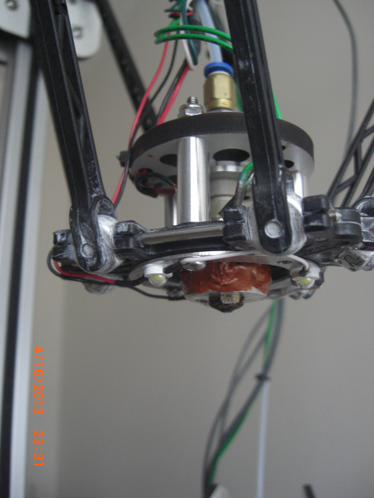

cambo3d wrote:leds mounted using thermal adhesive epoxy, on my custom cut aluminum heat sink http://forum.seemecnc.com/viewtopic.php ... =260#p9718
50ohm pot wired along with 10ohm fixed resister, and on/off switch
how it looks on the platform all wired up. If I make another, it will be made of pcb material so the wiring and led will be integral part of mount.
powered up turned all the way down dim
powered up turned all the way up bright
IF ANYONE WANTS AN LED MOUNT LIKE THE ONE I MADE JUST SEND ME A PM, I DONT HAVE ANY STOCK TO MAKE THEM AT THE MOMENT BUT I'LL BE MORE THEN HAPPY TO GET SOME.
EDIT: I'M NOTICING A LOT OF FLICKERING WHEN THE RAMBO IS DOING ITS PID ROUTINE, SO I ORDERED A BETTER VOLTAGE AND CURRENT REGULATOR TO ELIMINATE THIS PROBLEM.
I am trying to learn so I have a question, what would happen if you disabled PID?
If you wanted to keep PID where would you place the voltage regulator, on the output of the power supply or the input to the LEDs?

[quote= I am trying to learn so I have a question, what would happen if you disabled PID?
If you wanted to keep PID where would you place the voltage regulator, on the output of the power supply or the input to the LEDs?[/quote]
its small you just place it inline with the power going to the leds, if you disabled pid it wouldn't flicker it just would go dim and bright when the board starts its heating routine.

Posted: Thu Apr 18, 2013 10:36 am
by Eaglezsoar
Now I am beginning to understand, you are taking the power for the LEDs from the power connection to the Hot End. As the current to the Hot End varies, the LEDs also receive varying
current thus the dimming. On the same note, you are running your Onyx from 24 volts - the output from the Rambo heatbed connector is the input to an SSR that controls the 24 volts to
the Onyx. In the case of the Onyx, would you want to disable Pid for the HotBed so the input to the SSR is a more stable on or off?
Posted: Thu Apr 18, 2013 10:42 am
by cambo3d
yes thats it, the problem is that 12v power comes from the same power source that hot end uses. so it flickers because the power can't maintain constant voltage/current. If you put it on a separate power source it wouldn't be an issue but then i'd have 3 power sources..
pid gives you more stability in the heating cycle then just regular on off control. SSR's are used for heating circuits quite often with pid controllers, there no problems doing this.
