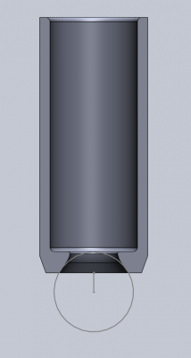

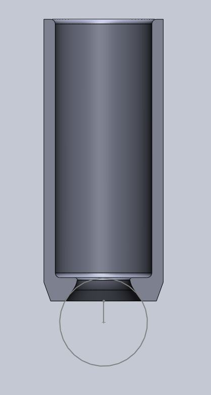

I only sent that as an example pic so that you would clearly see what I had used. Home depot does sell them in the exact same diameter as the magnet and arrow shaft.
The deeper part of the cup faces the ball of course.
And yes, you have it right however I have moved away from using the heatshrink tube and moved to using the kapton tape covered in plumbers goop because it has better adhesion and staying power. The shrink tubing seems to relax after a bit of use and it's proximity to the hotend.
The kapton tape wrapped many time stightly around the whole works serves to provide strength and hold everything in place. The plumbers goop servers to protect it from unwrapping and allows you to use light lubricant on the cup and balls without loss to the assembly strength by weakening of the glue.

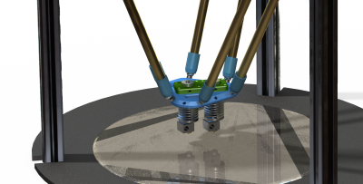

Hi Gang!
I've been really fascinated by the magnetic arms since I first saw the BarryBot. I've researched for a year and am building my first Delta. In fact I think most of my electronics and motors get delivered Monday!!!
I have a request, if someone can help me out. At the moment I do not have access to a 3D printer. I was wondering if someone here who has printed several iterations of the end effector, carriage adapters, etc, might like to donate a set to the cause. Mainly just the plastic printed parts. These can even be less than perfect versions. I just want to get up and running, then I can print new parts if needed. It's the chicken or the egg scenario. I need some printed parts to be able to print, but can't print until I have the parts.
I think I'm at about 90% there on everything. I really think the magnetic route is the way to go. I'm excited to start getting printing and learn first hand. I have so many ideas I'd like to try designing and printing.
PM me if you may bew able to help me out.

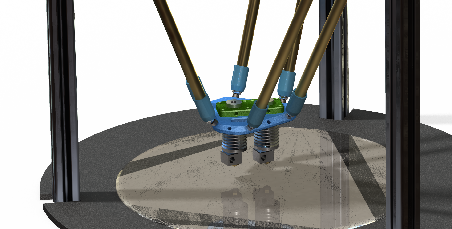

I've been using magnetic arms since last July. I designed my own effector plate and joint cups; the joint cups use a cylindrical fit instead of a spherical fit because it has less surface area to mess up. I printed mine with trimmer line nylon because it's cheap and has a lower coefficient of friction than ABS or PLA. I also put PTFE grease in the cups, but I don't know if it's made a difference or not.
I just glued my chrome balls into the cap screws with loctite glue, and I've never had a ball pop off. It's strong enough that I can screw the cap head screws into the un-threaded nylon effector plate by twisting the chrome balls (all of the torque is on the loctite glue).
I'm hoping to get a few CNC machines this summer so I can make kits for 3d printers with this kind of stuff. I'll definitely make Teflon (PTFE) ball joint cups with a lathe for a precise, low friction arm system.

Check out the cross sectional view of my cup design. I use 0.42 inch (10.5mm) brass rod arms for more rigidity, so my cups are slightly bigger than xnaron's.
Check out the Tri hotend!

For now here is a picture of how it all looks. The magnets are 3/8th by 3/8th inch (9mm or 10mm should also work). The 7/16th (0.4375 inch or about 11mm) brass tubes were about $3.00 each, I got them at an Ace hardware store.
Magnets - $20 ish
Brass Tubes - $20 ish
Printed parts - $1.50 ish
If I were to offer a $170 pre-assembled complete kit similar to what's shown in the image above but with a triple extruder (that doesn't exist...yet) would anyone be interested? This would likely be sometime around June, but no guarantees.
Magnets - $20 ish
