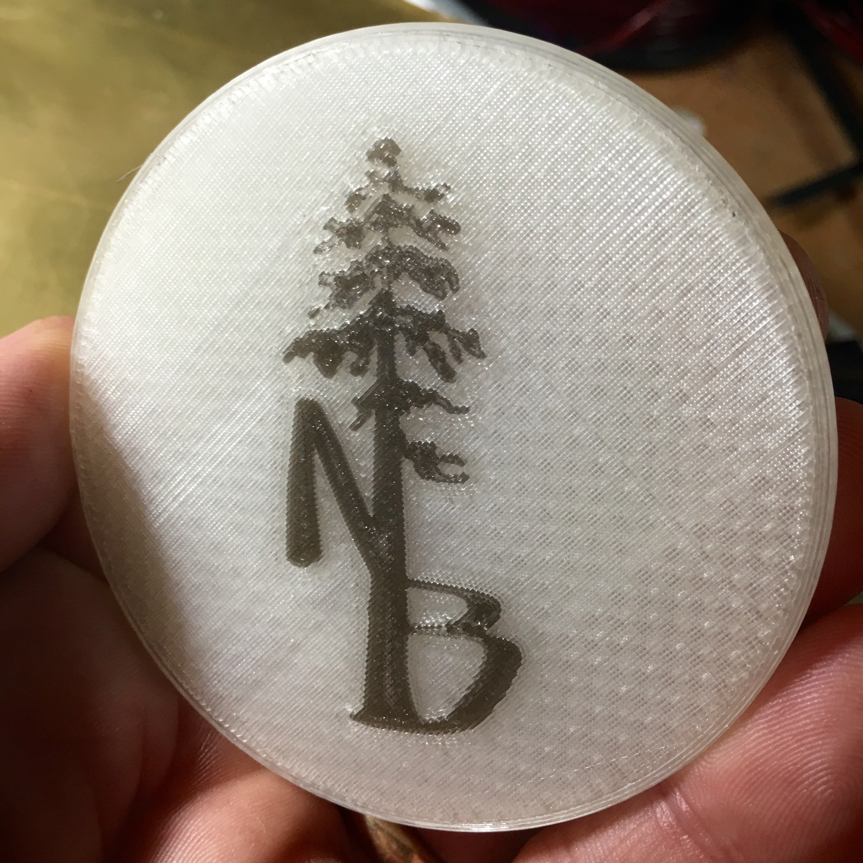

by mhackney
I gave up too, I was able to print in 4 colors but it was no where close to reliable. That is not a fault of Kraken, it's a number of factors:
1) multi nozzle printing requires PERFECT calibration. This is very difficult to attain. The Cartesian guys seem to have more success. The reason is that it is very easy for one of the nozzles to snag and drag a layer
2) you must have near perfect extrusion
3) you must absolutely NAIL getting a perfect first layer. This is much harder to do when you have multiple nozzles dragging around over the part.
4) most slicers really don't provide the tools needed to do multi color printing
I am becoming a fan of switching hotends like Cyclops and Diamond. They address 1-3 above. Slicers are an even bigger challenge for them though as they do not give the control needed for switching from one color to another. At some point they might but that's pretty far off (>year at least). I'm talking about advance switching controls like burying the color change in the infill of a part, etc but even the simple priming towers and skirts are primitive. But I have been able to RELIABLY print some pretty sophisticated 2 color parts like this:
