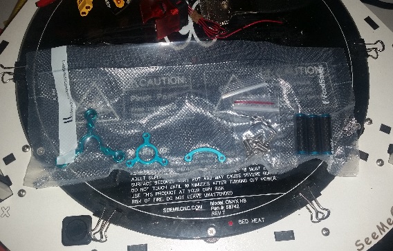

I am searching for some good unbranded vacuum packaging still. But I felt it was the best way to package the mounts and make sure they did not get scratched in the mail and still allow for the variety of components to be packaged up with ease. The labeling on the bags drives me mad, but it does work very well. Looking forward to your thoughts on the mounts when you have time and also looking forward to seeing the new manual and waht new treats you guy shave cooked up for everyone to cause a rewrite!

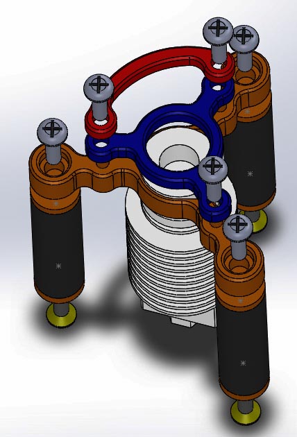

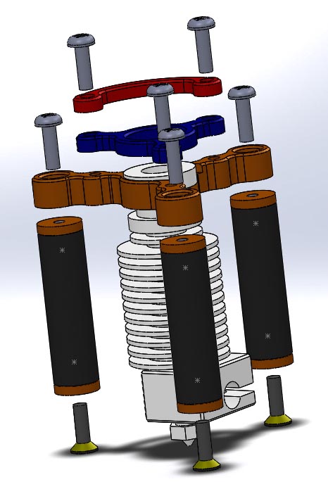

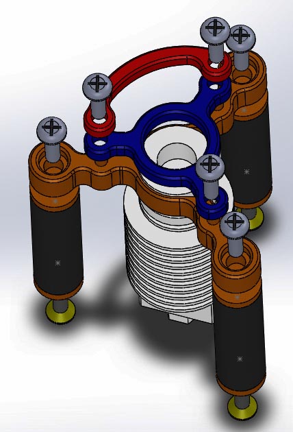

My Code Monkey is going to update the site shortly with assembly instructions for the mounts. These are the renderings of the mounts and screws. There are 3 flat head screws (cone shaped under the head) with each mount and 3-6 pan head (slightly domed shaped head). You can put it together how you like best, but I include the flat head screws so the mount is centered in the effector plate mounting holes by the cone of the flat head screws. Again it is a matter of preference overall and does not effect performance really. These renders will be updated to the website shortly.

travelphotog wrote:My Code Monkey is going to update the site shortly with assembly instructions for the mounts. These are the renderings of the mounts and screws. There are 3 flat head screws (cone shaped under the head) with each mount and 3-6 pan head (slightly domed shaped head). You can put it together how you like best, but I include the flat head screws so the mount is centered in the effector plate mounting holes by the cone of the flat head screws. Again it is a matter of preference overall and does not effect performance really. These renders will be updated to the website shortly.
I found that the pan heads didn't really want to seat down through the mount into the carbon fiber stand off, but the flat heads drop in just fine.

Do they seem short for some reason? The pass through hole was left oversized to make sure they would fit OK. But it is really which ever way works best for your setup
DSteck
Posts: 39
Joined: Sat Sep 05, 2015 8:34 pm
Post by DSteck »
The pass through fits cleanly, but the counterbore doesn't seem large enough in diameter.
travelphotog
Posts: 398
Post by travelphotog »
DSteck wrote:The pass through fits cleanly, but the counterbore doesn't seem large enough in diameter.
Hmm Ok I will double check the toolpaths on the next batches.
travelphotog
Posts: 398
OK I went back and checked some mounts I have here.. We did a few runs that tanked ( which became color samples ) and right after that the two runs of mounts that just went out. It looks like those sets of mounts which should have a mount hole countersink hole size of 6mm, turned out at 5.77m or so instead which is just enough to not allow the intended pan head screws to fit the countersunk holes. The flat head screws are the same length ( 10mm ) but are about .25mm smaller in head size, which lets them set into the countersink hole. If anyone feels that switching these screws from top to bottom spots is an issue, please contact me at [email protected] and I can arrange to get you a mount with the correctly .2mm bigger top countersunk hole size so the pan head screw will fit instead of the flat head screws. I am tracing this back to find where the spec got changed at and to make sure it does not happen moving forward. Coming off the CNC mill and being the ( I thought ) same CAD model, I missed checking each batch for this countersunk hole size. We checked hot end fitment, but dropped the ball on checking the hole size in question as .2mm was too small to not stand out as being off. Lesson learned.... Again if anyone has an issue, contact me at [email protected] and I will arrange for a new mount to be sent out and send a return label for the bad one in exchange.

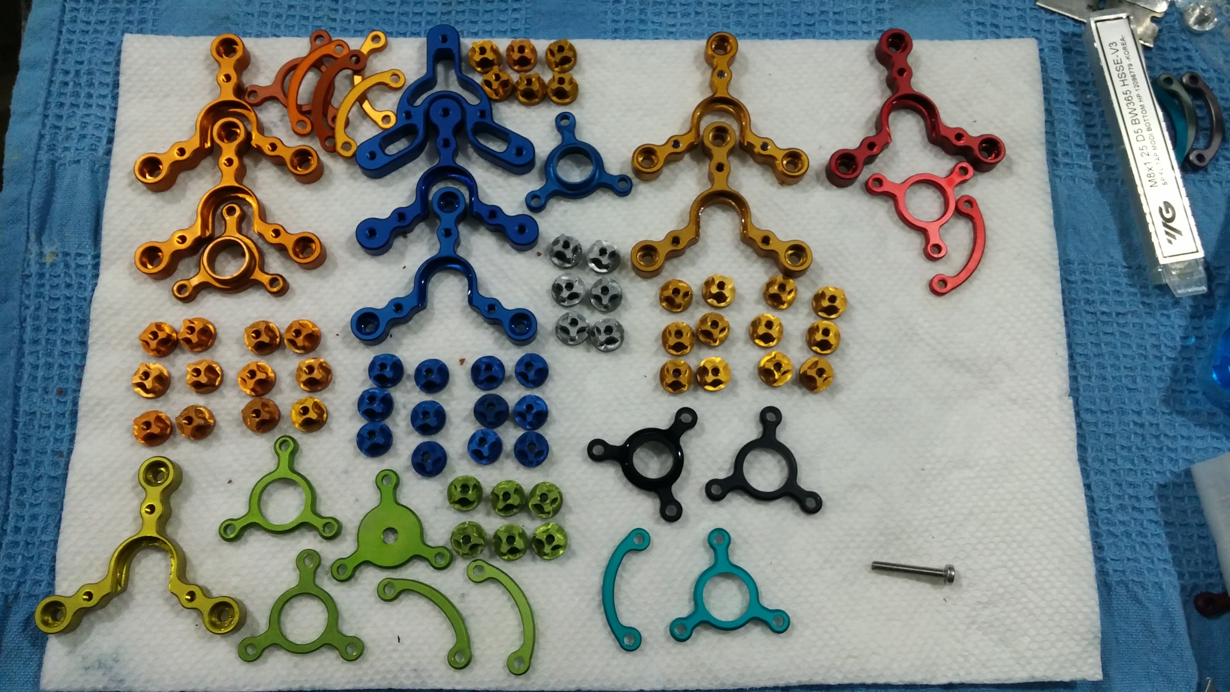

So I just have to put finish putting together the carbon fiber spacers and all the current orders will be complete at last and shipping out!! Today / tonight was a FULL day of milling and anodizing. I have a bit more carbon fiber to cut in the AM and then the epoxy needs to cure before we package up and mail them out. A few package will post tomorrow and ALL outstanding orders as of 2am 10/30 will post by Saturday at latest so the epoxy can cure in the last of the spacers. REALLY looking forward to having all orders out the door and relaxing a bit this weekend (like that will happen). Thanks to everyone for the great response!
Here is a sneak peek at the final anodize run from tonight. The afternoon's items are already in their bins and waiting on these guys to join them tomorrow!
