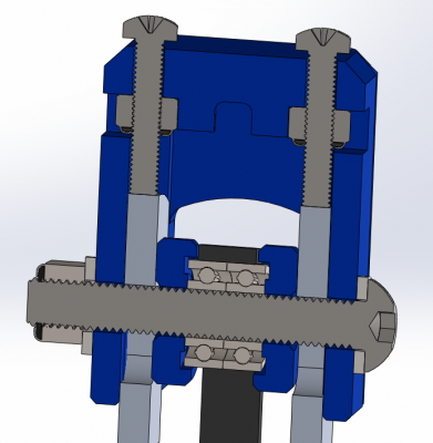

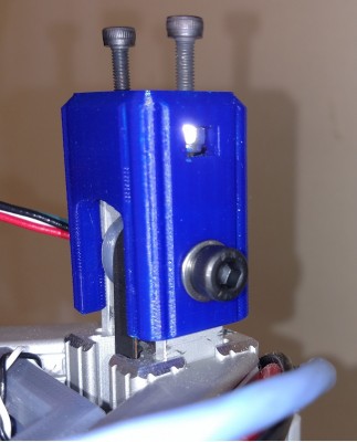

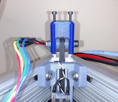

				Time for an upgrade... I've always had difficulty fine tuning belt tension.
I've designed and tested a simple tensioner that slips over the tops of the idler brackets and lets you use a pair of jack screws to fine tune the belt tension.
You will need to replace the existing idler screw with a 5mm x 35mm screw of your choice.  You will also need a pair of 3mm nyloc nuts and 3mm x 16 mm screws of choice.  You can use set screws as well.
I've shown pictures with use of my own idler hubs, but they should work just fine with the idler bearing setup that Brian provides.
Files are located in the part repository (Tensioner Cap.stl) in my signature.
Enjoy!
-  X - Section
-  Installed - Front
-  Installed - Side

ccavanaugh wrote:Significant progress this weekend.
The electronics housing as designed needs some tweaks.  I need to deepen the housing about a 1/4" to clear the LCD controller.
When assembling, reclaim the 4-40 t-nuts from the v1 skates or the plate the heated bed threads into and install those into the underside of the snowflake.  You can then use 1/2" 4-40 screws to secure the heated bed.
				Posted: Mon Dec 07, 2015 6:29 pm
				by ccavanaugh
				DarrenAnton wrote:In this Picture you have some end stop wire holders clips that are in the metal frame where can we get them? I do not see them in the downloaded 3D parts file
Thanks!!
A model from Thingverse... link is below.

ccavanaugh wrote:Time for an upgrade... I've always had difficulty fine tuning belt tension.
Enjoy!

				ccavanaugh wrote:DarrenAnton wrote:In this Picture you have some end stop wire holders clips that are in the metal frame where can we get them? I do not see them in the downloaded 3D parts file
Thanks!!
http://www.thingiverse.com/thing:166532
That part looks nothing like the part that you created to hold your end stops and have pictured in your image labled installed front.
Sorry to be a pain in the butt, that part is important and I have no cad skills at all.
				Posted: Wed Dec 09, 2015 12:57 pm
				by ccavanaugh
So
Sorry Eagle,  I'm as a loss.  I wasn't able to find a different picture labeled "installed front".  The Thingverse part snaps into the extrusion grooves and holds the wire in place.  At least that is what I thought the question was...
				Posted: Wed Dec 09, 2015 3:26 pm
				by Eaglezsoar
				This is the picture you posted and the light blue part next to the red "arrow" is the part that supposedly not part of your STL files.
				Posted: Wed Dec 09, 2015 5:27 pm
				by DarrenAnton
				Yes, that was what Darren was after, the wire clips. Download it, but have not printed some yet
Big Thanks for that!
				Posted: Wed Dec 09, 2015 5:32 pm
				by DarrenAnton
				That file is in the Download its called "Top Vertex.STL"
Eaglezsoar wrote:This is the picture you posted and the light blue part next to the red "arrow" is the part that supposedly not part of your STL files.
				Posted: Wed Dec 09, 2015 5:52 pm
				by ccavanaugh
				If in doubt what a file is because of my poorly named file
 , you can click on the STL file in Github and you should be able to see a 3D rendered image of the file.  I know it works with Chrome, but I've not tested other browsers.
				Posted: Wed Dec 09, 2015 8:49 pm
				by Eaglezsoar
				Thanks for everyone's help for identifying that part.
