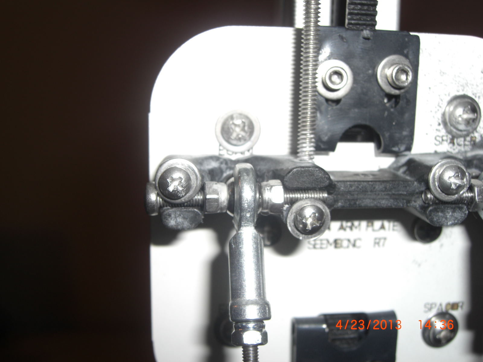

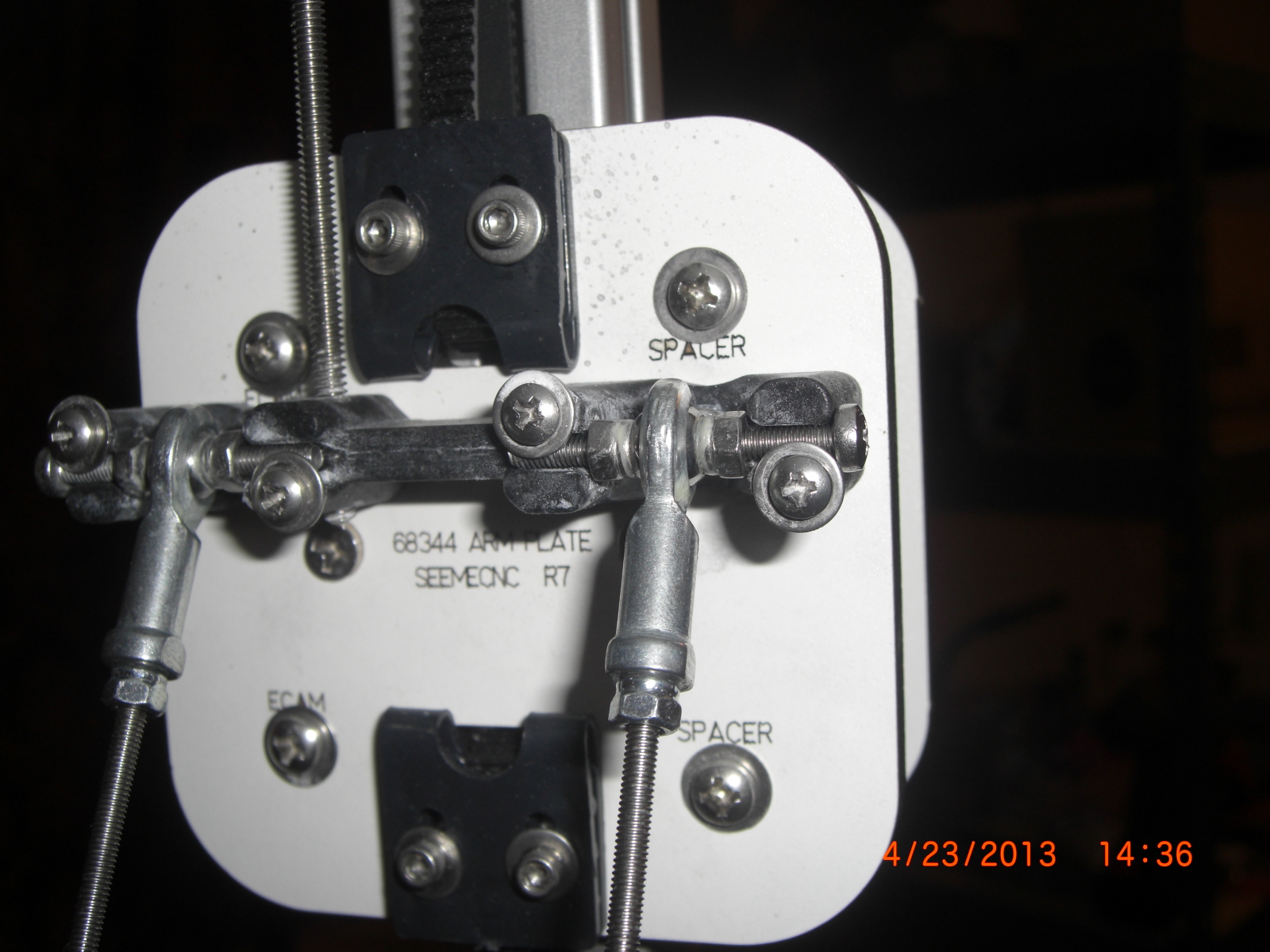

I used the two locknuts to center the arms and hold them in placeEaglezsoar wrote:Do you have a picture of those metal arms where they attach to the cheapskates? I would like to see how they
are attached at that end.

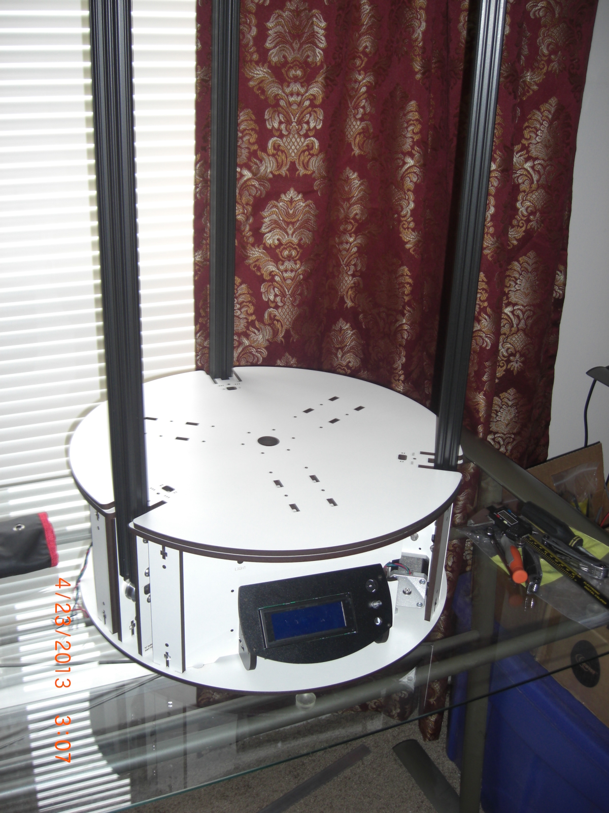

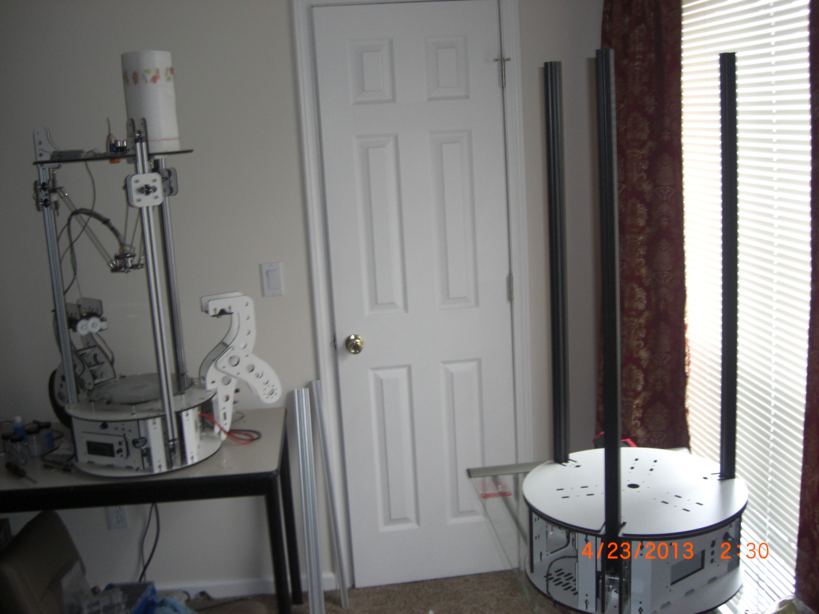

tl-1 starting to take shape,
waiting on a few things to arrive but making on progress on the third build. (well actually 2nd build, the first build i had to dismantle and rebuild due to bad parts)
I added longer extrusions for some upgrades I had planned to test out.

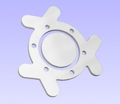

magnetic end effector mount for hotend
teaser of some more things i've been tinkering with.

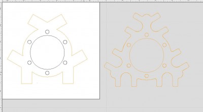

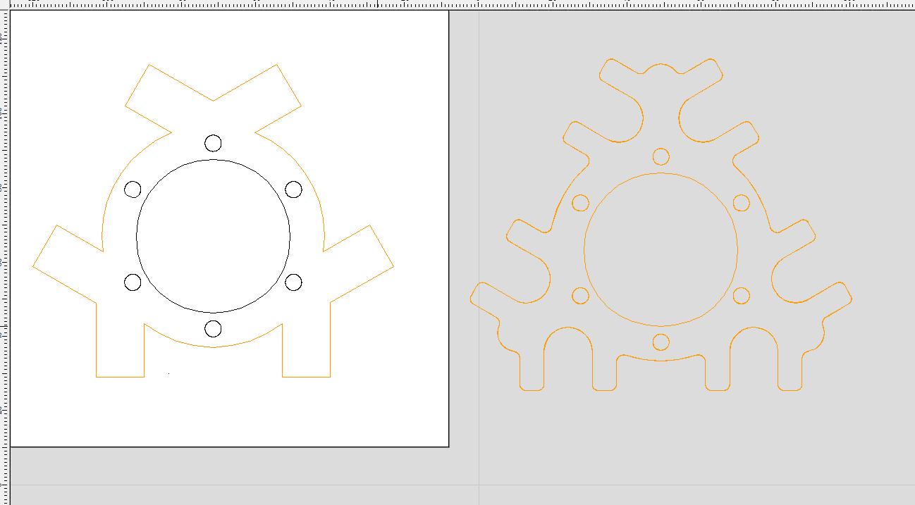

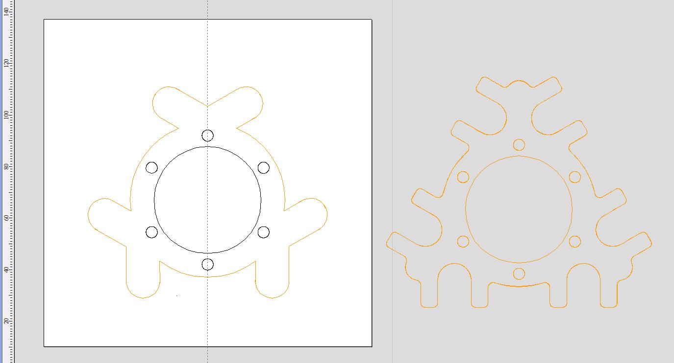

milled aluminum end effector / hot end platform prototype. Would anyone be interested? thoughts, comments, suggestions appreciated.
Planned on milling it out of 1/8" aluminum. Would you guys prefer to have holes in the tabs also?

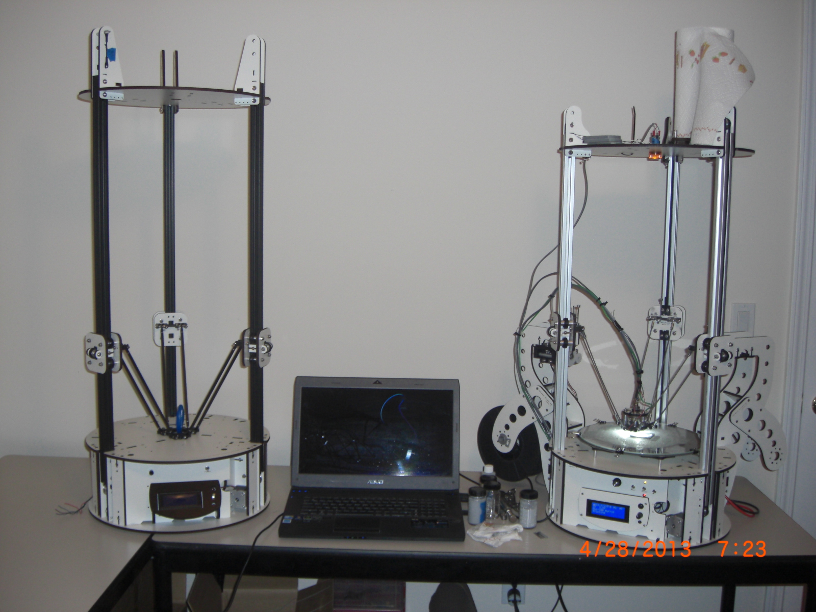

TL-1 comparison photos with some mods of my own
thought id show off my other build side by side,
tricklaser lightweight arms,
longer extrusions in black
hall effect endstop switches
testing custom turn buckle belt tensioner
testing mic6 with 24v silicone heat pad
testing all metal hotend
testing direct mounted extruder

Cambo3D, when you mounted the new arms, I noticed that you used nylon lock nuts that were upside down. The nylon screwed into the screw first instead of the base of the nut.
Try as I will, I cannot get a nylon lock nut to screw onto a screw backwards such as you did. Could you tell me how to do that?
Carl
Carl
Re: Another rostock max build
you need to thread it first. I did this by screwing the bolt into the nut the usual way until it came out the other end. this starts the thread in the nylon.Eaglezsoar wrote:Cambo3D, when you mounted the new arms, I noticed that you used nylon lock nuts that were upside down. The nylon screwed into the screw first instead of the base of the nut.
Carl
then unscrew it and put the nut on backwards.
