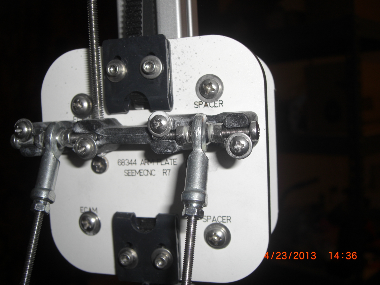

Eaglezsoar wrote:Do you have a picture of those metal arms where they attach to the cheapskates? I would like to see how they
are attached at that end.
I used the two locknuts to center the arms and hold them in place

Cambo3D, when you mounted the new arms, I noticed that you used nylon lock nuts that were upside down. The nylon screwed into the screw first instead of the base of the nut.
Try as I will, I cannot get a nylon lock nut to screw onto a screw backwards such as you did. Could you tell me how to do that?
Carl
Re: Another rostock max build
Posted: Sun Apr 28, 2013 7:26 pm
by cambo3d
Eaglezsoar wrote:Cambo3D, when you mounted the new arms, I noticed that you used nylon lock nuts that were upside down. The nylon screwed into the screw first instead of the base of the nut.
Carl
you need to thread it first. I did this by screwing the bolt into the nut the usual way until it came out the other end. this starts the thread in the nylon.
then unscrew it and put the nut on backwards.
