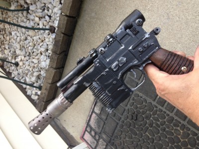

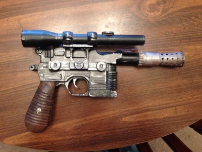

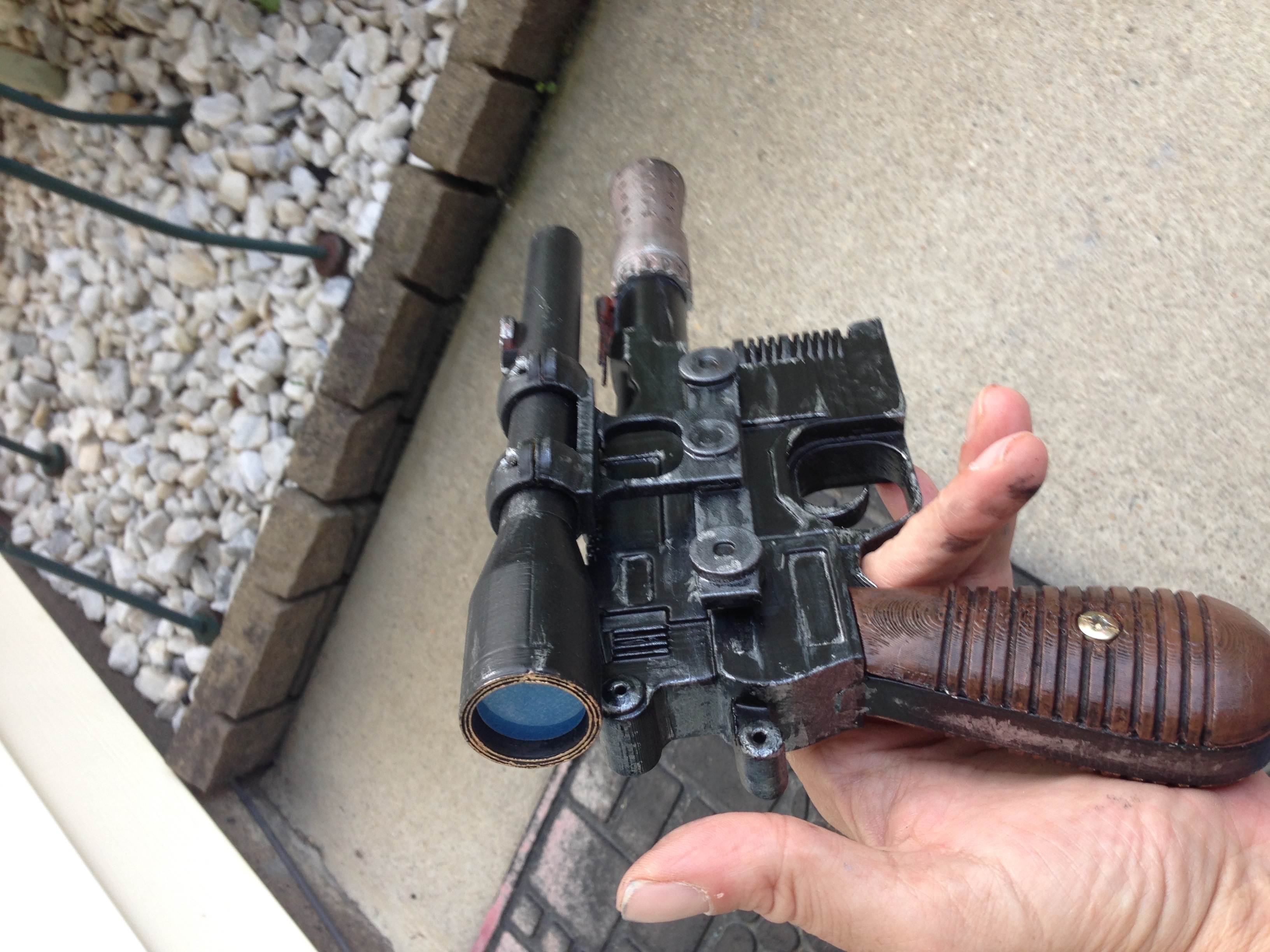

Just a quick update on the very first thing I've ever made with a 3D printer. Finished it this morning. I know this isn't a maker forum and I'm not going to flood with pics. but I seem to recall someone wondering what we would make with the new Eris. Here's what I made with mine...  Thanks for an awesome printer guys...
