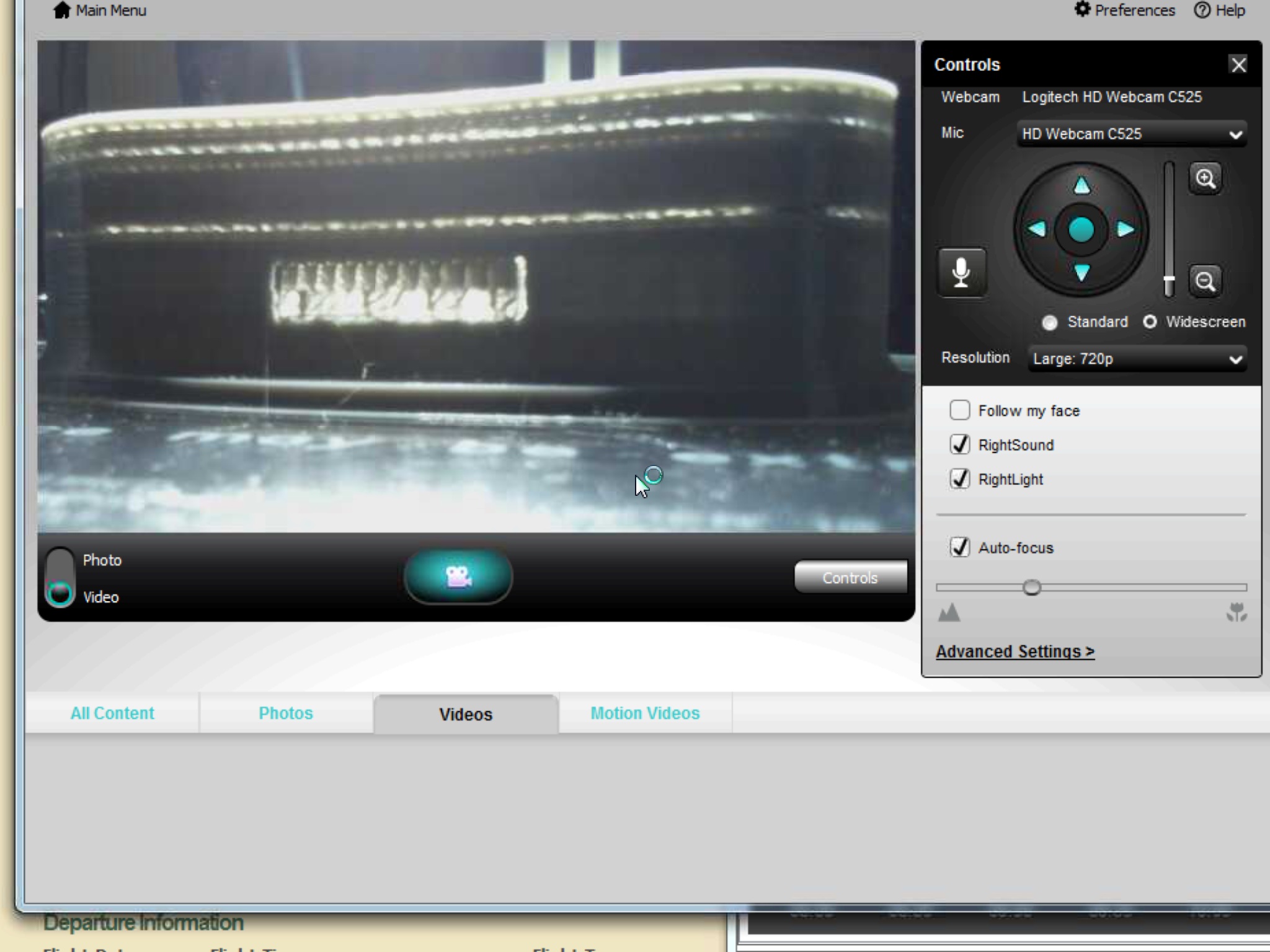

As anyone had issues with long PLA prints with the v5 hotend? I just replaced the heat break, heater block, and nozzle. I was able to bring the print temp down to 190 however after about 4hrs in I started to get the popping sound out of the the extruder.
I have attached a photo of the last print with the new components. I really thought I had things fixed. I thought I was extruding too much plastic so I brought the flow down. And that did not seem to help.
Sorry for the bad picture, it's taking for a webcam. When I walked away from the print everything seemed fine.

I've had several 6-8 hour prints and many 3-4 hour prints with PLA with no issues. I will say, if you change a nozzle, you still have to do the 300°C install treatment. I had an issue after I moved to a .7mm nozzle and did not do that. After an hour or so, I started hearing the extruder skip steps and I was getting filament starving. I had a plug in the ever so slight gap between the heat break and nozzle that had opened up as site nozzle loosened.

I tightening the heater block against the heat break and the nozzle against the heater block all at 275. I tightened them pretty nice and snug.

aerouta wrote:I tightening the heater block against the heat break and the nozzle against the heater block all at 275. I tightened them pretty nice and snug.
hold up!
the nozzle should be tightened against the heat break only at temp, the heat break to the cooling fins should be snug by hand.
maybe i misunderstood?
I think you're correct. The nozzle should NOT be snug up against the heater block. And the manual says to do it at 300C not 275C!

My firmware only allows up to 275.
Any suggestions to solve the filament starving/clogging issue? It only happenings on long prints.
Re: E3D V4 All metal hotend
Have you correctly assembled the nozzle and heat break and tightened them at 300°C as per the instruction sheet? It is imperative that you do so or you could have the sorts of problems you're reporting.
