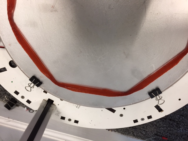

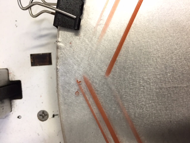

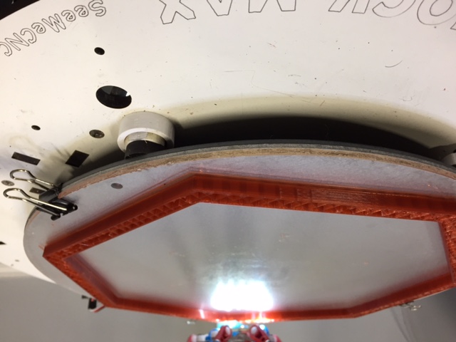

Re: Duet setup - instructions in progress
largest footprint I have been able to print.
Though the first layer was not perfect. Depending on which direction(clockwise or counter clockwise) these loops where made changed the location of the thin area. Any clue what may cause this. My first though was hysteresis in the head movement. Does the Duet have the ability to have hysteresis settings?
Yes, you have some slop in your motion mechanics somewhere. It could be simple like loose belts or a loose stepper pulley or it could be sloppy arm joints. But something is not tight. Duet's RepRapFirmware (dc42) does not have backlash compensation. Sometimes reducing your acceleration values can help with this. In config.g:
