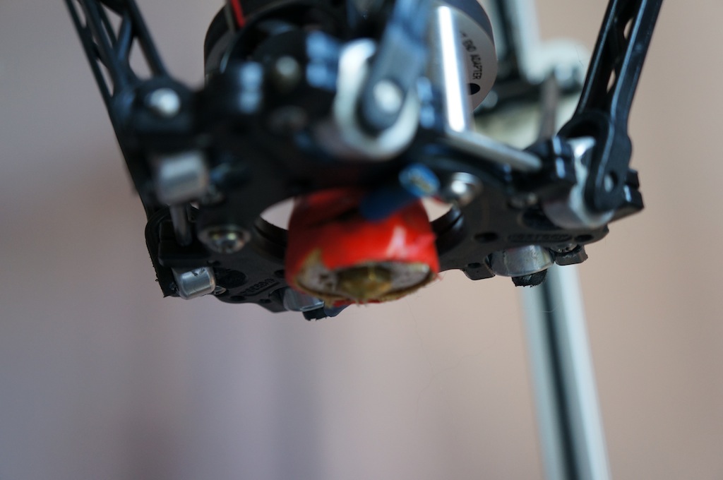

I'm going to try wrapping my hot end in silicone tape to see if I can prevent the same issue that xnaron has - we're both running the same squirrel cage layer fans.
Re: Mhackney's Rostock Max
I know the RepRap crew wrap their JHeads in insulating tape and button it up with Kapton.
This is my 1000th post here! Wow, time flies.
I have silicon tape around my heater block to help prevent excessive cooling from the fans, and it works very well.
I used the silicon tape because it's what I had handy for high temperature tape.
Can you post a picture of it?Polygonhell wrote:I have silicon tape around my heater block to help prevent excessive cooling from the fans, and it works very well.
The blue thing is the crimp I used to connect the resistor wires together, I basically cut a slot in the tape to accomodate the wires.xnaron wrote:Can you post a picture of it?Polygonhell wrote:I have silicon tape around my heater block to help prevent excessive cooling from the fans, and it works very well.
The somewhat untidy trimming at the bottom is because I originally put the tape on when I had the longer original nozzle and when I swapped out the nozzle I had to trim the tape.

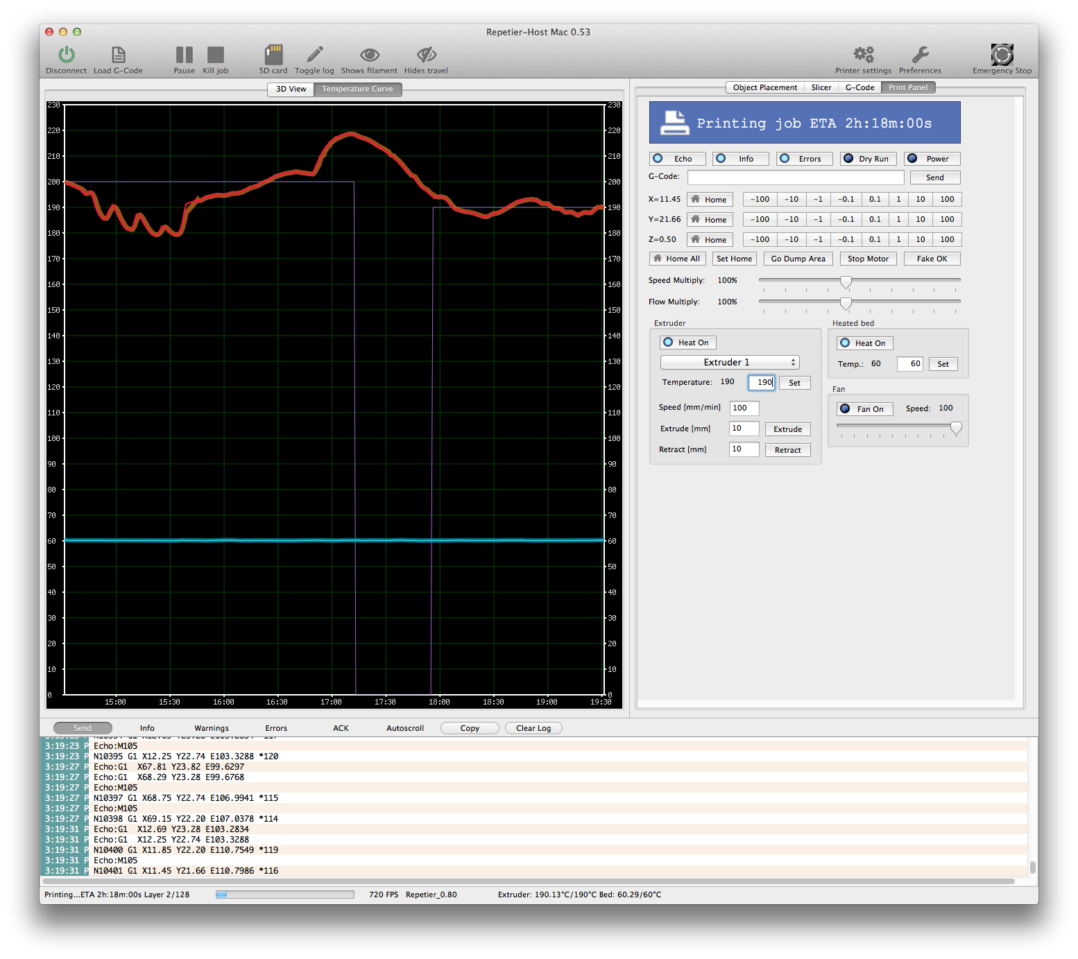

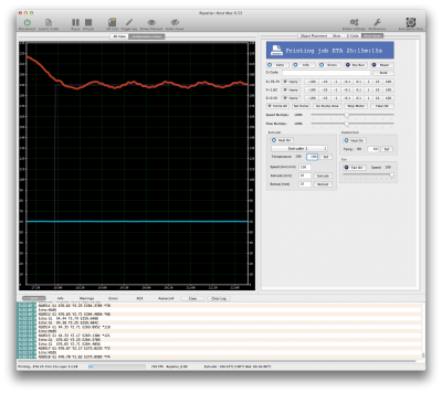

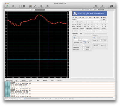

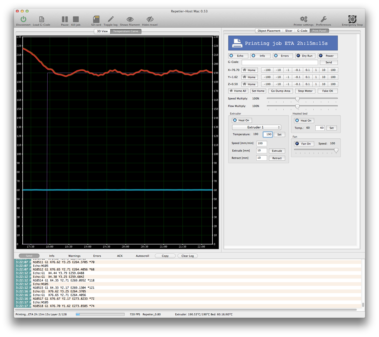

Odd hot end temp issue
I was printing today and noticed the hot end temp fluctuating wildly as seen here:
I shut off the heat because I thought I was on my way to a meltdown. I checked the wiring while it continued to print during the cool down and all seemed ok. So I set the temp to 190°C and turned the heater on and now seeing this:
I usually have rock solid hot end temp and nothing like this oscillation. It's been oscillating like the 2nd screenshot above for 10 minutes now.
Time to check the thermistor and connections.
Are you running the hotend at 24V?
It's possible one or both are damaged, I'd check your resistance at the board.
If it's changed significantly then the PID values would be incorrect and you'd see what you're seeing.
I'd replace the resistors if they are damaged rather than rerunning the PID Autotune.
No and never did. This is a 12V cartridge. First attempt using Slic3r 9.9 - I am printing 2 objects on the platter, the ramp up or down happens when moving from one to the other! Need to look at gcode.
EDIT: and I did retune the PID for the cartridge. I will check thermistor connections. gcode was clean with respect to temps, and since I see the big change on rapid moves, maybe there is a loose connection. Maybe even the smaller cycles can be correlated to moves within the layers - they were very regular actually.
Yeah then GCode should be the first thing you look at, could be something odd in 0.9.9.
The other thing to look at is the potential of something applying significant cooling during the move.

I discovered my "wild temperature oscillation" problem. It was, as predicted, a loose thermistor. The silicone (Permatex Ultra Copper) had peeled off the hot end allowing the thermistor to slide in and out of its hole. An easy fix BUT if I was not attending the printer and the thermistor dislodged completely, a meltdown and fire might have ensued. So please be careful out there folks, and watch closely and don't print unattended.
