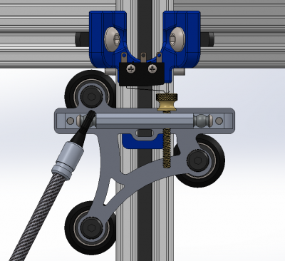

Posted: Wed Jan 27, 2016 6:23 pm
by ccavanaugh
I've updated the limit switch bracket with a new version that uses less material and frees up some space on the top rail.
The switch sits a bit lower to clear the assembly screws, but it still allows enough room for end stop adjustments.
It's available in the Git repo in my signature.
Version 2 of the limit switch bracket.
