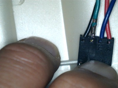

One thing about RAMPS - the connectors do not lock. I'm using the RAMBo connectors and they fit the RAMPS locations. But they pull out very easily. I need to decide if this is going to be my permanent solution or if I'll replace the RAMBo if I can't repair it. I'm also not happy with the connectors I assembled for the Rambo, there seems to be some fraying where the wire attaches to the crimp connector - probably from opening and closing the door the RAMBo was attached to too many times! You can see that here (attached to RAMPS):
[img]http://mhackney.zenfolio.com/img/s9/v87 ... 5524-4.jpg[/img]
Whatever I do, I will mount the board to a stationary location but make sure it can easily be removed for access.
I did get a nice wiring harness kit with the RAMPS that has the connectors professionally attached. I just don't relish re-wiring everything! The RAMPS does support dual extruders and RichRap has a cool mod to support 3 extruders. I also got these pre-assembled for $100 (bought 2) so they are pretty cost effective.

do you use the right size crimper for those connector pins. they shouldn't look like that if you did. But I assume you prolly used what you had available
the purpose of the back end of the connector pin is to crimp down the insulation too and provide some strain relief. The middle part of the pin is actually where the bare wire gets crimped. If you have the correct tool, it does this in one shot.
