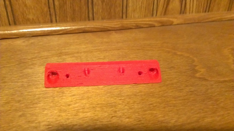

				Posted: Sun Mar 16, 2014 1:51 pm
				by xnaron
				Here is mine with 2 endstop holes

				Posted: Sat Mar 22, 2014 7:58 pm
				by joecnc2006
				xnaron wrote:Here is mine with 2 endstop holes
It printed perfect, I took off one of the exiting mounts and the stubs on the back fit right into place of the two mounting holes. Great Job.

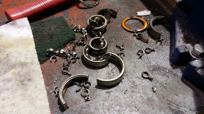

				by Tinyhead
				Progress so far on my joints:
			-  Tore apart a few 6206 bearings to get the sweet sweet 3/8" balls within.
Used some JB Weld and added some weight to keep the balls pressed tight.
I printed the arm holders...  but had something funky happen.  Maybe I had my wall thickness to big or something (never had the problem before), but it looks like it decided to only print the infill and not the outer layers!
There was only about 1/2 meter of filament left on the spool when I checked them this morning, so I'm wondering if the tightness of the spool curve was creating so much drag it was starving the extruder, or there was something wrong with my settings.

				by xnaron
				The key to making sure the balls stick to the screws is to heat cure them.  I stick them close to a desk lamp and let them heat up.  They probably get to 70 or 80C.
As for the printing issue...I use kiss for slicing.  I believe I was at 0.20 layer height and I set the number of loops to something high like 7.  With these I try to avoid the infill.  They are tricky to print right for sure.

				I tried dropping the ball and screw and pulling and twisting and so far I haven't been able to make it budge.  It's possible I've been lucky though.  I scraped the balls where they're attached and used a dremel to round out the tops of the screws a bit hoping to give a better grip for the weld.  I might try and see if I can physically weld a few together too.

				by joecnc2006
				I used the magnets with the Bearings, dipped the head in JB-Weld then attached the screw to the bearings, the magnet held them into place, Looks like you are using stainless cap screws so that would not work.
Then when they set a little bit I placed them in oven on 170° for 30 minutes it cured the JB-Weld then let sit for a few hours more (not the full 24 hrs), I can not pull the screws off the bearings at all.
I also got a 3/8" round nose bit and turned it by hand in the ends of the ABS Rod Ends and this took out any little differences in print and made the Bearings fully seat in the groves.

I did the same principle that you did Joe but I found a 3/8" stone for a dremel and ran that down the Rod Ends, worked great but you have to be careful not to grind the bottom.
