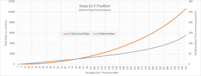

626Pilot wrote: I also noticed how ridiculously fast the carriages have to accelerate when the effector is furthest from them - they have to move several times faster than when the carriage is close. I wonder if the math doesn't get a little weird close to the very edge.
I attached the steps curve for a 265mm pivot - pivot rod moving straight out from a tower. If the software is trying to maintain a fixed XYZ motion speed it would definitely speed up the carriages. Speed should be about 2x when at 200mm as compared to speed at 100mm extension.
Steps curve for Y Motion

Z = ACOS((XSide^2+YSide^2-ZSide^2)/(2*XSide*YSide)) =ZAngle/2 =PI()-(ZBisect+XBisect) =XSide/SIN(ZCWAngle)*SIN(YBisect)
For values
X Side = 100
Y Side = 102
Z Side = 98
Tower Angle Bisect CW Center Angle Radii
X 59.6 29.8 120.8 58.210
Y 61.7 30.8 119.8 56.754
Z 58.7 29.3 120.8 59.69
Just a thought. Probably not worth a major code change to implement, especially since you have some testers already.
