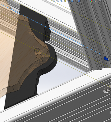

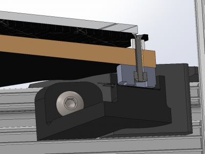

I'm been picking at a few improvements.
I've added a new heated bed insulator bracket (version 3) to the Git Repo. This version allows use of an unmodified snow flake and moves the mounting to the corners of the frame. It will accept a 4-40 nut underneath so the original screws may be used.
I pushed the spacing out to use the original holes and to make support of FSR brackets easier as I think more distance between loads improves the sensitivity of the FSR input.
I think mhackney's FSR mounts will now work with this, but it's untested at this time.
Open to suggestions...

Posted: Fri Feb 26, 2016 9:23 pm
by mhackney
Looks good, you could integrate the FSR mount pocket right into these. I'll probably go that route when I get to that point.

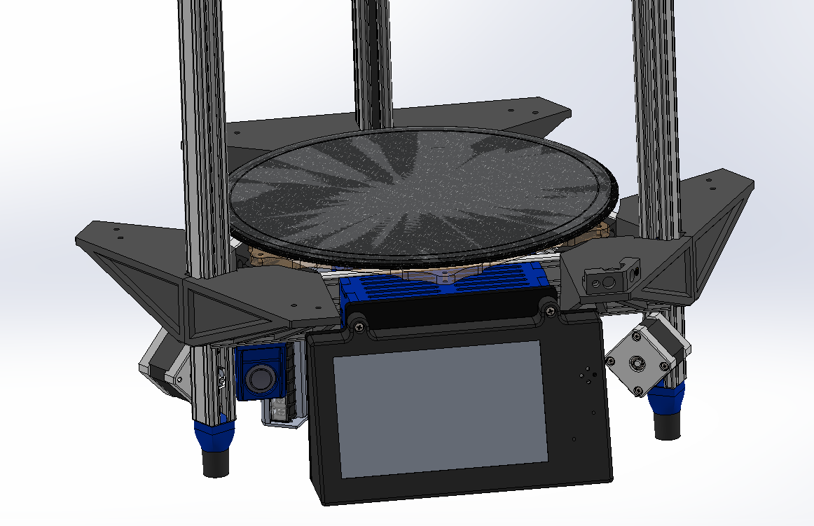

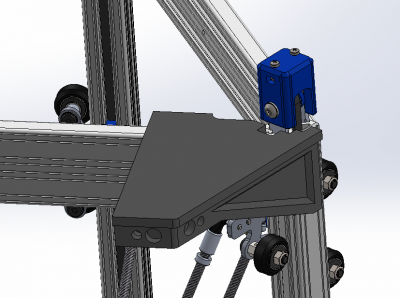

I've also been working on an Enclosure for the Duet and 7" LCD panel AND, brackets for enclosing the build area without reduction of print area. The heated enclosure is based around the same concept I think most people have gone to on the Rostock Max v2 kit. I'm leaving room for heat set threaded inserts and magnets to suit.
I've yet to run prints of the Duet housing and I've made a couple of test pieces of the heated chamber and I am down to final teaks.
The Duet enclosure also has a design with a blank cover for those who don't want to use the LCD.
If folks are interested, I will post the files now. I've not tested them yet myself, but thought that this would be good to spark ideas and suggestions for improvements.
WIP, Duet with heated chamber
Top of heated chamber
Posted: Fri Feb 26, 2016 9:33 pm
by ccavanaugh
mhackney wrote:Looks good, you could integrate the FSR mount pocket right into these. I'll probably go that route when I get to that point.
I've now figured out how to route the belt to clear my linear slides. I need to machine 6 "L" shaped replacements for the top bearing mounts. A smaller version of it can be used at the bottom. I'm also integrating a belt tensioner using a hose clamp at the lower edge of the linear guide blocks. I hope to machine these parts tomorrow.
My only concern so far with integrating the FSR mount directly was the overhang of the pocket for the piston you've designed. It could be done with support, but was uncertain how cleanliness of the surface would impact sensing of the pressure.
Can't wait to see how the linear slides shake out!

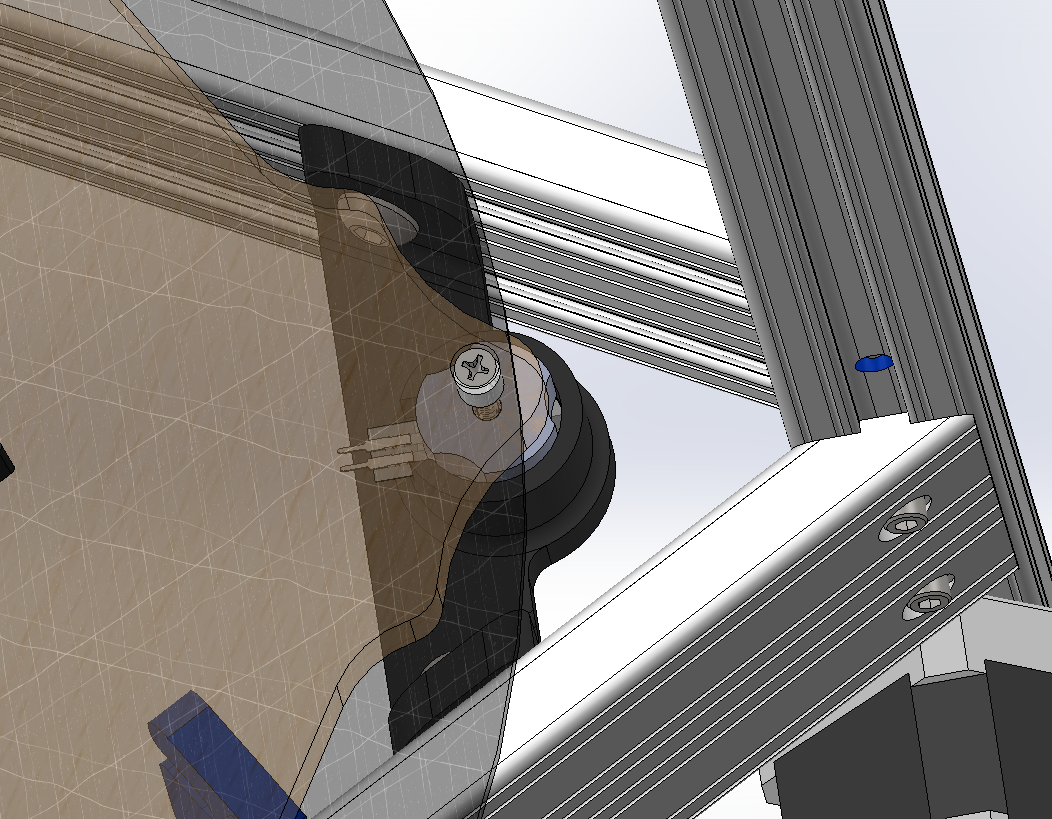

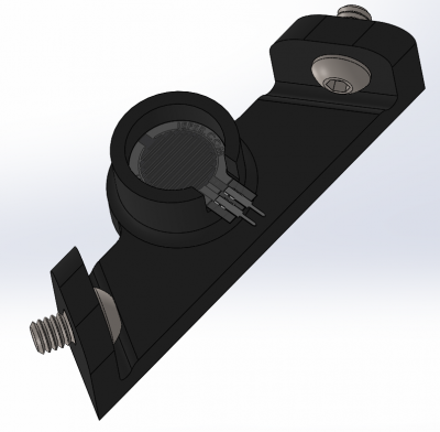

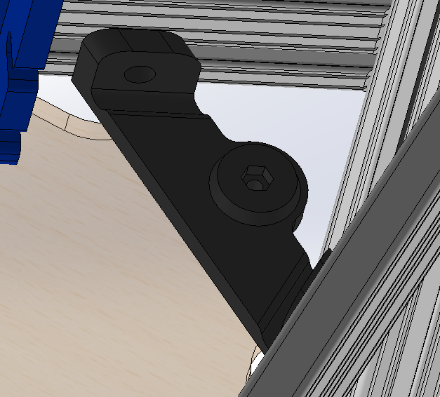

Went ahead and designed a FSR specific version of the heated bed bracket.
This uses 4-40 nuts and the stock 3/4" 4-40 screws. It's based on mhackney's design with a revised plunger design for the nut and stock screw.
As designed, it keeps the insulator very close to the frame rail when installed with an appropriate elastomer or cork pad. Without the pad, the insulator will set on the fail and fail to function. There is currently a 0.6mm gap without the required pad.
Look for FSR Piston and FRS Bracket in the Git Repo.
FSR Assmembly
FSR Assmembly
FSR Bracket
FSR Bracket
X-Section
X-Section

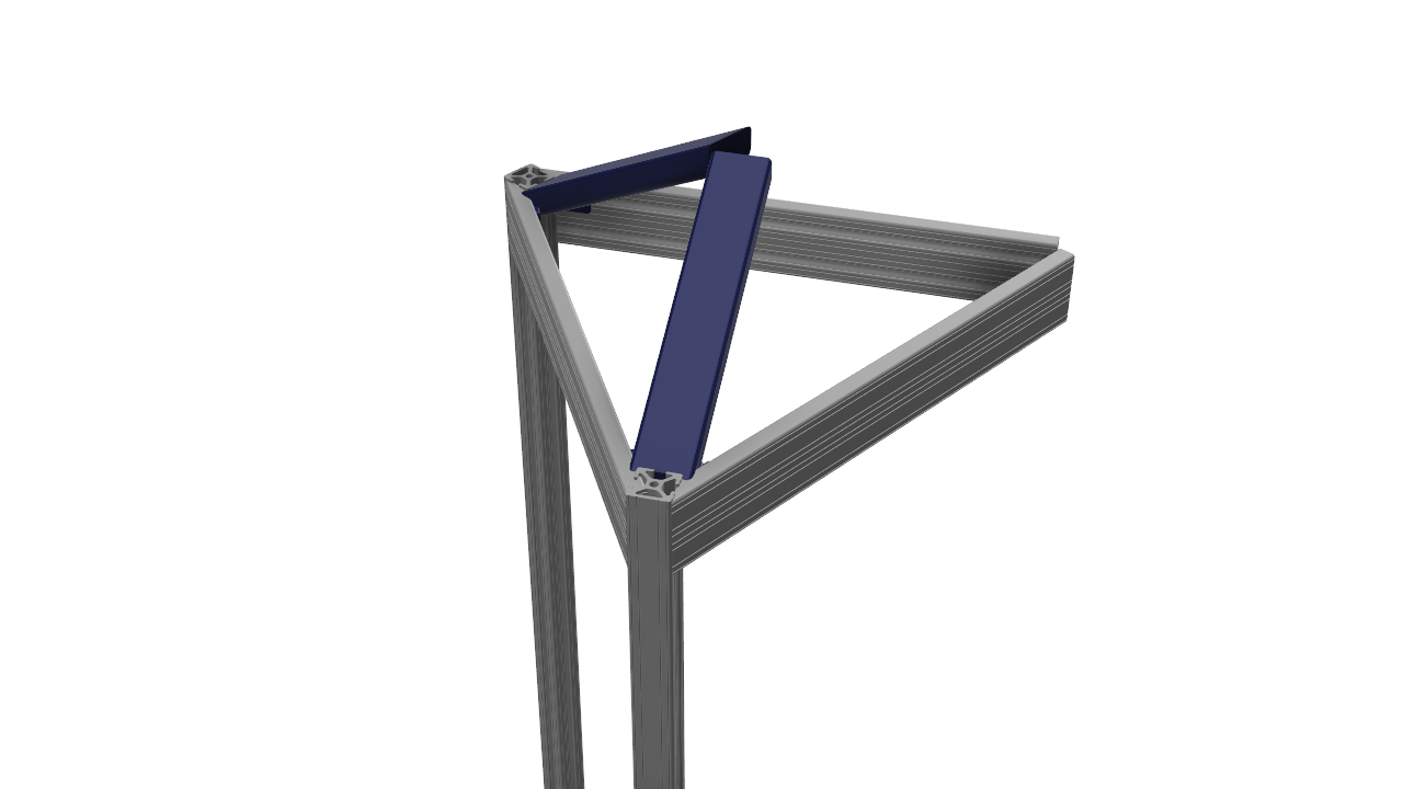

Did anyone ever post the CAD assembly of the Max Metal frame? I slapped something together quickly to get started on a top enclosure/spool holder, but my tower angles seem to be slightly off.
I need everything line up correctly before finishing the supports and creating the rest of the parts. Currently, the supports are not properly lining up at the apex. With a better frame model, I can get everything aligned properly and finish it up in a few days.
Preliminary support design:

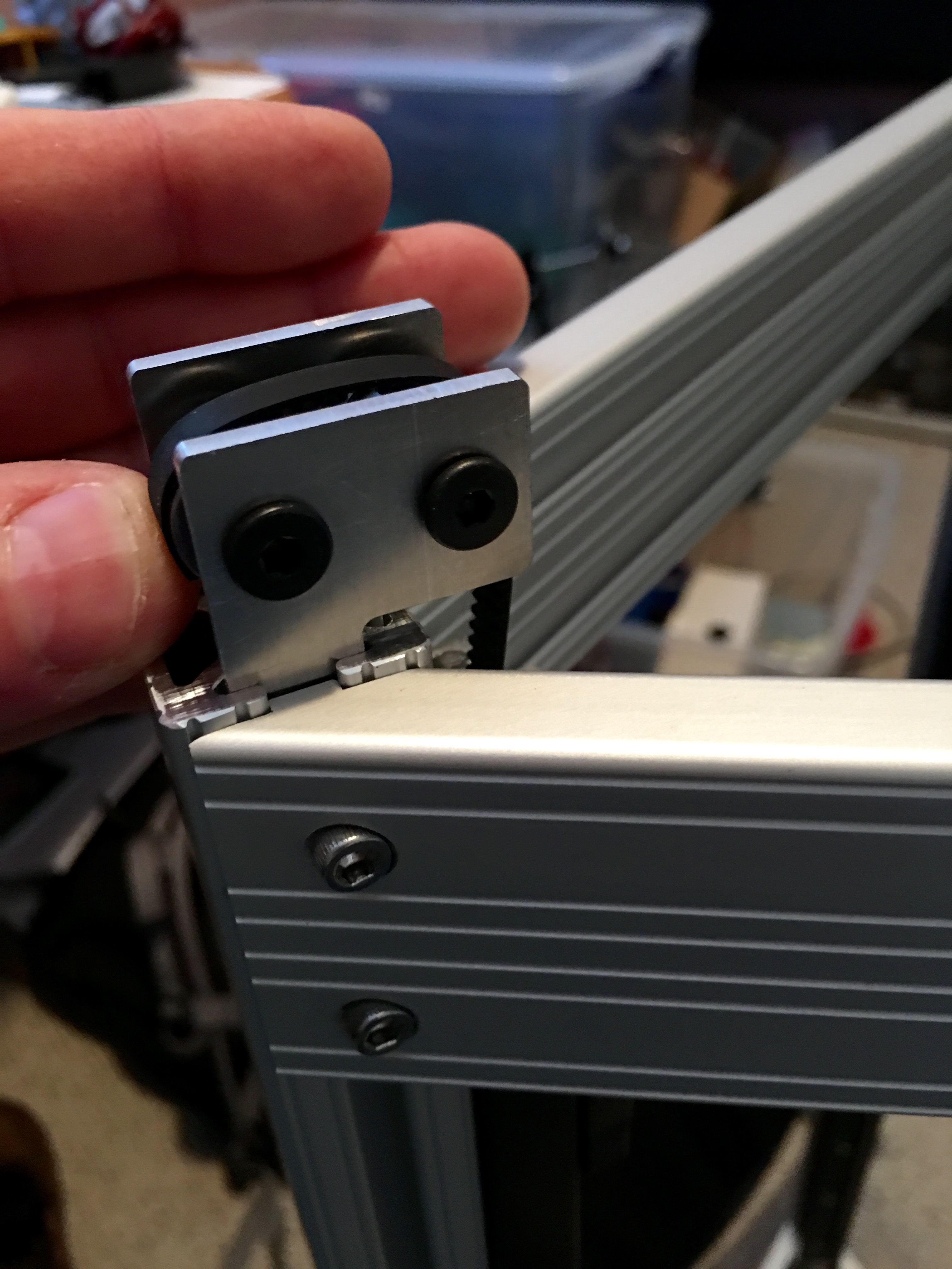

Posted: Sat Mar 12, 2016 4:28 pm
by mhackney
Great, thanks. I finished milling the new idler mounts to use with my linear rails. I ended up using two sets of the 15x4 bearings to route the belt. It is perfectly aligned with my belt mount on the linear guide carriage.
Next I have to make an idler mount for the bottom to bring the belt out away from the pulley on the stepper so it is properly aligned with the carriage.

Posted: Sat Mar 12, 2016 5:09 pm
by mhackney
Four 5mm washers on each side are perfect.
