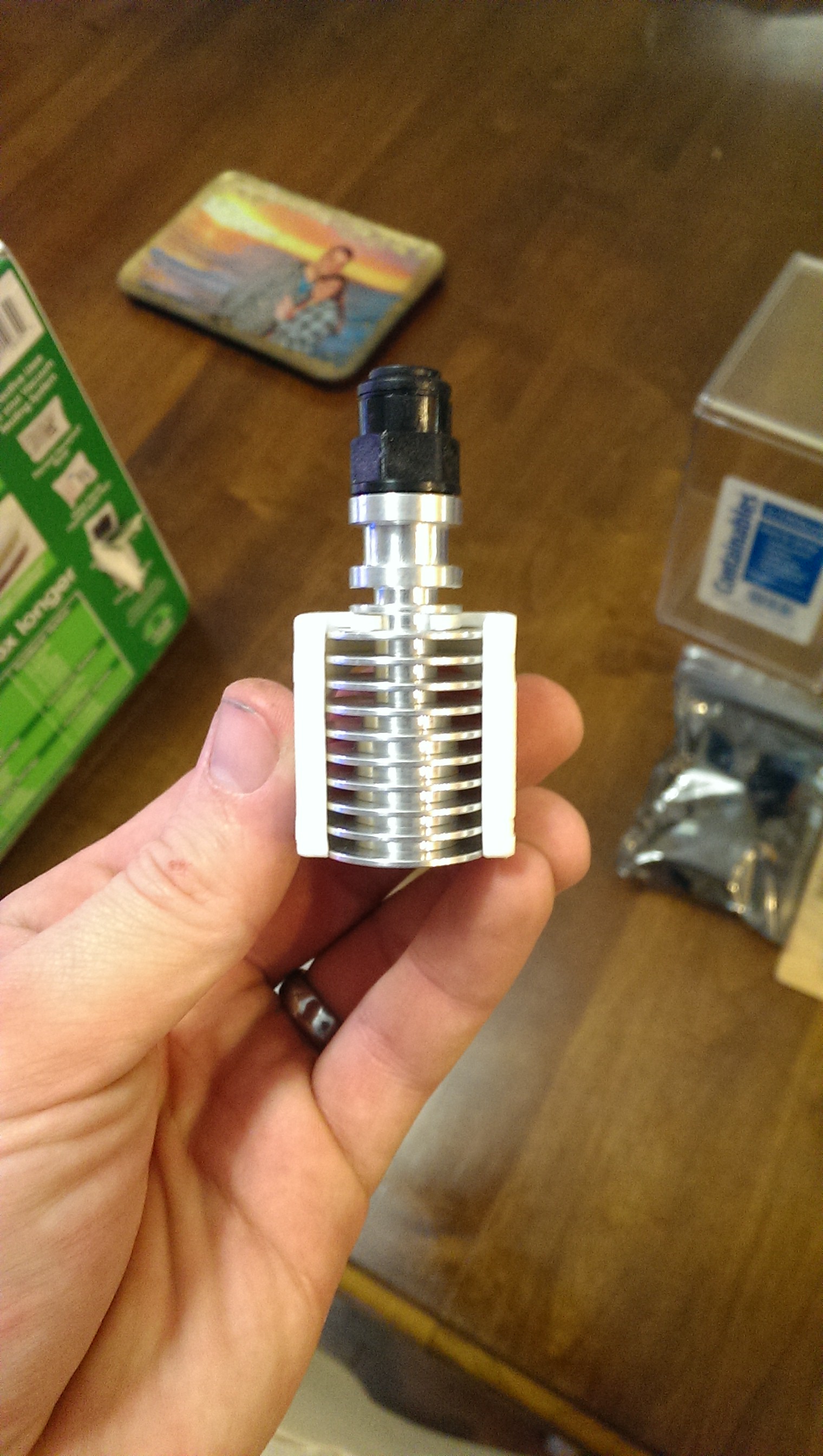

I'll be posting this to thingiverse later today, but thought I'd share it here.
It's a new fan shroud for the E3D v5. I hated having to use kapton to secure the shroud, and I also got sick of having to move it every so often because it would start rattling/vibrating.
This fits the whole heatsink and has a c-clip that holds the whole shroud in place.
Tough thing to photograph, so hopefully you can see it clearly enough.
Cheers.
E3D Fan Shroud.STL
(163.85 KiB) Downloaded 576 times
Re: E3D V4 All metal hotend
Good job on that! The C-Clip should make a world of difference.

It would be nice though to have a E3D fan shroud that clips onto the hotend risers in the way that the SeeMeCNC one does, to keep it from rotating.
cope413
Posts: 446
Location: Orange County, CA
Post by cope413 »
It doesn't rotate unless you want it to rotate. It's very snug.

Post by barry99705 »
Won't the c clip get hot there?
626Pilot
Posts: 1716
Post by 626Pilot »
barry99705 wrote:Won't the c clip get hot there?
The bottom (hottest) cooling fin on an E3D is barely above room temperature with the stock fan blowing.
