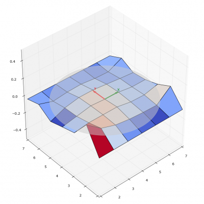

Re: Heuristic (AI) calibration for delta printers on Smoothi
Posted: Sat Mar 05, 2016 11:29 pm
by 626Pilot
pyjamasam -
I'm including your excellent dm_surface_transform visualizer in my next release. I've put in instructions on how to install matplotlib for python, and modified the script so that it automatically looks for dm_surface_transform in the current directory. You have been credited, and a link has been included to your source on gist. If you don't want me to include the script (so people have to go to your gist to get it), let me know and I'll remove it.
For anyone curious, this is what the visualizer looks like. It lets you pan around!
I saw you've been having a few issues with your fork of my fork. Thanks for figuring out the new way to hand arrays to the FK/IK methods. Copying the array subscripts into a new array that those methods understand is alright. However, you forgot to copy the output back into the main array after the first call you modified. I fixed this on my side. I also noticed one of your commit comments is that you've disabled stuff because you're crashing. This is because you have enlarged the probing grid from 7x7 to 9x9. It may not seem like a large increase, but doing that requires significantly more memory. There are places where this can be addressed. For example, right now, we have some 2D arrays that contain XYZ coordinates (XY for bed position, Z for vertical deflection relative to bed center). The bed position subscripts of these arrays can be dropped in favor of calculating the coordinates every time we need them. This is a little slower than reading them out of an array, but not much. It requires a few adds, subs, and muls, but that's it. The relevant code is in ComprehensiveDeltaStrategy::init_test_points(). I will look into that in a future release.
