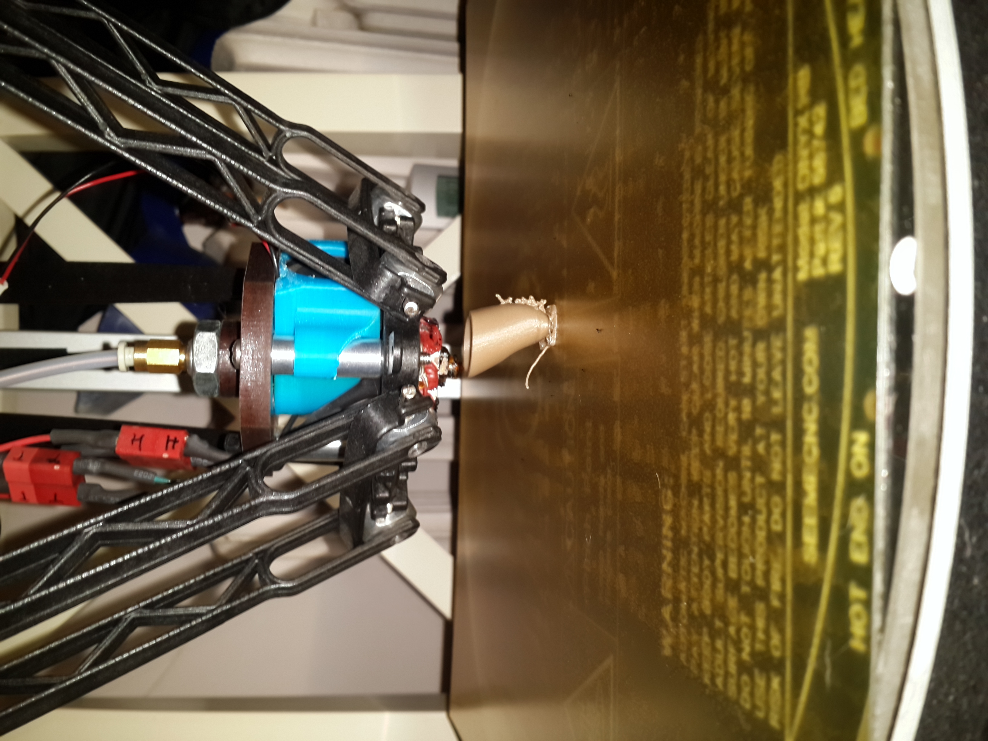

Printing a finger on its tip.
The blobbing on the right, i will deal with later. As i just printed a heat calibration tower probably forgot the retract settings or something.
I was previously printing abs at 232 degrees. Now i am down to 214.
So far so good. I sure do hope that the finger doesnt topple over creating a mess.

teoman wrote:Printing a finger on its tip.
Nice Adherence!

Thanks!.
So far i am very very happy with the pei. I may have a very tiny spot in the middle where i readjusted the Z height and left the hot nozzle standing there. But nothing major.
My isopropyl alcohol wipes did not arrive yet. So i wiped the bed down with acetone.
We shall see how the print ends.
BTW, how did you paste the PEI to the glass? I put line by line by line of the 3M strip :-)
I don see any of the lines in the picture, is it just that cannot be seen?

I bought the the big piece of tape.
I know line by line would have been cheaper. And may infact be better for bubble avoidance. But at the time i thought a single piece would be better and made the purchase. I have no idea why the big sheets cost so much more per cm^2 than the strips.

Oh dear. It failed.
Well i was asking for a lot. And i do not have the other settings tuned yet. So probably insufficient Z lift and retract.

I am noticin some delamination now :@

I was talking about pei delamination.
But i got the finger printed. Pei held untill the end.
