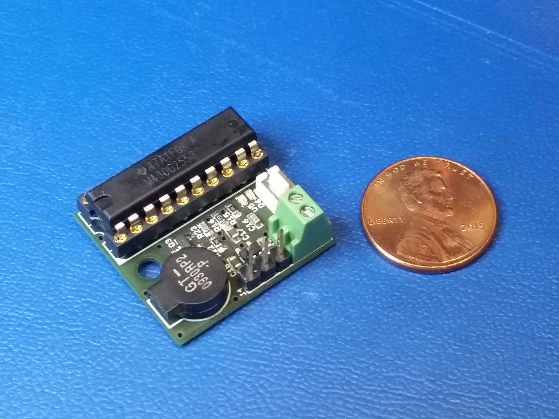

If I understand what you're looking for, it would be very similar to my recent altimeter project. Is this the sort of thing you're looking for?

Basically. It will need the HE280 connector on one long edge and pads for the 8 wires on the other. The processor chip and 5v regulator (maybe depending on processor) and an LED to show the touch and relay messages on startup. I'm also thinking a row of four 2 pin headers to use for setting the sensitivity with jumpers and another to select NO or NC behavior. I can write this up and also make a drawing of the basic format and how I'd like to attach it between the whip and hot end.
