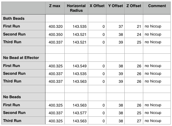

by mhackney
Well, this is not going to be good news...
I did a series of tests to validate if the beads were the silver bullet, they are not. This one was an easy test. Basically, I did 3 calibration runs with the beads on, three with no bead at the effector and three with no beads at all. If interference was leading to bogus data - hypothetically on the Z and/or Y tower offsets, one would expect the tower offset data, at a minimum, to be different between these sets of runs. But that's not the case:
As you can see, the offsets, Z Max and calculated delta radius are extremely consistent. This conclusively rules out interference as the contributor to this problem.
I should note, these were all done stone cold, even the fan in the power supply was off. I ran them back to back and observed and listened carefully. The "no hiccups" comment means that all runs went very smoothly.
Next I need to print with this latest calibration to verify it is still laying down a good first layer.

mhackney wrote:Well, this is not going to be good news...
That's not bad news. That's not even "not good news." It's just more observational results. More data is always good.
I do wonder though, can I ship you a set of ferrite beads and have you reproduce the same settings used on our machine and the other machine both of which did show improvements? This would just mean wrapping the two I2C wires around the ferrite bead at both ends, cutting the wires flat at the HE280 plug and running the probing routine 2X.

Again, it is VERY easy to check if this works. Simply record the Max Z, delta radius and X/Y/Z tower offset values from EEPROM before and after making the change. The Max Z and X/Y/Z offset are what the probe measures. If interference is causing a measuring issue it will show up there. The delta radius is calculated from 2 measurements that are not stored but you can see on the console. No need though since the X/Y/Z offsets tell the story. If these are reproducible from run to run like mine above, there is no interference issue.

Re: P003A HE280 [Solved?] Auto Leveling Issue/Bed Leveling Issue/Calibration
Posted: Tue Nov 08, 2016 3:47 pm
by mhackney
The idea was not that communication was lost but that noise was introduced and interpreted as data.
My data includes results without the beads - its the last 3 rows. You simply need to look at your eeprom values. Matter Control, Repetier host and a plugin installed in OctoPrint all let you do that.
Your offset numbers are not going to be consistent with mine or anyone else. They are a result of the total distance from bed to triggered home switch. You can (and should) adjust these as I describe in my build thread to be less than 4 steps each.
Posted: Tue Nov 08, 2016 4:29 pm
by iKeyborg
mhackney wrote:The idea was not that communication was lost but that noise was introduced and interpreted as data.
I don't believe that inside the chip tiny electro-mechanical sensor can pick-up any electrical noise.
It is a resistive element inside silicon.
Significant noise in I2C interface will cause likely communication problem not wrong data.
On the other hand accelerometer cannot send data faster than every 1 - 2 ms. With 100mm/sec probing, error in Z position can be 0.1 - 0.2mm
(can be more with controller latency).
