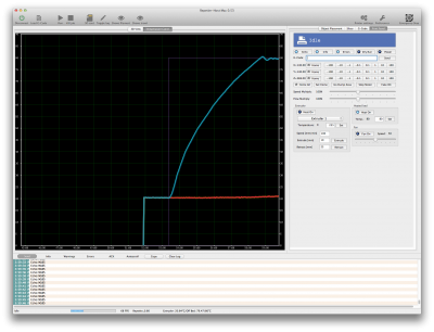

Basically in a resistive heating element like that in an Onyx, power is converted to heat. Increasing power will get the temperature to a set value faster - as long as the device can handle it. So, using a bit of electronics calculations, you need to figure out how to apply more power to the Onyx (again, as long as you don't over power it and melt the traces, etc). The equations used are Ohm's Law and the power law:
Ohm's Law is V = I*R where V = voltage, I = current and R = resistance. The Onyx's resistance is fixed at 1.3Ω. Rearranging the formula, R = V/I or 1.3Ω = V/I. This tells you that current will be proportional to voltage. So, if your power supply can supply the current, increasing voltage from 12 to 15 to 24 volts will be met with a proportional increase in current. With this knowledge, you can then apply the power law: P = I*V where P is power. So, having calculated V and I with Ohm's law, you can calculate the power by plugging those into the power law, or you could use an online calculator that calculates power for you using these equations. With this calculator, enter the Onyx's resistance and the voltage and it will calculate the current and power. Try it for 12, 15 and 24 volts and you will see that power increases (as does amperage).
12V - 9.2A - 111W
15V - 11.5A - 173W
24V - 18.5A - 443W
The question has been asked, is the Onyx engineered to handle 17A of current? And, of course, the RAMBo version 1.1 is limited to 15A 12-24V so you won't be able to pump more than 15A to the Onyx. Plug 15A into the equation with the resistance and you get 19.5V and 292.5W. I've talked to Steve at SeeMeCNC and he thinks the board was designed for 12A or so with a few amps margin of error. He believed it should handle 15A but told me to try at my own risk. I have been running my Rostock on a 24V 14.6A (350W) supply for a few weeks now. I have over 30 hours of "heat time" on the Onyx - admittedly not a lot of time but folks here seem impatient and thirsty for information so I'll tell you what I've learned!
I see no evidence of fatigue, blistering, excessive warpage or any other physical damage to either side of the Onyx or the electronics connector pad. The LED works properly too - I am running the 24V through the RAMBo to power everything.
SIDEBAR: I saw an earlier post somewhere about running steppers at 24V. There is absolutely no problem with doing this. Read section 7 of this great overview on steppers and this article on Stepper Motor Voltages Explained. The SeeMeStepper is this one 42BYGHW811 and the rated voltage spec is 3.1V. So, running at 24V is only 8X, which from the Gecko article:
An empirically derived maximum is 25:1, meaning the power supply voltage should never exceed 25 times the motor’s rated voltage
makes it still well within spec. I can not tell any difference in my steppers running at 24V, they don't seem to run any hotter - basically, everything works just fine and heating is much faster.
With my 24V supply, the naked Onyx heats incredibly fast to 100°C. Putting anything on it like aluminum or glass or both adds thermal mass that needs to be heated via convection. This takes power, so of course it takes longer to get to temperature with either or both of these for the same power input. Currently, I have my 1/8" thick aluminum heat dissipator and the borosilicate glass plate on top of that - a fair amount of extra mass to heat up. Below is my temperature-time curve from Repetier that shows heating the Onyx from 21°C to 80°C with the aluminum and glass in place. It took just a hair over 5 minutes. I've done the auto PID calibrate on this and you can see the temperature rises and stabilizes pretty quickly. The temperature - measured with a thermocouple - at the center of glass surface after stabilizing was 80.1°C and several points at the very edge of the glass were 79.2° and higher - very even temperature distribution.
I have also done some quick heat up tests with just the aluminum and just the glass plate. The time decreases by about 1/2 in both cases - the aluminum is a little quicker to heat than just glass.
Only time will tell if there is any damage to the Onyx. I am not running mine at greater than 80°C so I can't say what would happen increasing power to get up to say 100°C for an extended time. I'm quite happy with the performance of both the heated bed and the rest of the system. I have added a 24 to 12 volt convertor to run my auxiliary fans and LEDs. The fan controlled via software runs fast at 100% so I just turn it down to 50% or so.
Finally, the last thing I'll add is, I have purchased one of the 24V silicone heat pads. I intend to test it as soon as I have time. It has a built in thermistor too. The challenge with it is it is not perfectly flat. There is a bulge where the wires come in that has to be accounted for. I haven't decided how I want to address that yet. I will likely attach it to the bottom side of one of my aluminum plates with Permatex Copper around the edges to get good physical contact and then elevate the assembly with standoffs but without the snowflake spacer included in the Rostock kit.

mhackney wrote:The Onyx's resistance is fixed at 1.3Ω.
This is only right for a cold heatbed. The resistance increases to 1.7Ω @ 120°C. So you have less power at higher temperatures.
I've used mine now for many hours with 23V @ 125°C without any problems. Maybe the aluminium plate keeps the traces from flying into outer space ;)
Re: Very bad Onyx heating (max 80°C)
Thanks guys. aehM_Key you are absolutely correct that resistance changes as a function of temperature. One thing the aluminum plate may do is act as a big heat sink (which it is of course) that actually helps minimize local hot spots that could result in failure of the traces. Just a hypothesis but it seems reasonable. Running the Onyx at 24V with only glass or nothing might lead to failure but until someone does it, we won't know.
