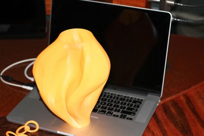

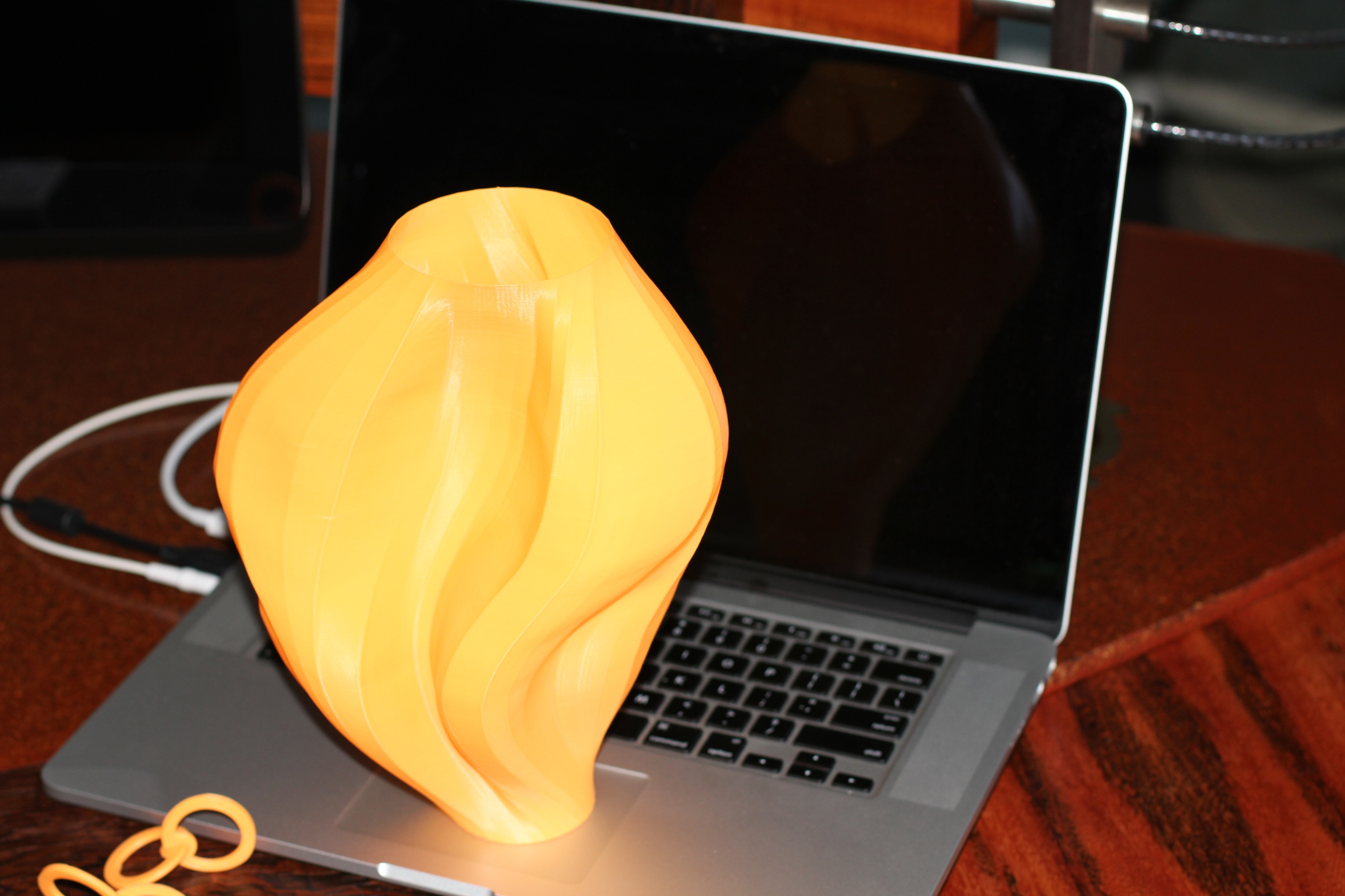

I printed this. I scaled it 200%, so it stands about 9½ inches tall (240 mm).
The vase, not the laptop, you dork!
Fun facts:
It is a single-wall print. (one perimeter, zero fill) 0.2mm layer height, 0.55mm layer thickness.
ABS, neon orange from Toner.
I printed it at 60mm/sec, I think.
The model is here. http://www.thingiverse.com/thing:49348
Single-wall prints are easy and fast. Since the extrusion never stops or backs up, you don't have to dial in the retraction.

Excellent question! I just tried it, and it does not. There are two hairline cracks where layers did not adhere. I've had the same problem with other single-wall shapes -- I think I need to either increase the temperature a bit or do something to prevent random air currents on the printer.

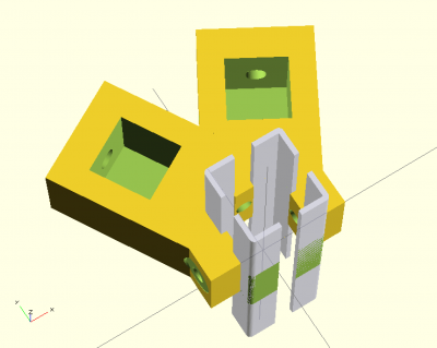

You mentioned bracing the towers over on your build thread. I've modeled this, and I've printed an earlier version. The idea is to put threaded rods through the end holes and nuts inside the boxes. Adjust the nuts to fine-tune the intra-tower distance.
Tower Brace, rev. 0.000002.
This is an early iteration, mostly just to see if I can make something attach to the towers. I have to make the bottom ones much thinner so they will go under the Onyx, and the top ones have to somehow cooperate with the limit switches and upper idler wheels. And the T-slot nut where the belt is will have to go.

I like where your going with that design on the brackets, I think we would get more support if the bracket fully enclosed the tower.

CJGerard wrote:I like where your going with that design on the brackets, I think we would get more support if the bracket fully enclosed the tower.
Thank you.
I was not originally thinking, "Make it rigid." I was thinking, "Position it accurately before tightening the T-slot nuts."
OTOH, that piece is absurdly strong for an alignment jig. Maybe I just don't know what I'm thinking. (-:

What's the point of the alignment jig, other than alignment of the arms? Super-stiffness?
