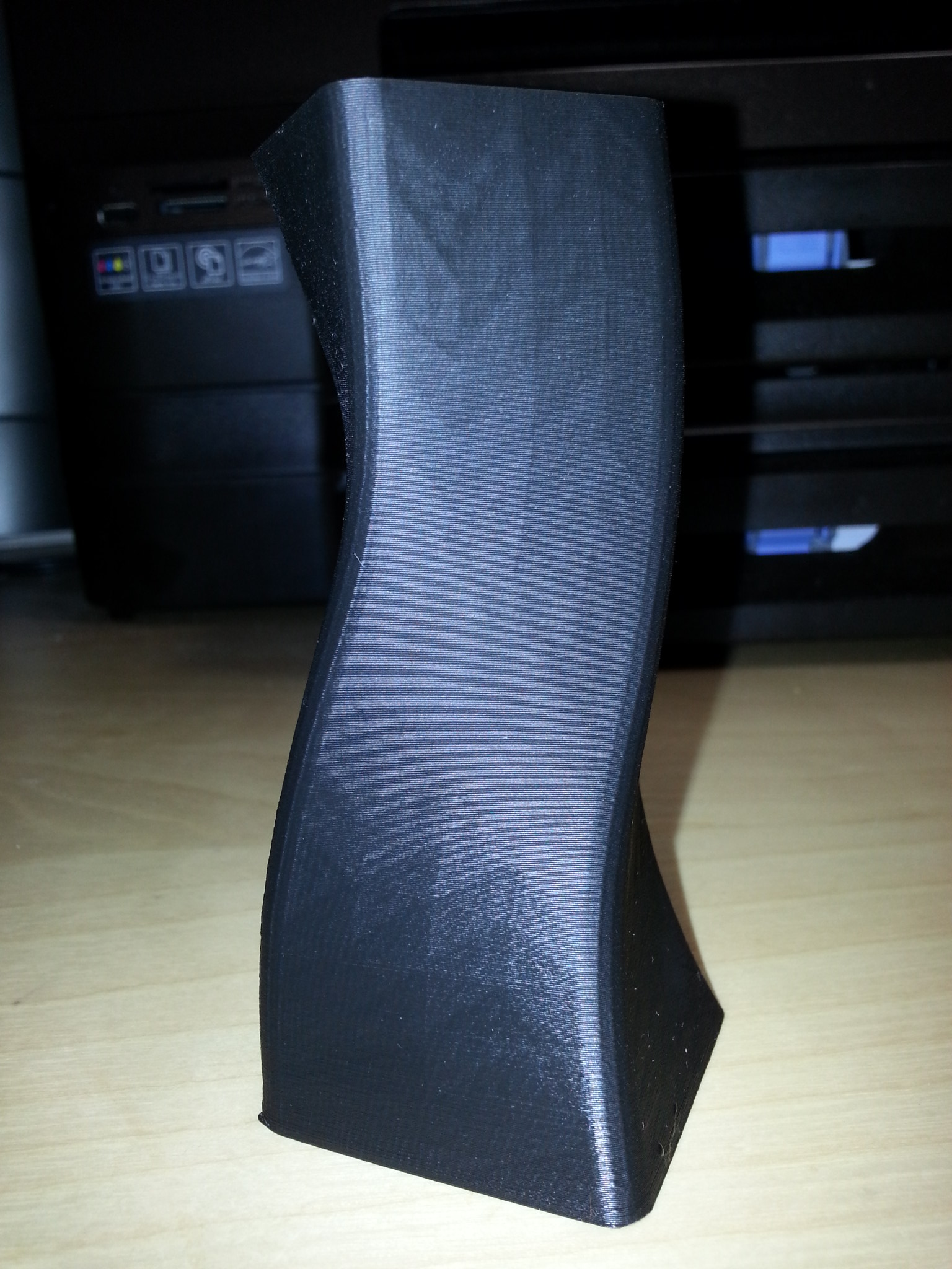

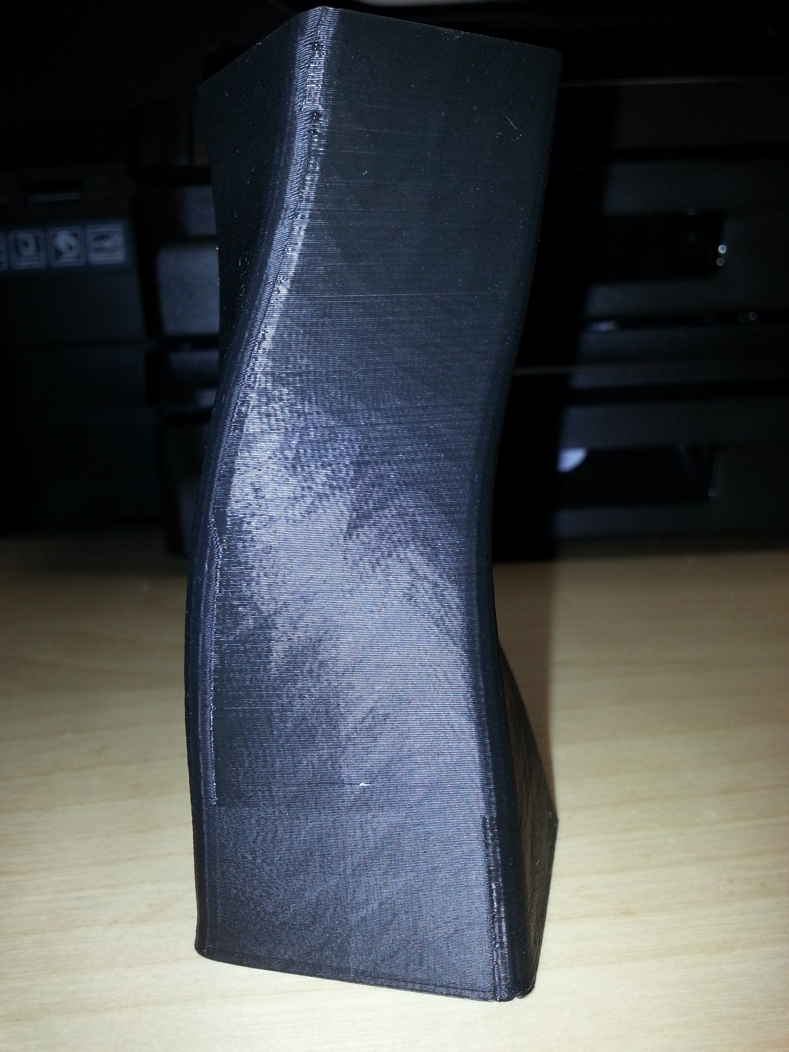

Well, I've been running a lot of tests and made significant improvements to the print quality of the vase (http://www.thingiverse.com/thing:25278) I've been trying to print with KISSlicer by doing the following:
1. Printing from the SD card.
2. Setting Prime = 10.6, Suck = 10, Wipe = 5, Zlift = 0.5
3. Configuration.h Motor Current Settings (195, 195, 195, 195, 0) which are the stock settings in github.
Throughout all my testing I already had a fan mounted to the effector to blow on the Peek and I tried blowing a fan over the build plate, but this did not make any noticeable difference. By the way I'm only printing at 30 mm/sec.
Here is a pic of the vase using the above mentioned settings. Although there are still some issues at the seams near the edges of the vase and a couple of small blobs near the top, the rest of the vase looks beautiful:
Here is a side view of the vase w/ no seams...looks beautiful:
When I lower the prime so it's closer to the suck, for example if I try anywhere from 10.0 to 10.5 I get worse results. Does this mean I'm getting too much bowden backlash or I have too weak a motor for the task at hand? What other extruder motor settings can I try to adjust besides the current? I'm using the Nema 1:1 and the EZStruder both of which come stock with the current Rostock Max kit.

The motor isn't a problem, and that difference can easily be the flex in the bowden tube. There isn't much to do about that without shortening the bowden length. Check out the flying extruder mod if you want to go that route though
It's possible to reduce that flex by keeping a constant force on the tube (effectively making it more rigid), or by adding a more rigid support to the tube such that retraction does not relieve any stresses in the bowden tube that has to be restored before the filament moves the intended amount. That carries the possibility of affecting your hotend's positioning if it is too rigid, so you'd be hunting down the sweet spot for optimal bowden tube rigidity next.
