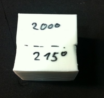

Hmm... Before you put up Repetier, one more experiment (If you're willing to do so):
Here's a picture of one of my testcubes I'm printing whith every new spool of filament (this is from PLA):
PLA testcube 215°C -> 200°C
As you can see, the corners are fairly round at the bottom where the nozzle temp is obviously too high.
In order to get the right temp I usually start with 240°C (ABS) or 220°C (PLA). I let Slic3r set the initial/starting temperature.
Then I go into the g-code and maunally lower the temp by 5° every 20th layers.
When the machine is well adjusted and no other problems are present, the print will start looking good when the right temp is reached.
Your cylinder is ok from the 10th layer (or so) on. Maybe because from there on the ambient temp cooled down the filament fast enough whereas the first layers got too hot or cooled down too slow (extrusion temp + influence of the heated bed).
This experiment is only working well with cubes, hexagons, etc - evyrthing that has sharp edges.
After every 20th layer you put in your g-code the line "M104 S240" then "M104 S235" and so on.
Speed at 15m/s and no further modifications.
With repetier you can modify that value while your print is running. With some versions of marlin an internal "M109" is issued, this would stall your print immediatelly and thereby ruin the whole experiment. That's why I'm suggesting to modify the g-code.
If the corners are geting more angular from the bottom to the top of your cube - well, then you have gained a bit more time for installing repetier. ;-)
Nd - after seeing your cylinder I think the basic adjustments of your machine are ok.
~Jens
Edit:
I've just noticed that you've done some prints with different temps already and the corners of all of them are not ok at all.
So I'm with Geneb: give repetier 0.91 a try.

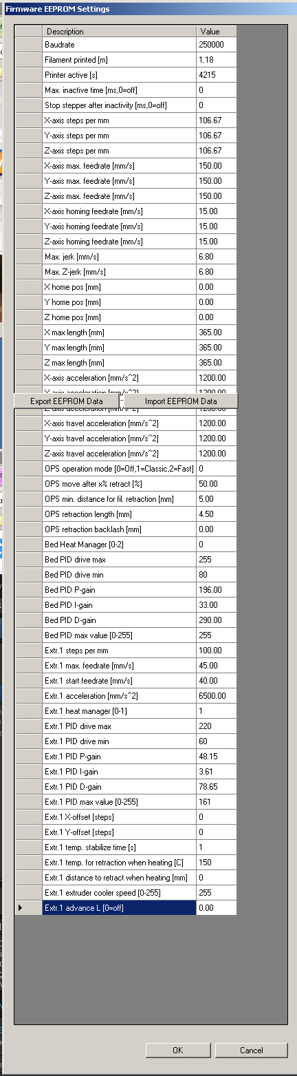

I'm searching the firmware and eeprom for how to set the delta radius now..

analog_banana wrote:I'm searching the firmware and eeprom for how to set the delta radius now..
It's called "Horizontal radius" in the EEPROM settings.

by analog_banana
Yes - You would think that!
but I can't see anything like that in the eeprom settings list.
Nothing Horizontal, no radius..
See image:

Hey Banana,
I suggest to set Extr PID Max Val to 240 (this is ok for the SeemeCNC dual-resistor as well as for heating cartridges).
The same for the heated bed (here you can got up to 255).
20.00 mm/s is a good value for the jerk settings
3.000.00 mm/s² is a conservative value for your X/Y/Z acceleration settings.
90.00 mm/s for the X/Y/Z homing feedrate
160.00 mm/s for the X/Y/Z max feedrate
The 100 steps/mm for the extruder... Did you measure that or is this a rough estimate?
With the ezstruder (I'm simply assuming you have one of those) and 1/16 stepping this should be arround 92.65 (I got this value out of geneb's manual and didn't chance it ever since).
One note about the Jumpers on your Pololu (A4988) drivers. Almost every value (steps/mm, acceleration settings) is coupled to your microstepping settings. So they have to be the same on your hardware (jumpers) and in your software. Else the whole machine will start doing funny things. Set both, jumpers (on every driver board) and #defines in your Software to 1/16.
If your hardware is configured to 1/8 and your software is driving it with the number of steps for 1/16 - then you have some kind of time machine. Same ammount of time, double speed and travel. :-)

Me again :-)
Did you wipe your EEPROM when changing from marlin to repetier?
To be sure the INIT-Run of 0.91 created all values and pointer correctly do the following.
1. Set "#define EEPROM_MODE 0"
2. compile / upload and start the controller
3. Set "#define EEPROM_MODE 2"
4. compile / upload and start the controller
What ist RepHost saying now (EEPROM Settings)?
Oh - don't forget to export your EEPROM table vie RepHost before doing that procedure.
~Jens
Re: Maybe Belt/Motor Skipping?
Posted: Wed Feb 05, 2014 7:21 pm
by analog_banana
This is what hapenned:
Set "#define EEPROM_MODE 0" = eeprom settings are blank
Set "#define EEPROM_MODE 2" = eeprom settings are visible - settings restored to defaults.
I still can't see a Horozontal radius option...
