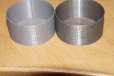

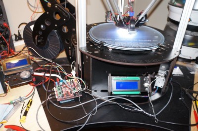

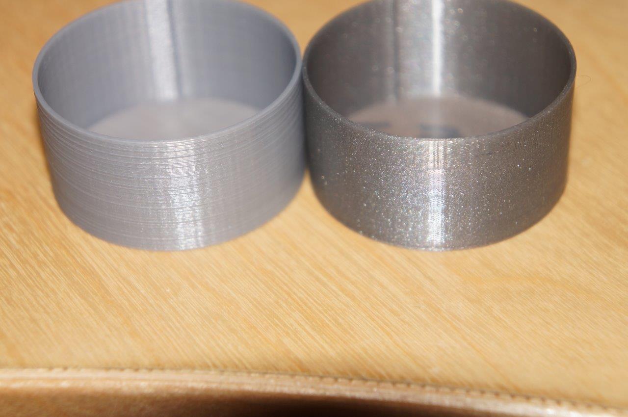

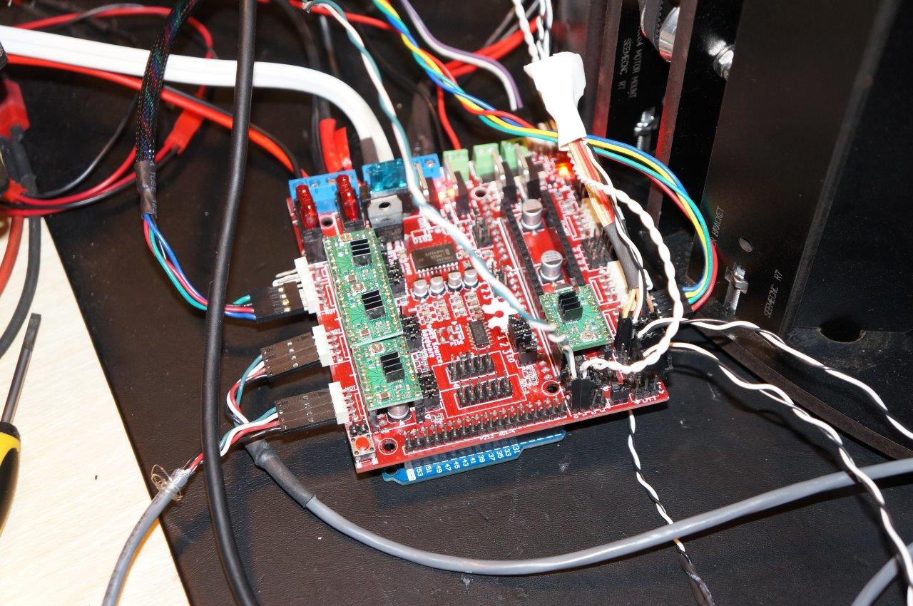

I've got the 0.9 steppers installed along with the ramps-fd running the ARM Arduino DUE. I just finished a test print with the printer. I used the same repetier config. The vertical banding is definitely still there but a lot fainter. It is closer to the banding I have on my cartesians. I need to run some more tests.
Re: Vertical Banding Issue
I'm playing with different values for the printing segments. I tried 400 and it isn't as nice as 180 (default) was. I tried 800 and ended up with some stuttering. I tried setting it for 70 and I think it may actually look better. This is on a cylinder printed as a vase. I still need to do a lot more tests before I can really say how much of an improvement this may be. At this point I'm not hating it.

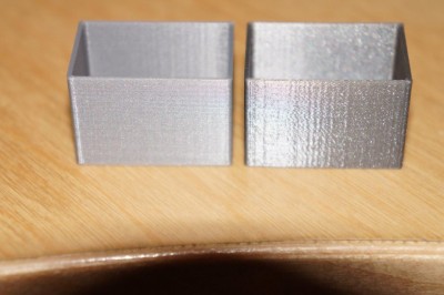

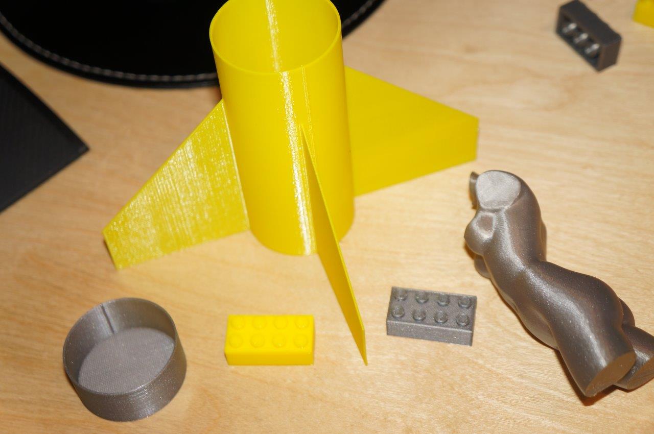

I'll make a youtube video tomorrow of the setup. So for the results I'd say cylinders are on par with a cartesian. As for straight lines on axis the cartesian wins. They straight lines are markedly improved now though but the vertical banding is still visible. I tried segments of 70,180 and 400 on a 2 loop cube sliced in vase mode with kiss. The 180 segment one looks the best followed by 70 and then 400. It is a big improvement to the 1.8 steppers. I think that the majority of the improvement is due to the increased resolution of the 0.9 deg steppers. I don't think the ARM processor is really adding anything here as the firmware is the same. I think what we really need is to see some delta firmware written for these arm controllers or at least optimizations of the current flavors.mhackney wrote:Wow, that's a lot of advancement! I'd love to see the pics of the setup.

Here are some pics
cartesian on left; delta on right cartesian on left; delta on right

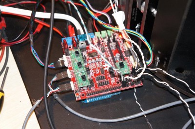

However I wouldn't recommend upgrading to 0.9 steppers without moving to the ARM and some compatible shield such as RAMPS-FD or RADDS. The atmel arduino mega will not have enough horsepower to drive the 0.9 steppers at whatever top speed you use now. As the steppers require 2x the steps your max speed will be divided by 2.
Right now I am tweaking the Repetier ARM board in concert with others including the repetier developers. Lucky for us the dev also has a DELTA.
I wouldn't advise anyone buy the Rev 1A version of the RAMPS-FD on ebay made by getech. This is because it is an earlier version that has bugs. Some of them are safety bugs. There is a problem with the way the fet circuit is designed for heaters. Right now if the ARM board fails it is possible for the heaters to turn on and of course this would be unregulated by the thermistors and could start a fire.

I am currently running 4x the resolution I was with the stock rmax. I doubled the resolution when I wen from 1.9 to 0.9/deg per step steppers. I doubled it again when I we from 1/16 to 1/32 stepping on my allegro drv8825 stepper drivers. I went from 80 steps per mm to 320. The latest bleeding edge version of repetier is amazing for ARM. I have DELTA_SEGMENTS_PER_SECOND_PRINT set to 600 and DELTA_SEGMENTS_PER_SECOND_MOVE set to 200. I am able to print at the same speeds I was before the upgrade. The performance is simply amazing. I have reduced the vertical banding so it is barely noticeable. I think any artifacts now are due to mechanical issues. Yesterday I bought Simplify3d slicing software. I am getting some of the nicest prints I have ever made.

Great. I've got something like 8 hrs with it enabled now and 6 prints with no performance issues. But, I have been printing in black so haven't been able to validate effect on part quality/appearance. Hope to do some of that today.

[img]http://i57.tinypic.com/2hwen9l.jpg[/img]
