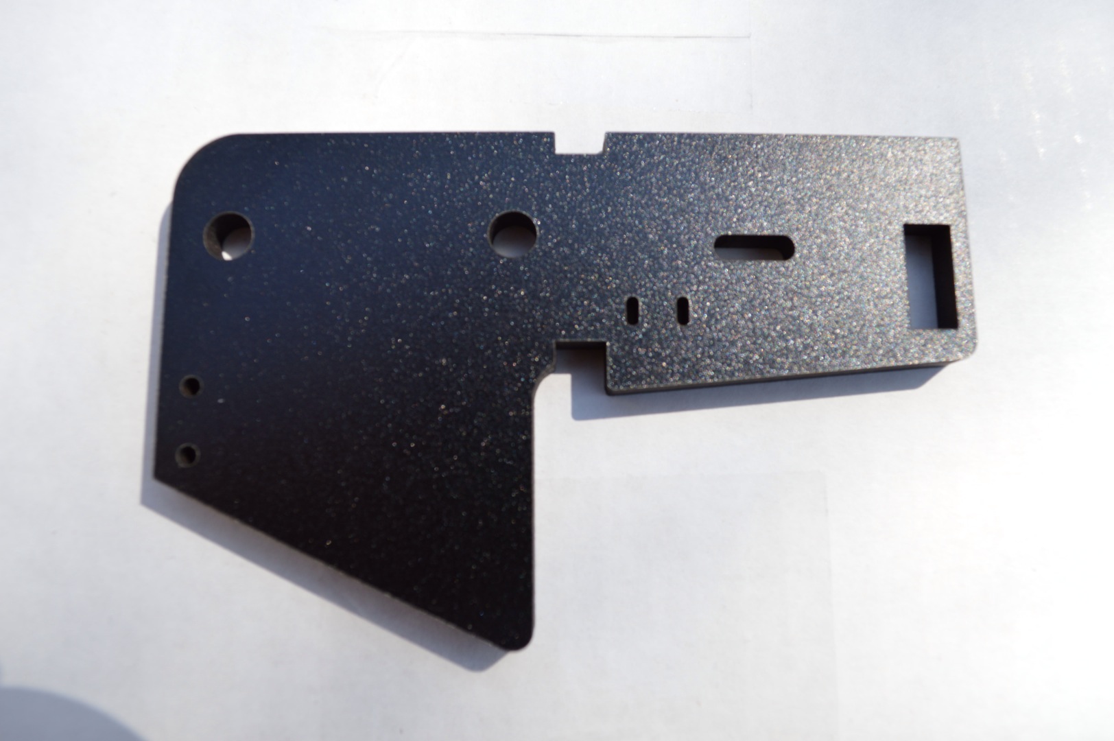

The package arrived yesterday and today was the first day of building! Everything went very smoothly, and with about 4 hours of work, the lower base is complete (page 49)! Tomorrow will be onyx bed, wiring and more!
Think I found another typo in the parts list:
pg. 14 - "14 each, #6-32, 1” Phillips Pan Head Stainless Steel screws. Used for Cheapskate plates and EZStruder mount." I think these are actually 2" screws (according to the parts list in Hardware package #1, which matches the photos).
The longest (and messiest) part of the build so far was removing all of the lasercut parts from the sheets and stripping the tape/protective paper off. Only 1 piece was difficult to remove where the laser hadn't cut through the surface on the opposite site of the material, but a bit of bending and xacto-knife work got it out in a few minutes.
[img]http://i.imgur.com/1EqkPPTs.jpg[/img]
Oh, and I ordered a white kit, but got a black kit. C'est la vie... I'm building it anyway :P

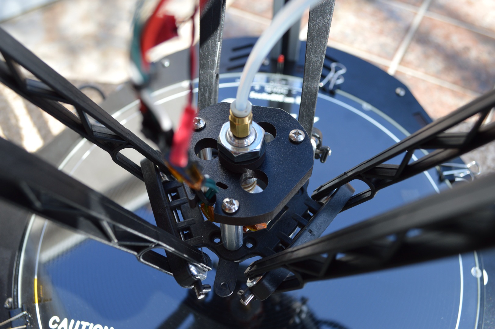

Few more little gotchas from today's build:
  • Didn't realize that the cheapskate inner carriage plates were not perfectly symmetrical when building (the holes on one side are slightly farther apart), so I built one cheapskate backwards, resulting in the outer plate (with the SeeMeCNC logo) needing to be reversed to make it fit. Didn't see any obvious signs that this would be a problem as the cheapskate carriage still fits properly and moves smoothly. Maybe could be highlighted in the build instructions for others to indicate direction of hole orientation
  • Pulling the wires through the tower extrusions can be tough unless you have a line to fish them through with - I used fishing line to pull everything through easily.
  • To feed the endstop wires through more easily, I just spindled the ends of the pairs, then put 1 dot on the white line for the "X pair", 2 dots for the "Y pair", and 3 dots for the "Z pair" and pulled them through as a bundle. Much easier than feeding individually.
  • No problems with the fit for the lower tower extrusion sockets, but the uppers were a bit finicky and took a combination of finesse and force to get a solid fit.
  • Onyx bed mounting wasn't too bad, although the #4-40 flat head screws are just a hair on the short side. I needed to pull a couple of the T-nuts tighter with a screw and a washer combo before they could get a solid grip through the Onyx plate.
Think I should be finished tomorrow. Got about 10 hours of building in so far.
[img]http://i.imgur.com/v0OieL6s.jpg[/img]
Dave

Page 131 - Attaching delta arms to effector platform. Which side of the platform (I'm assuming the flatter of the two) faces up and what is the little protrusion on the one point for and which direction should it face?

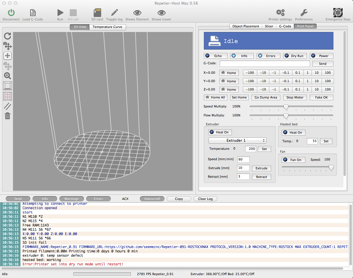

Page 180 - Mentioning for Mac and Linux user to skip the Driver install, perhaps tell them to skip ahead to XXXX section?
Page 183 - The Arduino software looks the same on a Mac, but the Serial port does not show up as COMxx, it shows up as /dev/tty.usbmodem3a21 or something like that... Let me know if you would like screen captures since I am using my Mac.
Page 190 - Repetier, again the Mac version looks a lot different than the PC version. Again, if you want screen grabs I can supply them.

A shot of the Mac version of Repetier
Note the protrusion on the effector platform
The upper tower mounts in my kit
