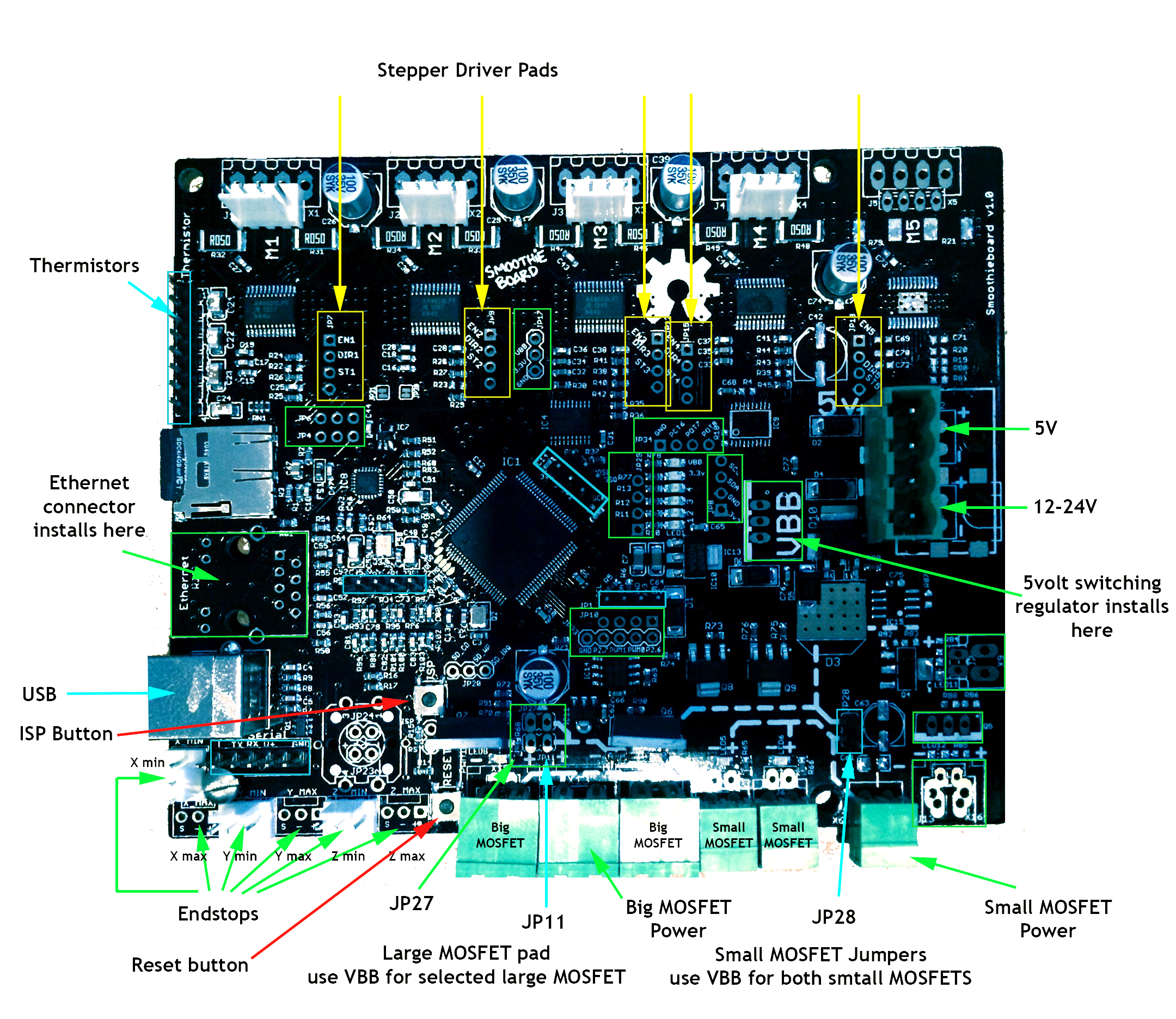

I'm finding the lack of documentation on the Smoothieboard production layout to be frustrating. I purchased the optional 5V switching regulator that is supposed to install on production boards and can't for the life of me figure out where it goes. I also read on the smoothieboard page that there are jumpers to power the MOSFETS from VBB without requiring a separate supply at the edge connectors or jumping (with wires) to them. Again, can't for the life of me find these. The "documentation" refers to a "non-border connectors section below" which does not have a diagram. With a little google detective work I could find the equivalent diagram for the beta boards but it doesn't really match the production boards. I'm thinning I should have gone with the X5, it has some very nice docs and connection diagrams. the smoothieboard came with 3 strips of pins that I have no idea what they are for.
Anyone find any good diagrams/photos/docs?

I found these pages helpful, they also have more info on github but I can't get to that right now.
http://smoothieware.org/smoothieboard-schematic
http://smoothieware.org/lpc1769-pin-usage
I'll post pictures tonight of the jumpers on my board since I know which ones your talking baout

The developer answered some of my questions so I started putting this together for him to share.

I read somewhere that they say to not use the jumpers if you will pull more than 1-2 amps over them. Were you just populating the board or were you planning to use them?
Re: My first Smoothieboard prints, wow!
Posted: Tue May 13, 2014 1:19 pm
by mhackney
Yes but there are 2 MOSFETS - small and big. With the smalls the pins for the jumper are already installed and since they are used for fans, using the jumper is no issue. That's what I plan to do.

Ah ok, I haven't used the small mosfets and I just use a terminal board to power fans/lights/etc. I don't have a layer fan setup so controlling the fans isn't a need yet.

One interesting "feature" of the small MOSFETS - if you do add the jumper, the small MOSFET power connector actually outputs 12 volts when the board is powered on. You can use this to turn on a cold end fan automatically.
