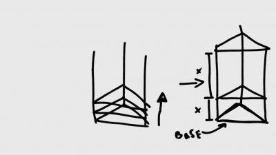

how did you spec what size magnets to use for the mag arms?
N52 strongest i could find from K&J http://www.kjmagnetics.com/
how did you go about aligning such a large frame?
so i used 1500mm 20x40mm vslot for my vertical linear rails, when i build my 60deg horizontal brackets i placed them all at the base on top of each other. i then tightened the horizontal extrusions so they were all the same lengths and slid them up the rails in place. i used the base as a reference point assuming the verticals were all perpendicular to the base. using gene's method of a cut measuring stick i spaced each triangle a set distance from the one below it and tightened. see attached pic

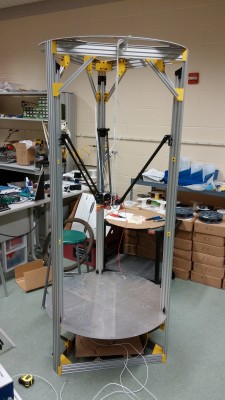

got some more time in on this project this weekend..
I converted everything to a 24v supply.
looks like i'm getting close to ready to attach a extruder and spit out some plastic.

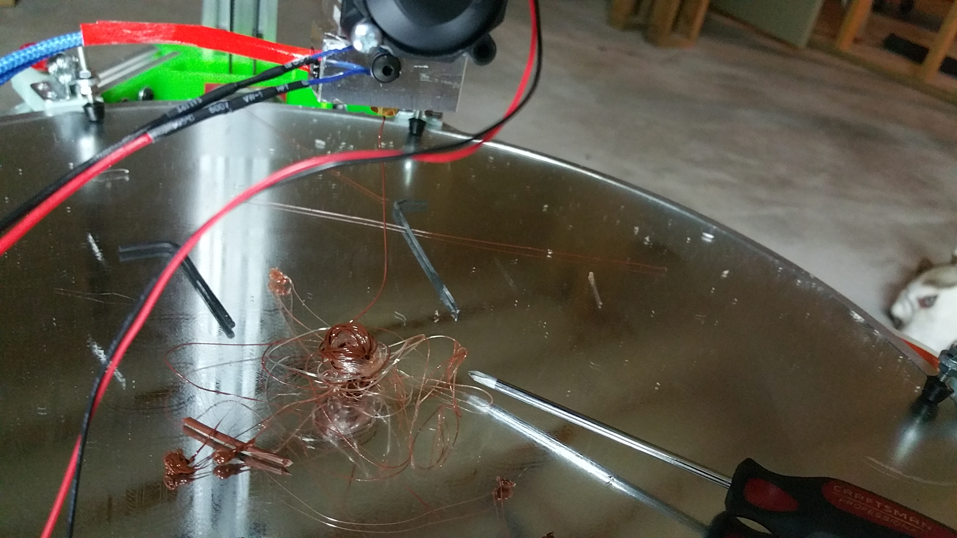

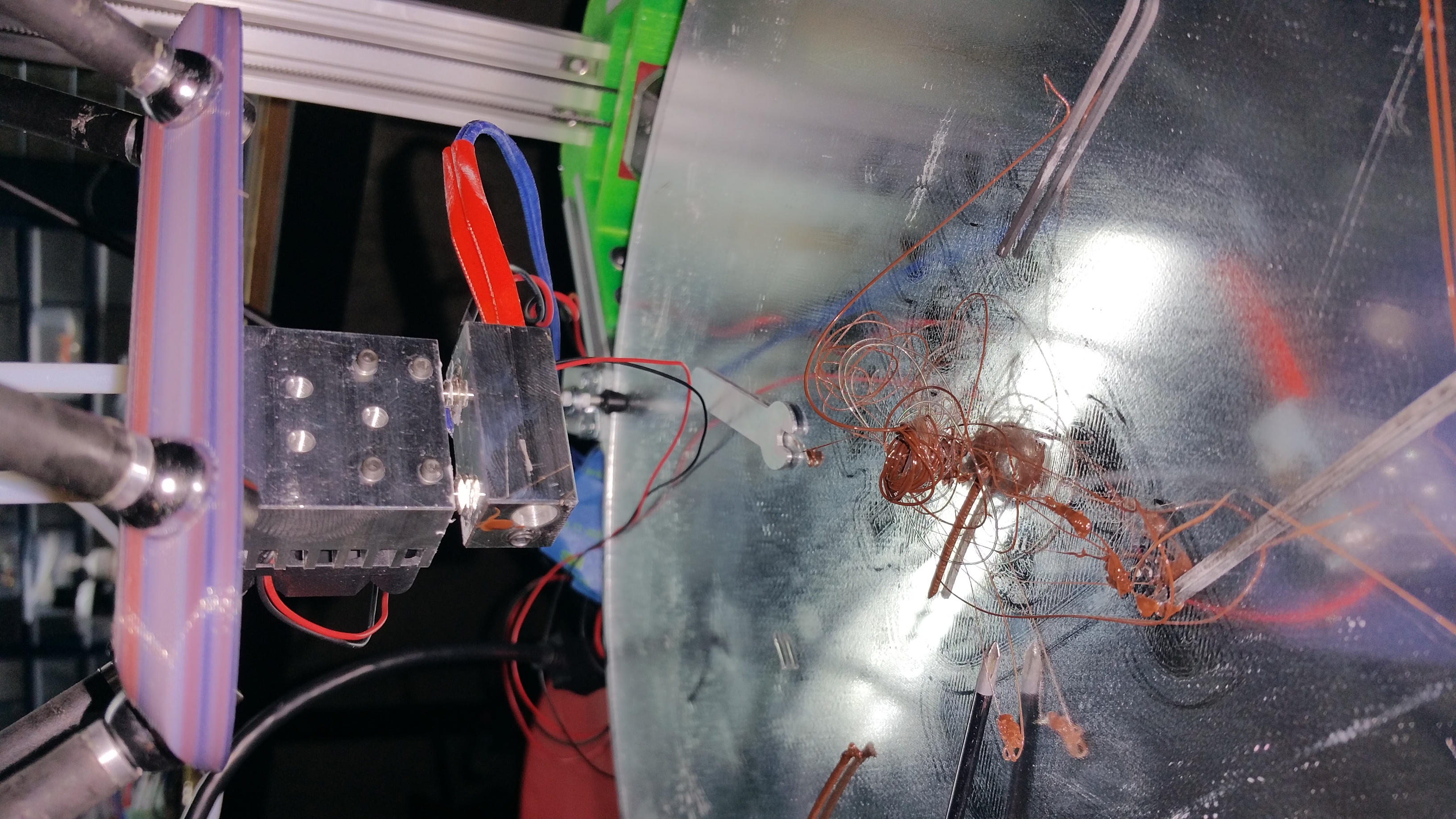

Ive done some upgrades with the carriages, arms, and effector. I have reversed the traxxas balls onto the arms, and placed the magnets inside the carriage and effector plates.
here is my setup:
[img]https://lh4.googleusercontent.com/-C11J ... 002610.jpg[/img]
doing some .1mm layers:
[img]https://lh4.googleusercontent.com/-yVV3 ... 002644.jpg[/img]
[img]https://lh6.googleusercontent.com/-9i4H ... 002642.jpg[/img]
[img]https://lh5.googleusercontent.com/-F_87 ... 002639.jpg[/img]
printing at 3600.0 mm/min x 1.5 feedrate increase:

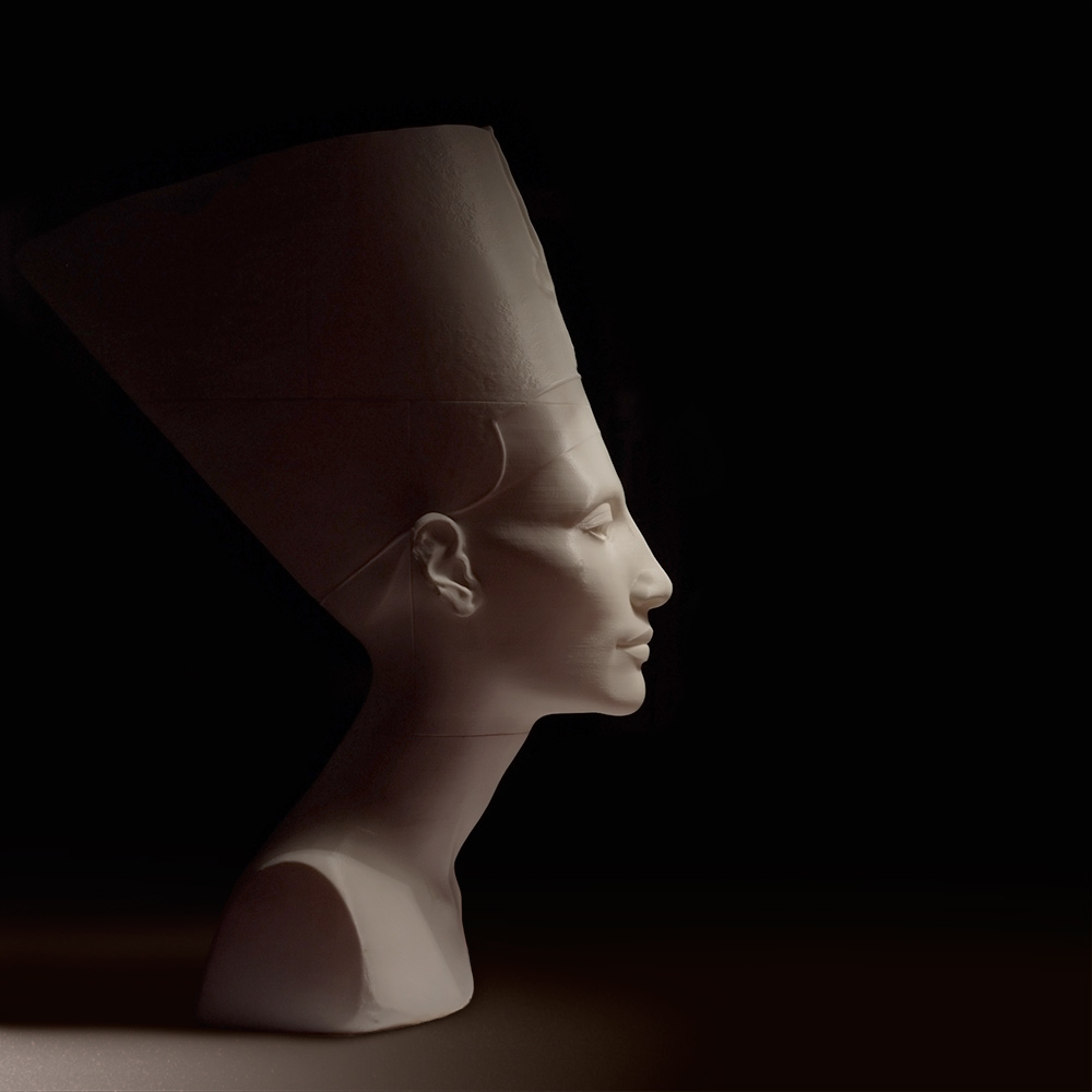

Hi Bubba.
Is there any possibility to get this big printer from you, or some shemes / plans to rebuilt it myself, I would pay for them.
Would be perfect to have this machine for my lifesized busts and sculptures.
Really dont want to hook up this thread with my pics, so this is just an example for the size which I`m printing :
[img]http://forum.seemecnc.com/download/file ... &mode=view[/img]
As you can see, even with the Rostock I have to print the bust in parts :(
Your machine could finish this mess for all times !

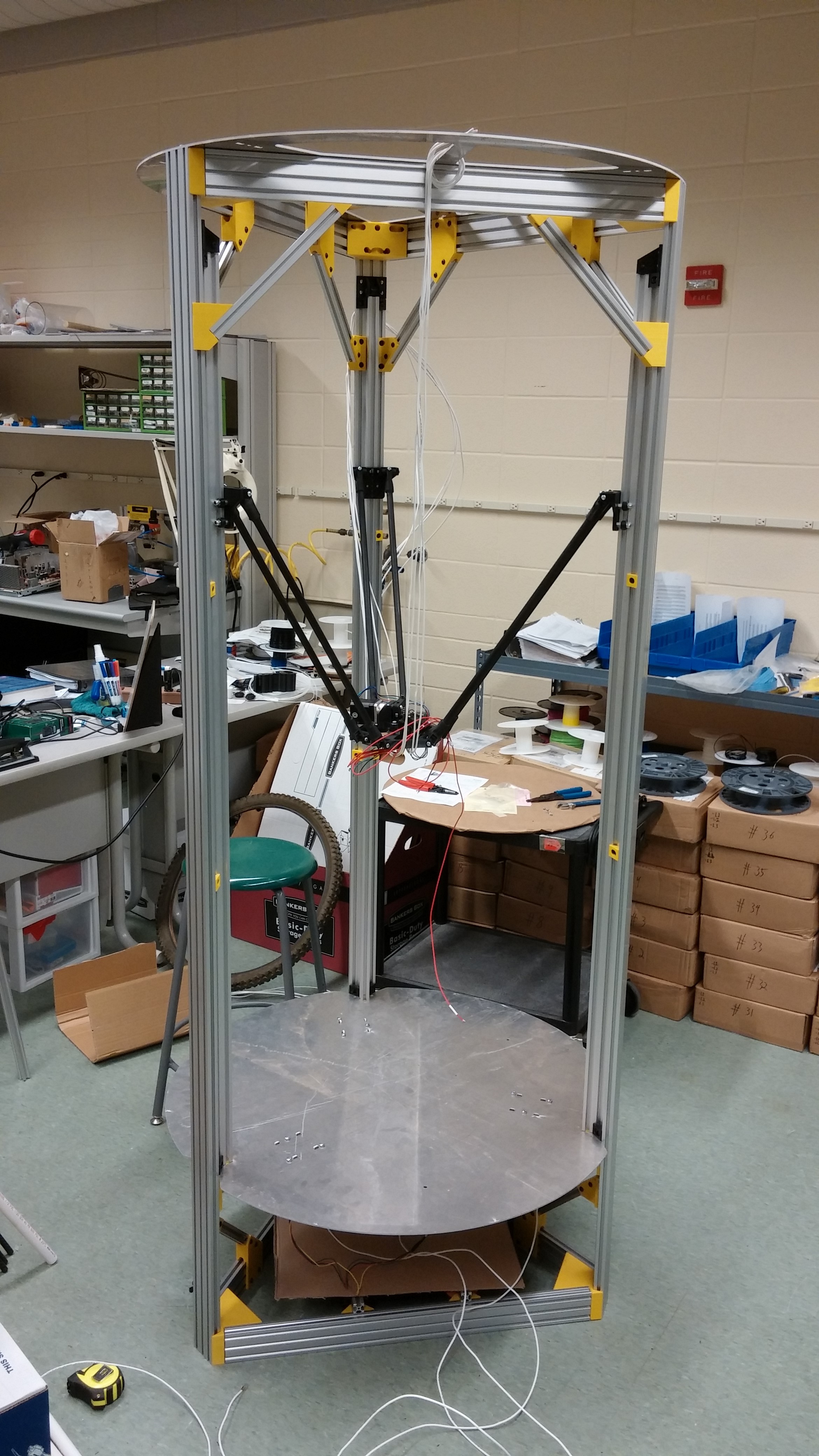

Your Order Contains:
3 x Smooth Idler Pulley Kit
6 x V-Slot 20 x 20mm
(Length: 1000mm)
3 x V-Slot 20 x 40mm
(Length: 1500mm)
3 x GT2 (2mm) Aluminum Timing Pulley - 20
32 x GT2 (2mm) Timing Belt
3 x Micro Limit Switch
12 x OpenBuilds Solid V Wheel Kit
this is my order from http://openbuildspartstore.com/
using those extrusion dimensions i just made some 120deg mounts for the cross members. being sure to account for mounting the nema17s and idle bearings at the top.
i grabbed some nema17x4 and a bbb+bebopr for the electronics
carbon fiber arrow shafts with aluminum tip inserts, traxxas ball ends, and n52 magnets
the bed is mic-6 alum, 16 3/4 inch diameter from ebay with a 16in mirror from local hobby shop.
