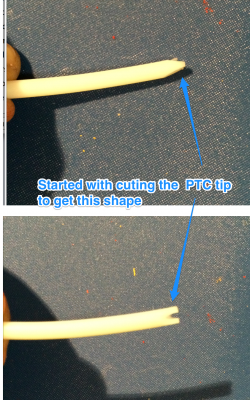

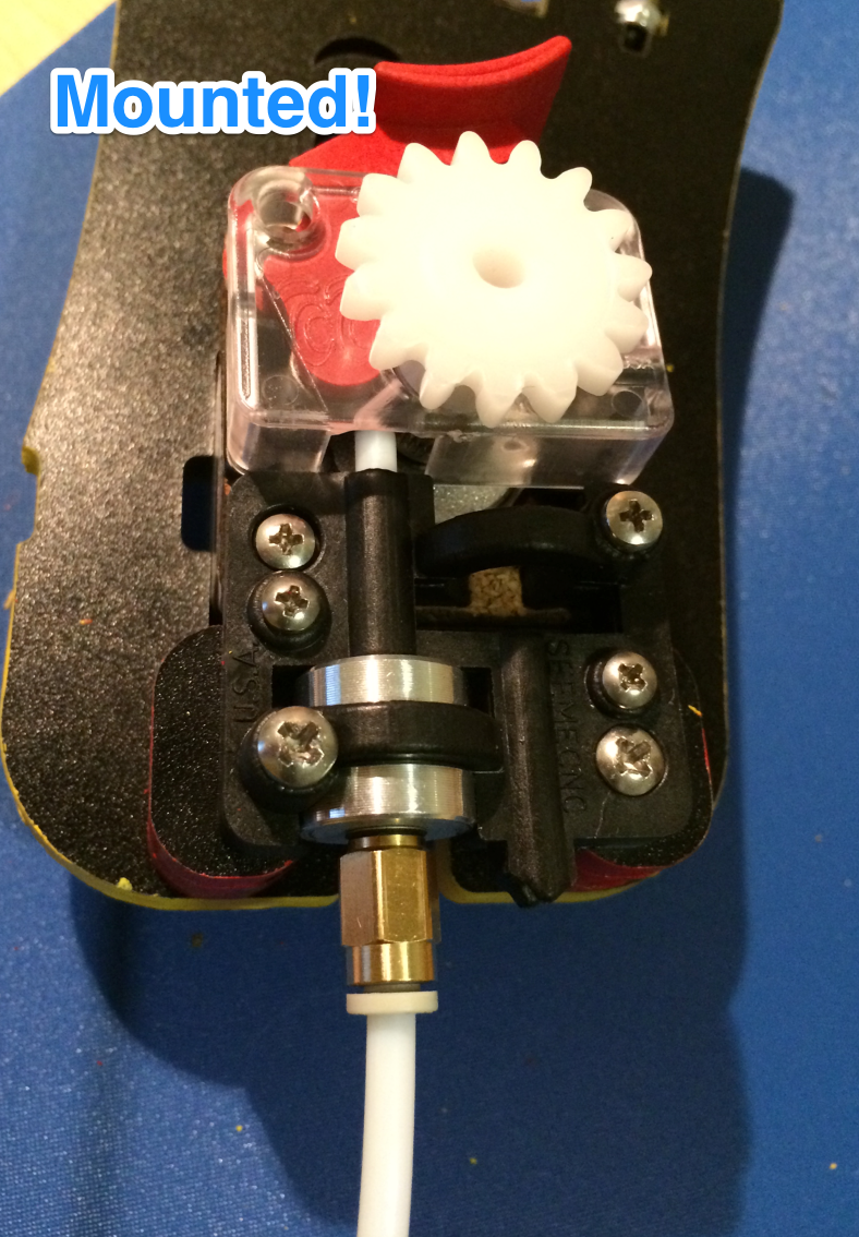

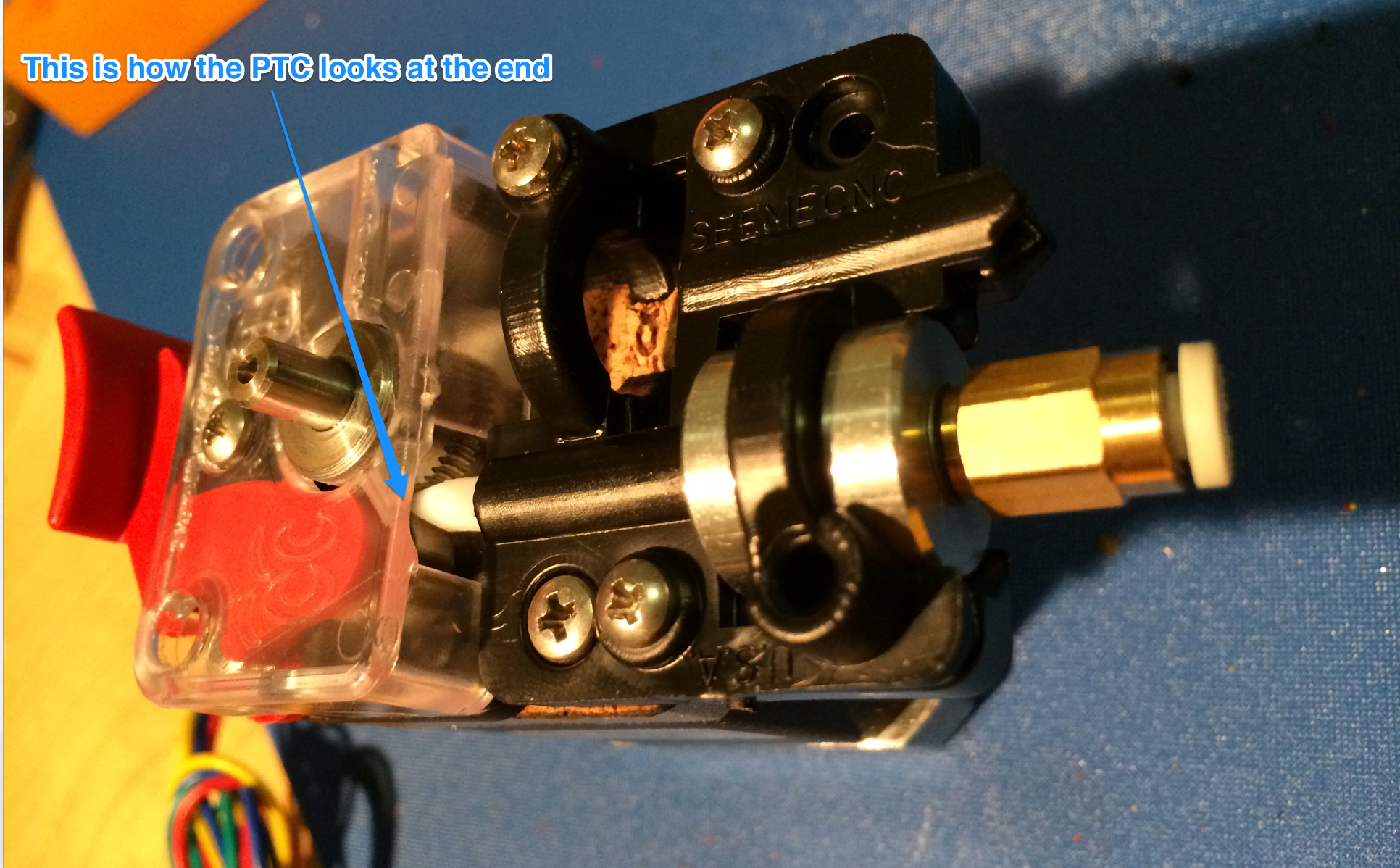

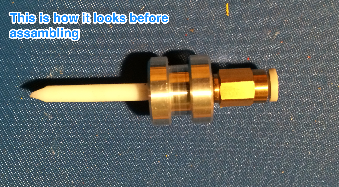

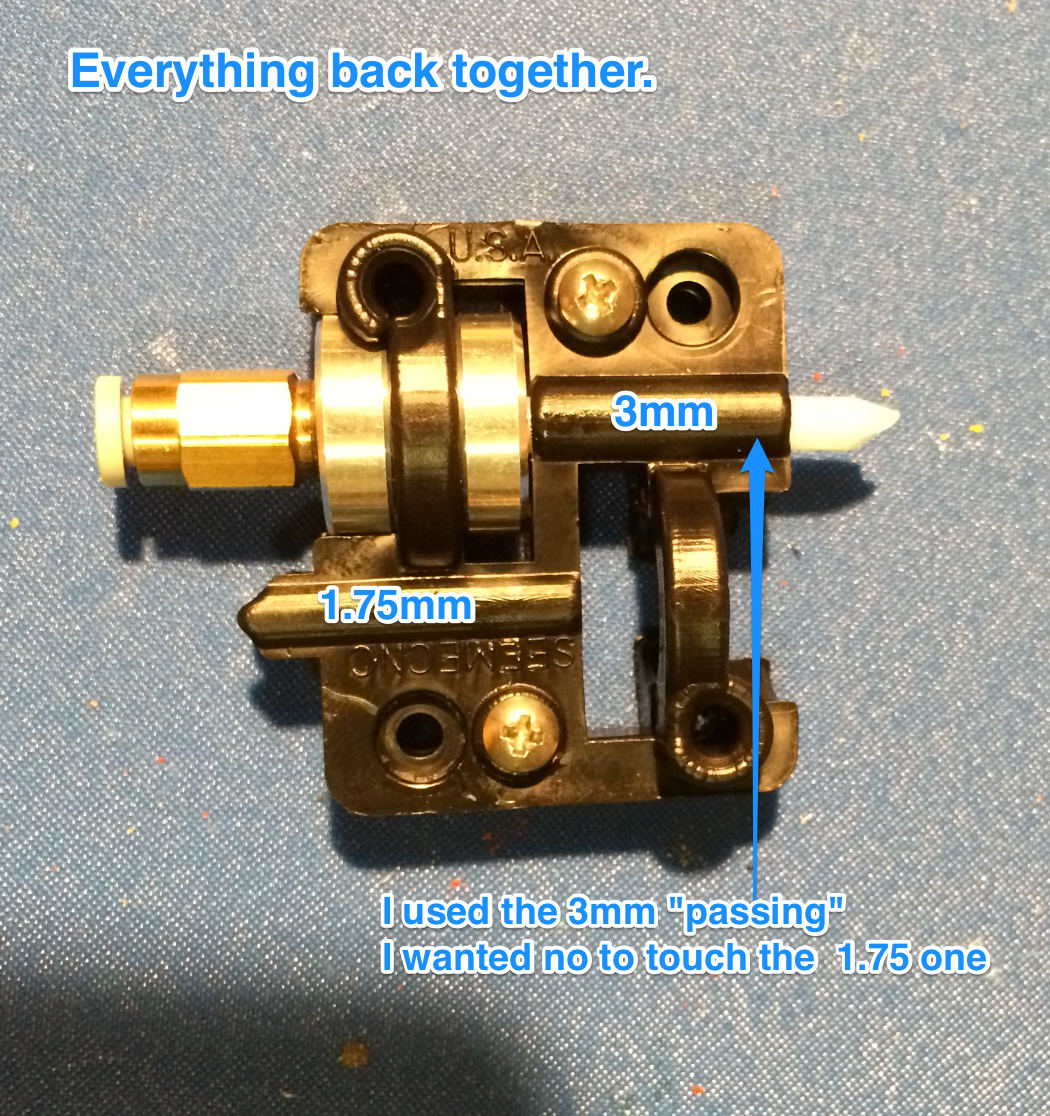

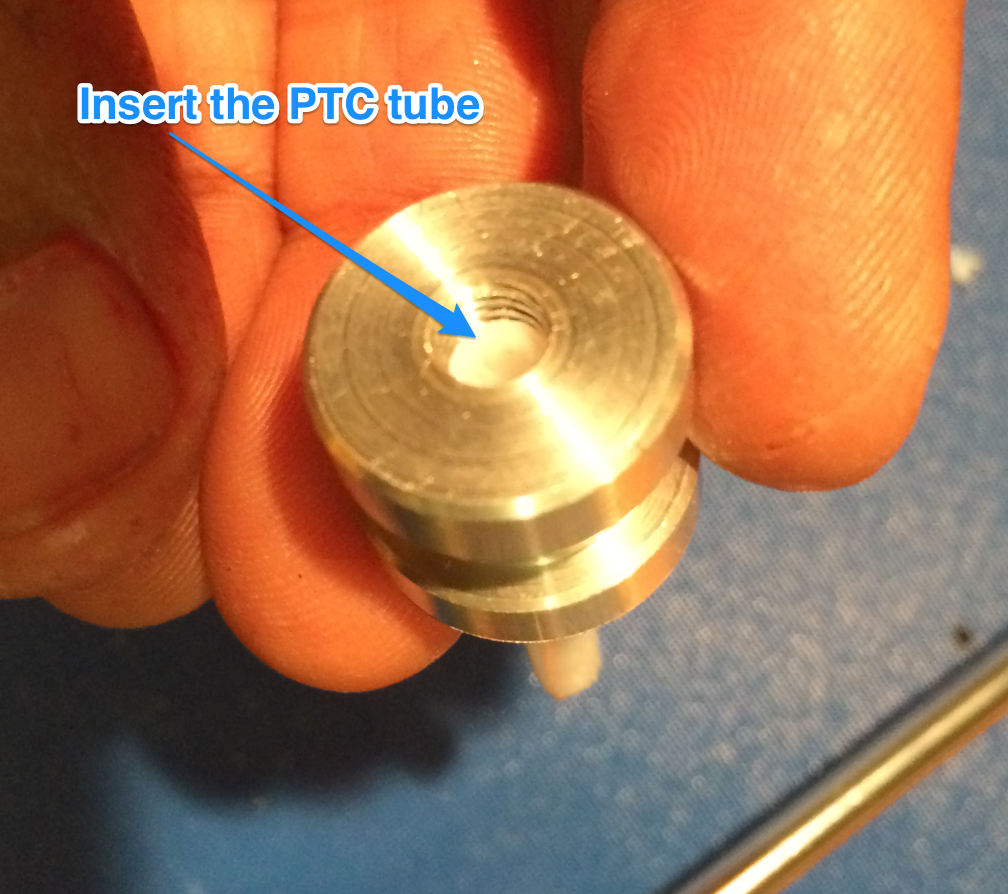

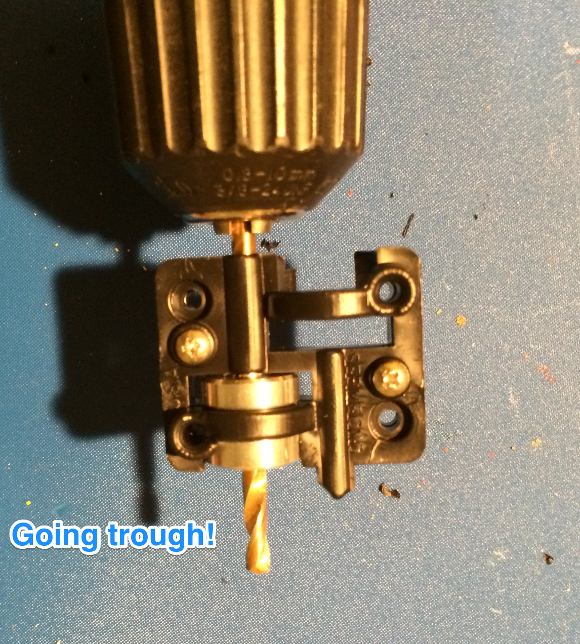

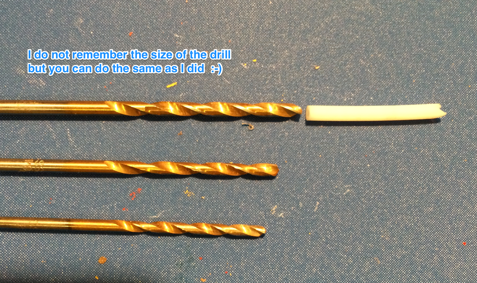

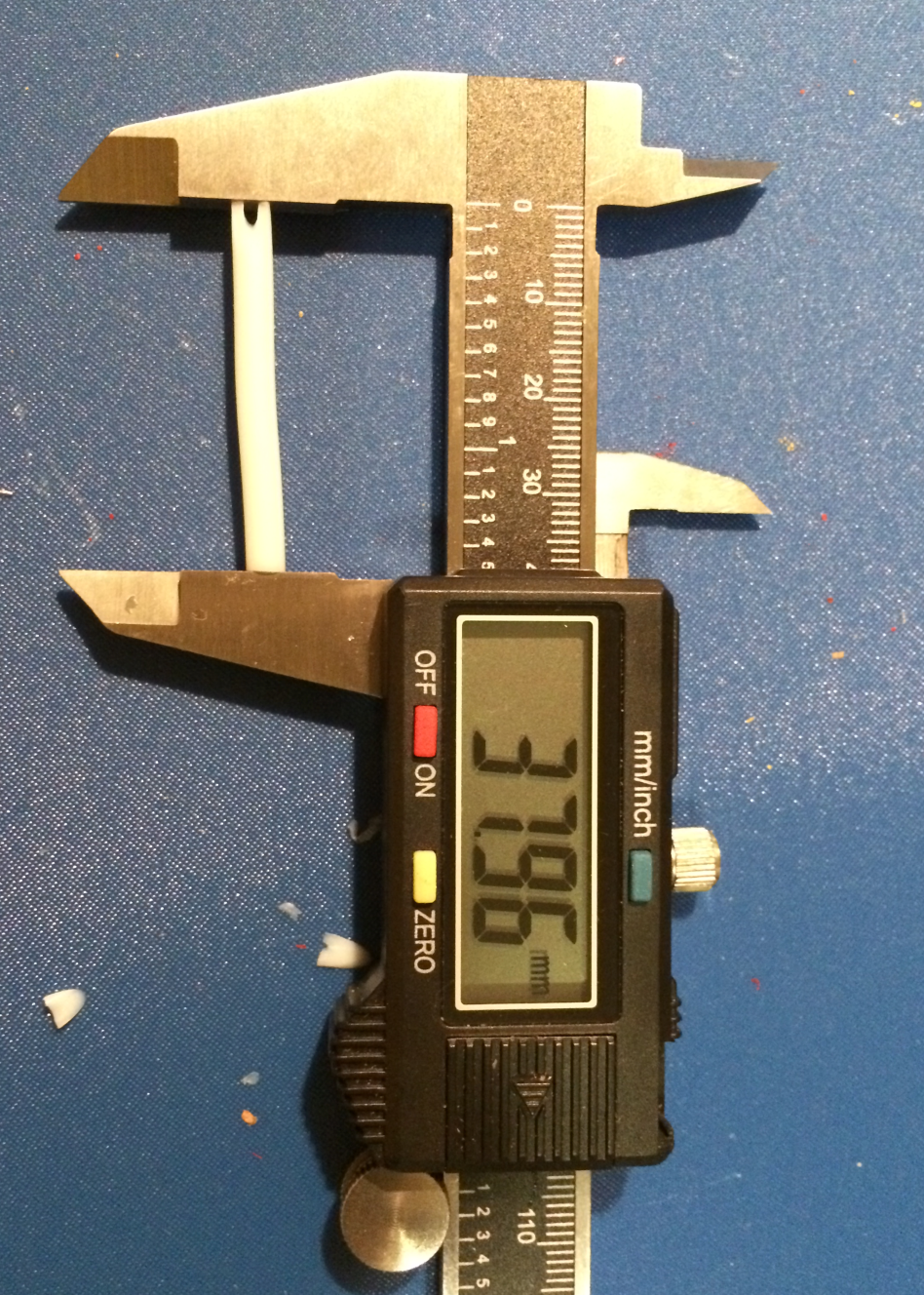

Here are the pictures, I hope it helps better (click on the pictures to see the comments, for some reason they look very tinny in some of the pictures).Moeparker wrote:artexmg wrote:Well, as I mentioned in a previous post, I had being troubled switching filaments using E3D V6, as, for some reason, the filament bulges more than with V5. Then it is very difficult (if not impossible) to make it goes trough the little hole in the EZ-Extruder.
You can see that I got something similar to what Jesse got.
So, I decided to bore the EZ-Extruder (I remember mhackney mentioned this in other post) to make allow the bowden tube go through all the way up to the hobbed drive roller. See the pics
So far, it is working great
Cheers.
How do you keep the bowden tube in the bored out EZ without the PTC piece that holds it up there? Do you use a pass through PTC fitting to keep it in the EZ?
